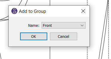

When selecting objects for a group and after hitting enter a window opens with the list of possible groups. The sorting is by creation order (at least it seems to me).
Would it be possible to have the same order as in the groupmanager window?

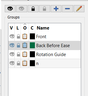

Correct. The list of groups in the group tool dialog is based on parsing the < groups > elements in order they appear in the xml. Technically in terms of the combobox they are not sorted. We could turn on the sorting to sort acending or decending by item->text.
Not easily. The Group manager items can be dynamically sorted by visibilty, locked, has objects. color, or name. Again the tool dialog is parsing the xml by creation order to get the list, and not by the order in the Group manager list. The Group tool dialog has no pointer argument to the Group Manager class, and the Group Manager class has no getter for the QTable.

I found this thread when I was about to post in the user suggestions category… I want the dropdown to always show the last group created/or used or something so it doesn’t always just show the front. Sometimes I accidentally press enter and destroy everything.Is there a way to re arrange the groups in the group manager? Cause I want to move whichever one to the top and have it immediately there for me in the dropdown whenever I’m working on it

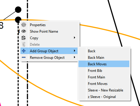

There’s another way to add items to a group… select the item and use the context menu:
Using the Group tool is better used when you add multiple objects by rubber banding the group and presssing Enter.

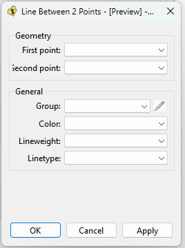

That being said… Once I get some other features out of the way I’m going to update the tool dialogs so you can assign a group when you create the tool:
