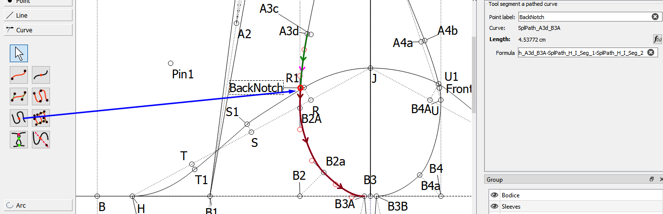

I don’t think the intersection of 2 curved paths would be the tool to use to only add a point to only one curve. There are other options available that will do this for you. In the example below, I used the Segment a Curved Path tool to place the BackNotch at the same height on the back armhole as it is on the sleeve cap by using the formula of the lengths of curve sections in the sleeve cap:
There is also the option to use the Point Intersect Curve and Axis tool which will place a notch where a line would meet the curve at a certain angle from another node. And there are other options depending on the type of curve or arc.
I’m not too sure what it is that you wish to do, but I’d suggest testing these options until you find the one that works for you, or to describe what it is that you want to do so that someone on here can help you.
