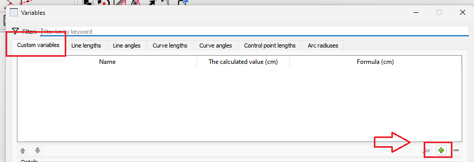

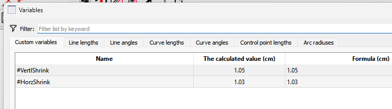

Shrinkage is a property of the pattern, and as such should be included as a “Custom Variable” that stays wih the pattern file. Custom Variables can be added in the Variabes Table:
Here I added VertShrink and HorzShrink and express them as 1.05 and 1.03

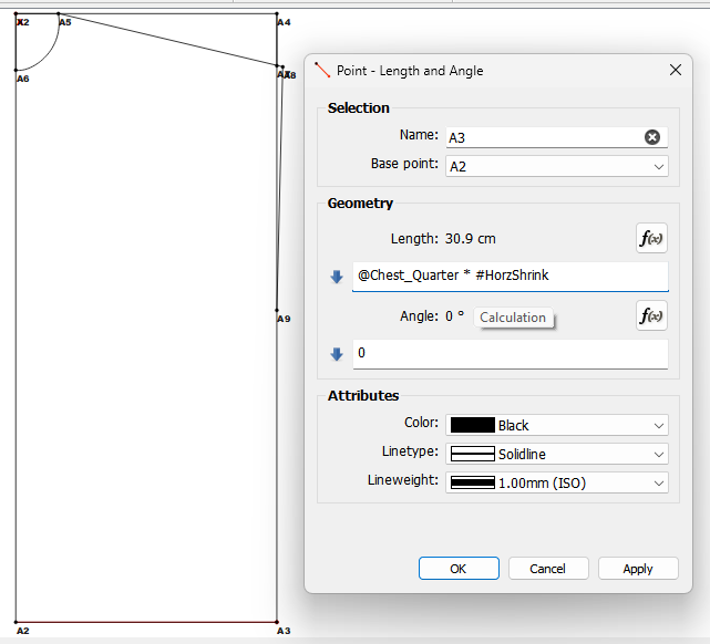

Now you can use them in formulas… such as using it to allow for 3% horizontal “shrink” of the width of Line_A2_A3:
So now the length of @Chest_Quarter will be 3% longer to allow for shrinkage. You could then load a different person’s measurments into the pattern and @Chest_Quarter will change, but #HorzShrink remains the same where the line resizes to the new person’s @Chest_Quarter plus 3% for shrinkage.

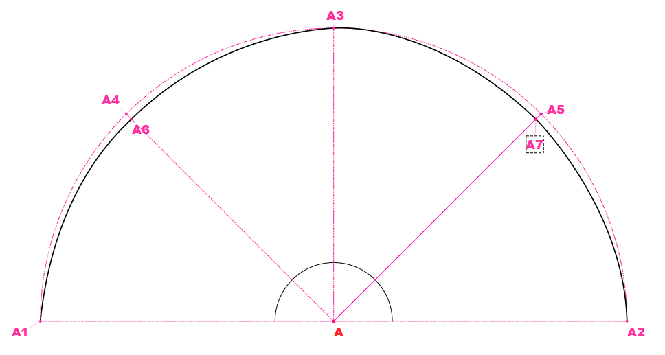

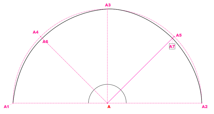

Cutting on the bias is a different story. where for example you might take into account how much a fabric stretches on the bias when cutting a circle skirt. With some fabrics if you just cut a circle the hem is going to end up wavy . So I use to do 1 of 2 things… flatten the curve on the bias when cutting - something like:
The distance from A4 to A6 and A5 TO A7 takes into account how much the fabric will stertch onthe bias.

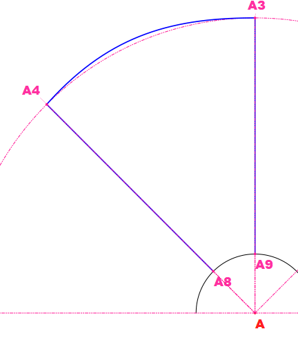

Or maybe you do the opposite for a gored skirt, where the seams are on a bias… Blue line:
OR make the skirt, put it on a dress form and let it hang overnight - then trim the hem level. It’s why orginal “poodle skirts” were made of felt, as it has no bias.

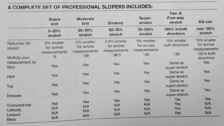

All I could find in my books is this bit:
Perhaps it will help you. I don’t have much experience with stretch fabric, but from what I see here, if the stretch is under 25%, then no reduction is necessary.

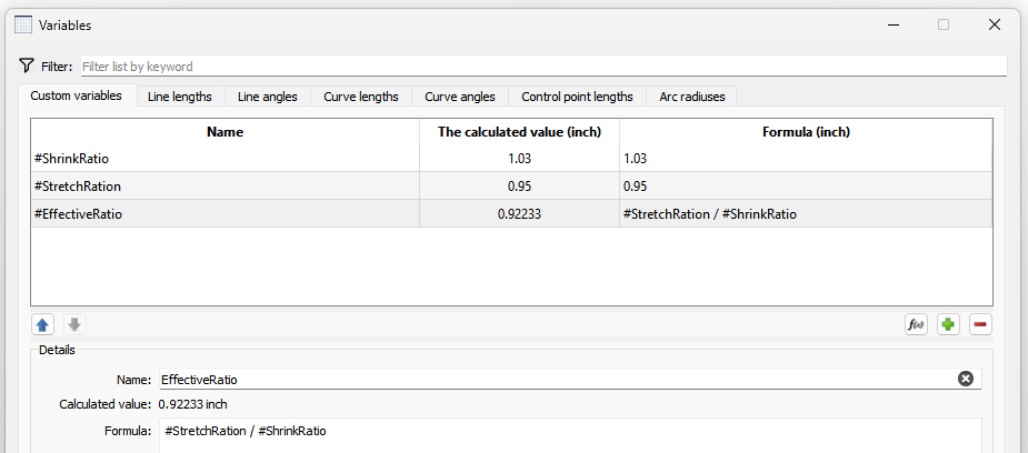

So do you mean;
We write a formula like that
Let’s say;
•	Stretch = 0.95 (5% Stretch Ratio)
•	Shrink = 1.03 (3% Shrink Ratio)
EffectiveStretch = 0.95 / 1.03 ≈ 0.922
Am I right?

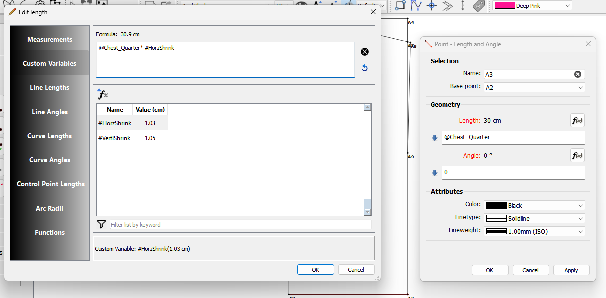

Yes… except in Seamly2D you would define your custom variables something like this:
and then in a tool formula for length you could use something like:
bust_circ * #EffectiveRatio
Now when you want to create a new pattern layout, you can change the measurements (maybe changing bust_circ) and/or one or both #ShrinkRatio, #StretchRatio… and the pattern will resize to the new measurements and custom variable values. In other words you can adapt a single pattern to a person’s measurements and/or the fabric being used… without changing ALL the tool formulas.
