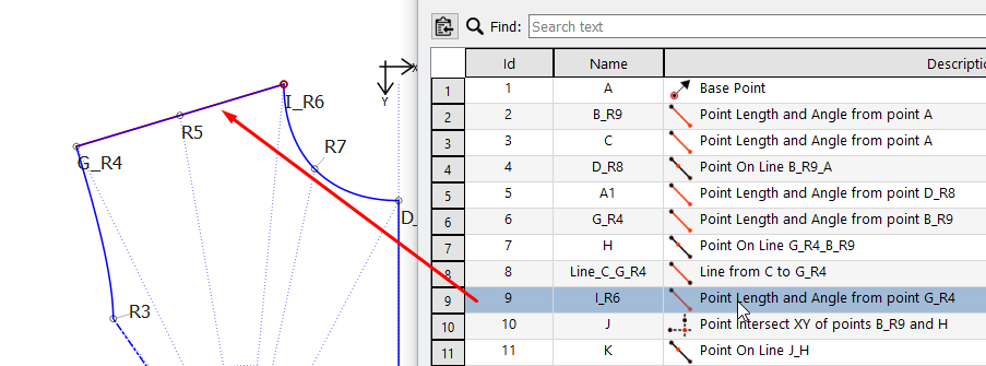

Yes, it would be nice if all the editing could be done in the History, however… baby steps… already, if you click a line in the History, it shows the object in the draft, for example:
This makes it very easy to find an item, in a very busy pattern, so that you can quickly find it and fix it, if you have something not working as you want it to. And the Search at the top can quickly highlight all the instances where a certain reference has been used.
