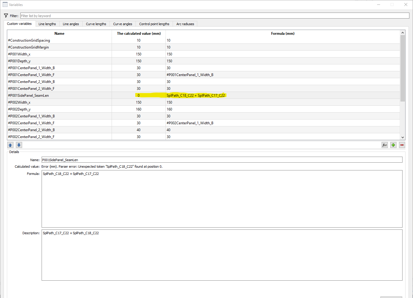

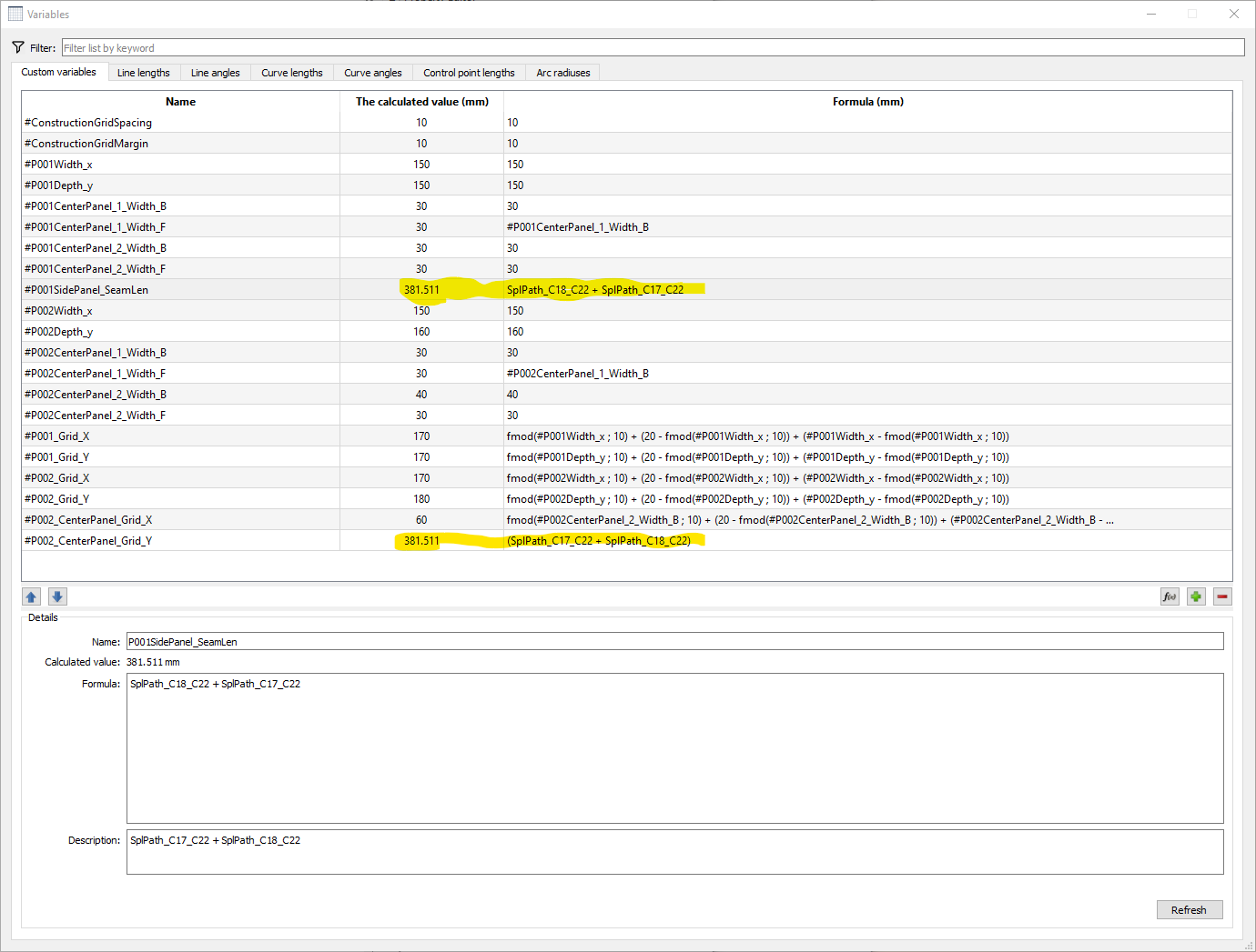

I show here two three screenshots of the Var-Table and have underlined (Highlighted / Highlit ?) a local variable that I created to hold a value of the length of Splines.
I filled the ‘Value’ with a formula (SplPath_C17_C22 + SplPath_C18_C22) which was available on the ‘Curve Lengths’ tab of the table, and the value was filled accordingly.
20250207094046_Seamly_VAR-Table
However, after closing and opening the table, the value (formula) was flagged as an error.

PS: With reference to the third screenshot; the value field can be restored by altering a different variable, which then seems to reinitialize the field. Since I cannot imagine these (SplPath) values going in and out of scope, why are they accessible then Not?

Ok, the passive-aggressive opening tack is not endearing, so I’ll try to move past it before responding. We’ll start with a question. Did you manually enter “SplPath_C17_C22” or did you find it in the Formula Wizard? Only if you found it in the Formula Wizard, is it “clearly In-Scope;” since Douglas fixed that little oversight. Do not manually enter formulae, only enter them with the Formula Wizard, until such time as the following paragraph has been fully understood.
Every time the pattern updates, Seamly has to re-render the file. It reads off the directions for rendering in this order: Measurement file, Custom Variables, Block A in order of creation, Block B in order of creation, Block C in order of creation, etc… Any formula created out of order cannot be used in drafting.
When you open the variables table, Seamly re-renders the pattern while searching for the items to populate it with. The current state of the pattern is held in memory. Since the entire pattern is loaded at this point, it is possible to manually enter formulae referencing any part of the pattern, but the moment Seamly has to re-render, Seamly finds a formula referencing something which does not exist yet.
tl/dr: If it isn’t in the Formula Wizard it doesn’t exist. It’s just an illusion. Do not try to operate without using the Formula Wizard until you are able to accept this.

Once again… To add to what @Pneumarian said…
The items in the red box are only lists that are similar to the History on the menu. Their purpose is only for checking things… Information:

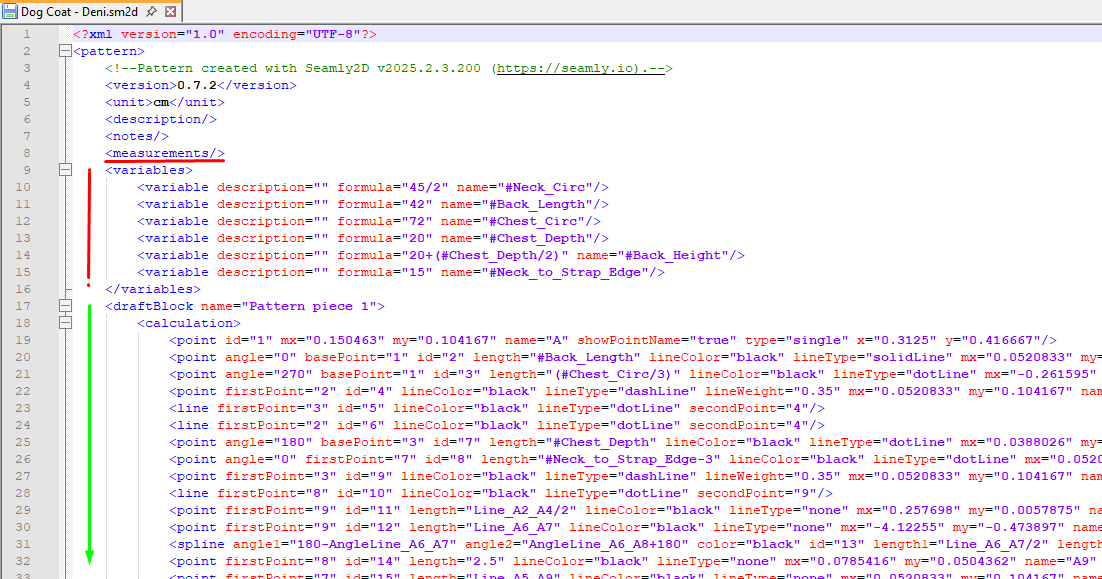

If you open the pattern in a text editor, you’ll see something similar to this:
As you can see, the measurement file is normally loaded first, then the variables and then the draft block.
In the draftblock section, there are the following sections - Calculation, Modeling, Pieces, Groups and Image (this is an old pattern since long before Images, so it doesn’t feature here):
I hope that this draws an understandable picture as to how things are arranged in the pattern file and why you can’t use anything in the draftBlock sections in the Variables Table. And why this will never change.
The tool variables ARE downstream… as I pointed out previously in another topic. In this case they’re only in scope when the variables table is opened and go out of scope when closed and the pattern gets reparsed. And there’s no way to stop users from cutting and pasting invalid variables into formulas.
As @Pneumarian pointed out… if you use the fx editor when editing a formula for a custom variable, the only things you can access are measurements, custom variables created before (above), or functions. You can not use line lengths, line angles, etc in custom variable formulas.
It’s all based on the strict linear parsing of a pattern. Don’t worry about scope… just don’t cut and paste into formulas, and just use the fx editor, and you’ll be fine.
I think I can further fix this issue by excluding tool variables (line length, line angles, etc) in custom variable formulas… so it would throw an error right away when it tries to evaluate the formula. I’m already tracking a bit flag as to what dialog opened the fx editor, and can probably use the same for the EvalFormula() routine to filter out any tool variables from custom variable formulas.
That would then only leave figuring out how to validate using only existing custom variables in the formulas to eliminate this issue entirely.

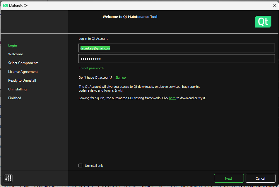

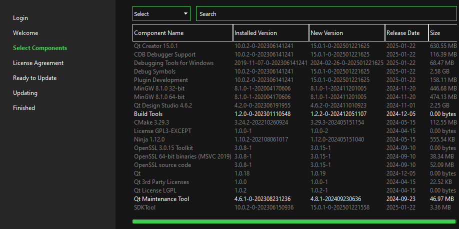

Yes. Same deal with Qt… there is a free community ver. It does require a Qt account, as downloading / updating the framework works through the Qt Maintenace Tool. BTW… unless you want to build Qt itself, you don’t need all the source code which takes a lot longer to download.

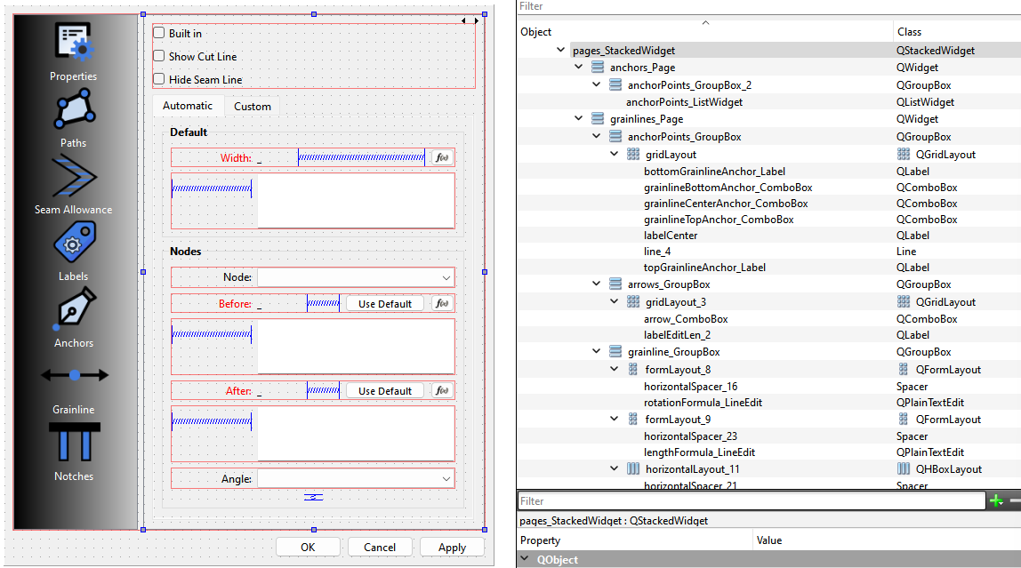

Each red box represents a layout. You could make all the forms in the code, but that would be insanly nuts. That’s not all though… every form is usually associated with a cpp code file that interacts with the form.

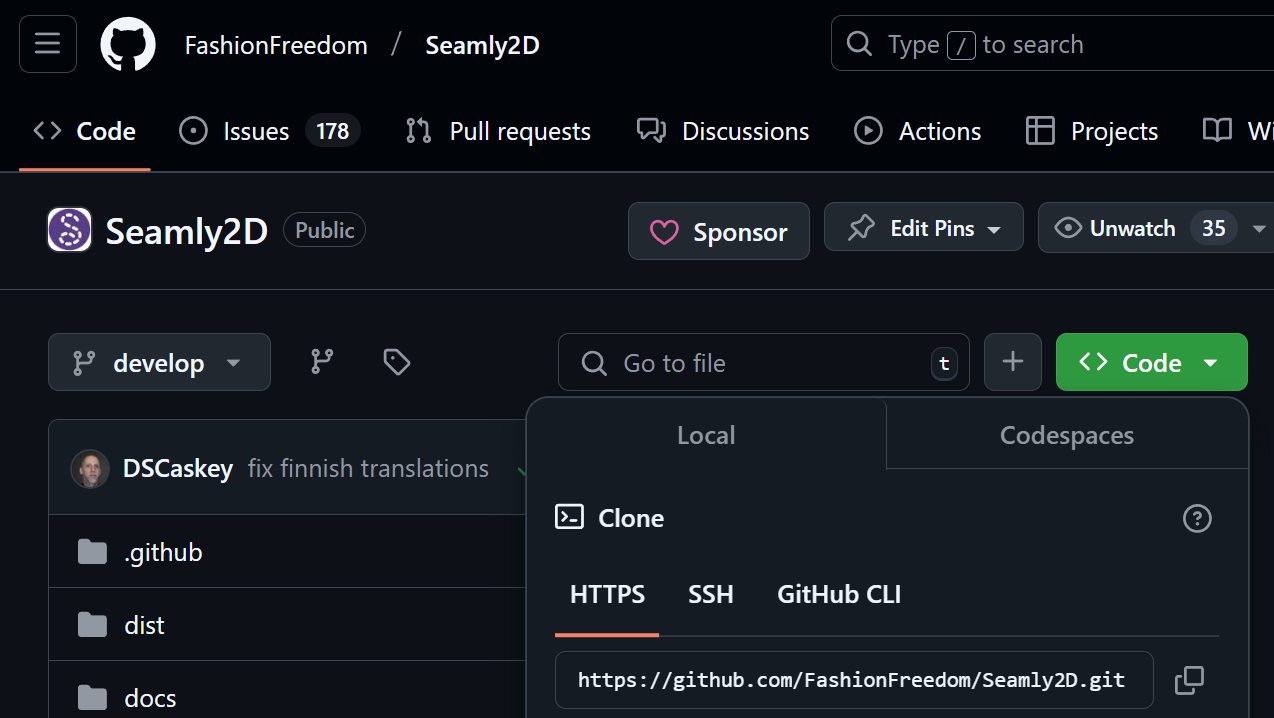

If you have not already done so you first need a Github account, and Git client - Github desktop is recomended to start. You then need to “clone” the Seamly repo… click the green Code button.
This will download the repo to your computer as your “local”. You will also need to create a fork to actually contribute to the project.
The idea here (for now as you can’t write to the main repo) is you will work between your fork and your local… and between the Main (origin) repo and your fork. For now though you need to be able to get Qt up and running to build locally.

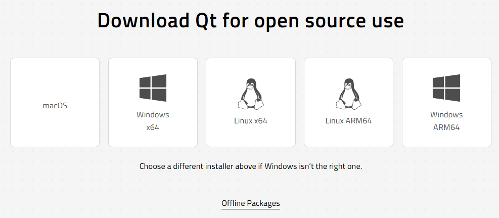

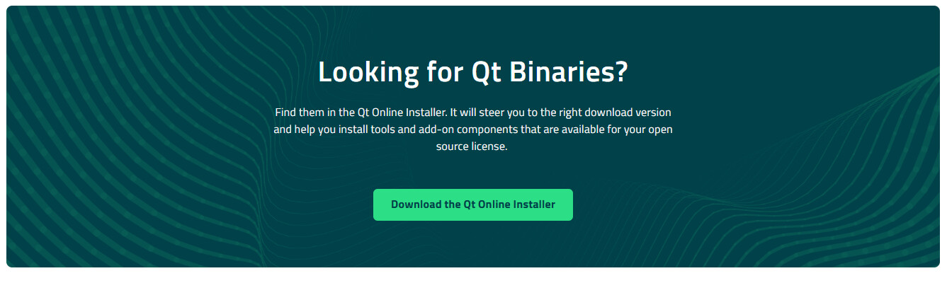

Qt Download:
This should give you the insaller for the Maintence tool after creating am account, which you will then use to select Qt components to download. I can’t show the Add components without updating the “white” ones first - which I don’t want to do at this time… but this is pretty much the minimal list of Qt 15.5.2 components… althikugh you could knock off a good chunk by not including the debugger components. As you can see it’s like 6-7 GB.
