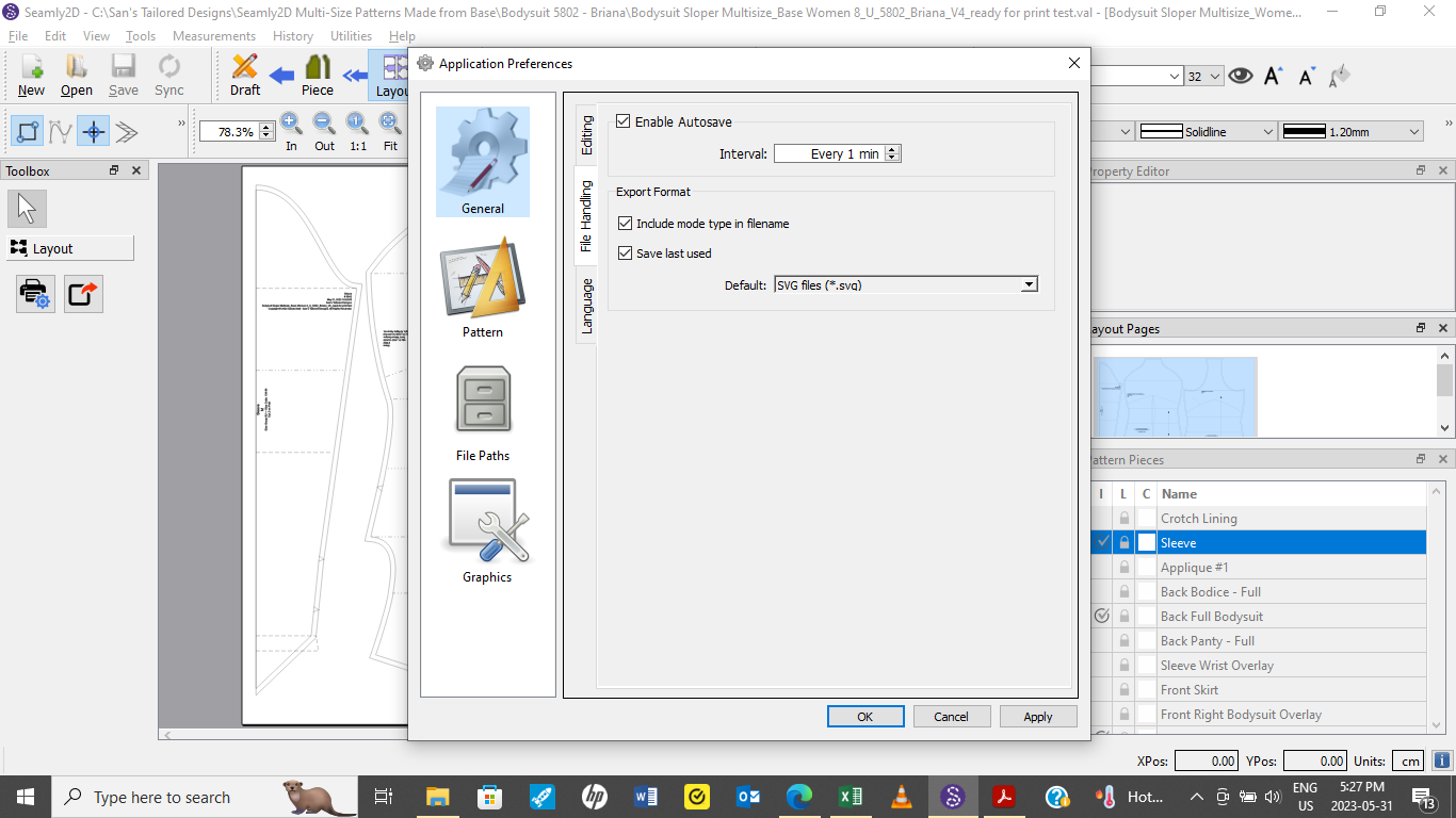

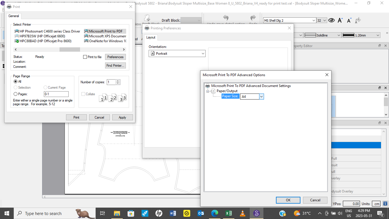

Hi there, I was trying to find where I can change the printer default from A4 to Letter in application preferences so that I don’t have to change the preferences for every individual printed tile PDF under advanced (see attached).
Would someone please be able to point me in the right direction, or does this option not exist currently?
Thank you, Sandra

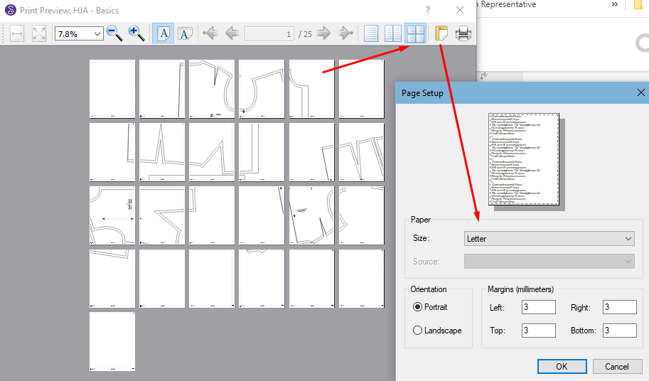

Hi @SandraB
I normally view the pdf pages in tiles and change the settings there, if I’m creating the PDF directly from the program. But then you need to create the Layout and go to File > Preview > Preview Tiled:
I haven’t really explored the PDF option from Piece mode yet.

That is another view of the same thing. I like the view. I am choosing the PDF option, bc for me, the printer accepts draft/ grayscale from printing from a PDF, but not using the printer settings within Seamly for some reason. I was hoping that I could change the default under application preferences…but I don’t see any printer related settings. Somehow the program is defaulting to A4, but we don’t use A4 in Canada.

The page size should be determined by the selected printer, not the application. Not sure if the app is incorrectly overriding this ot not? Currently I have no printers connected so i can’t check what’s it’s doing. When I get a chance I’ll try and take a look again at the print options.

Hi Douglas, thank you for the reminder to check my printer default settings in Windows. I did that and it is “Letter”, then I checked Seamly and it was still A4.
But, when you told me about the export, I selected “Export As” from the layout panel and changed A4 to Letter. Then I tried the preview tiled to PDF and the print tiled to PDF. Guess what? Both now say “Letter”. Closing Seamly and re-trying still shows “Letter” as the default.
Now how about that?
So, I have Seamly defaulting to “Letter”, not “A4” as I wanted. Yeah!
Thanks!
Sandra

Well, as I suspected the app is erroneously overriding the printer settings when “printing” using the last used tiled pdf “export” app setting. Not my doing. Keep in mind the export setting is for creating a file, not sending to the printer. Theoretically you should be able to use “legal” size paper in your printer, export a pattern as a tiled pdf, then using the system outside the app - print the tiled pdf file without any scaling - resulting in extra white space. On the other hand if the printer was set to 5x7, and you tried to print the same file - you will have issues. In other words the export setting should only affect what size the “tiles” of the pdf are - not what size of paper is in your printer.
What should happen is if you select Print → tiled pdf, the tile size should be what the default printer is set at, NOT what the export as page size is set at. Obviously as we have found out, unless you do an ExportAs to change the initial hard coded A4, you would always have to change the page size if you only use Print As.
So… What I should do is change the Print as to use the default printer page size, and not the Export As pdf page size.
That being said… whether one uses PrintAs → tiled PDF or Export As → tiled PDF your probably going to use whatever size paper you use. Which also means if sharing PDF’s it’s probably best to just export as PDF, and let others tile print the PDF with what paper size they use.
