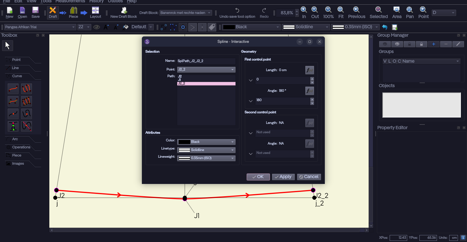

Apply button functions as OK in Spline properties
I just created a spline. I wanted to adjust the control points.
When I click Apply to see the effect of the new values on the spline, though, the button behaves as if I pressed OK, and closes the dialog. I then have to right-click the spline again to open the Properties window.
I suspect this is a bug?
OS: Arch Linux (Wayland, running with QT_QPA_PLATFORM=xcb) Seamly2D Version: 0.6.0.1

I have identified WHEN the bug was introduced and will address it as a seperate issue from my current updating of the tool dialogs. I have to better understand how a recent change is only affecting the Interactive - Spline tool, but it’s most likely related to fact the Spline tool has multiple CP’s as compared to the Curve tool that the change did not account for.
I have disccovered that the issue with the apply button… pardon the pun… applies to moe than just the Interactive - Spline tool dialog. It applies to any tool where you change a point that has dependents… such as the basepoint in the Point - length & Angle tool:
If I change the basepoint to A, and click Apply, the dialog Saves and closes. It has to do with a recent fix to the dependencies so you could delete points that no longer have dependents. For some reason fixing that issue is causing the Apply button to now close the dialog.
Just an update on the “Apply” button issue. I had to revert the recent change that was made to fix a dependency issue, but caused issues with the Apply button / application crashes.
The dependency issue is going to take a completely different fix, but here’s the fix that restores the Apply button function if you can’t wait till this weekend’s release.
