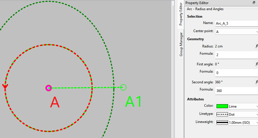

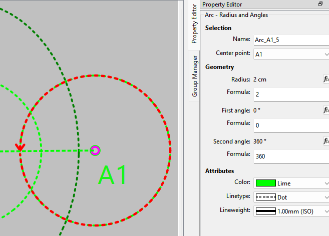

Actually, I just figured out that it was working (except for the flashing tool tip which you are fixing). The other issue (user error) is that I was starting from a blank pattern piece with only point A and zoomed in so far that I was unable to see the ellipse that was created. I figured this out because it worked the same way when I added a circle. I have added 359 degree circles on many projects and not thought about the fact that I am unable to enter the name field. Is that a “bug” or a “feature”. I have been able to select 359 degree arcs in the past and expect I will be able to select the ellipse as well. I have never been able to assign a name and that has caused no problems. I am commenting only because I am curious
For some reason that also appears to be fixed. I didn’t intentionally fix it. :thinking:
Why it’s greyed out is simple… you can’t edit arc names as they are created on the fly from the tool prefix + center point selected + the tool id number.
If you look at the file you will see - unlike points which have a name, arcs do not:
<point id="1" mx="0.132292" my="0.264583" name="A" showPointName="true" type="single" x="0.79375" y="1.05833"/>
<arc angle1="0" angle2="360" center="1" color="lime" id="2" lineWeight="1" penStyle="dotLine" radius="2" type="simple"/>
<elArc angle1="0" angle2="360" center="1" color="green" id="3" lineWeight="1" penStyle="dotLine" radius1="3" radius2="4" rotationAngle="0" type="simple"/>
If you switch the center point the name changes.

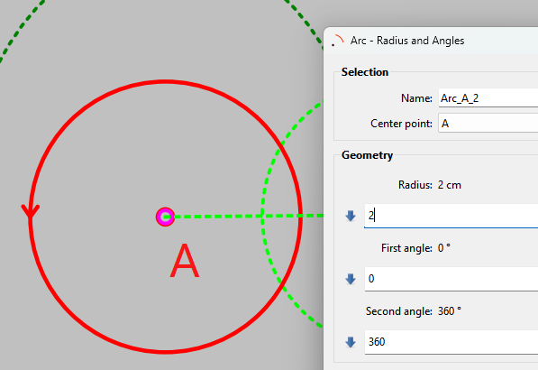

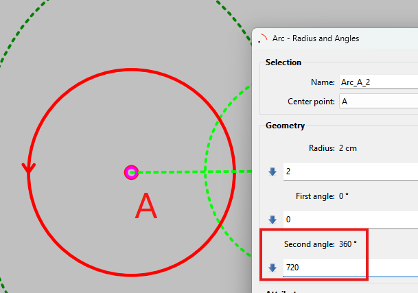

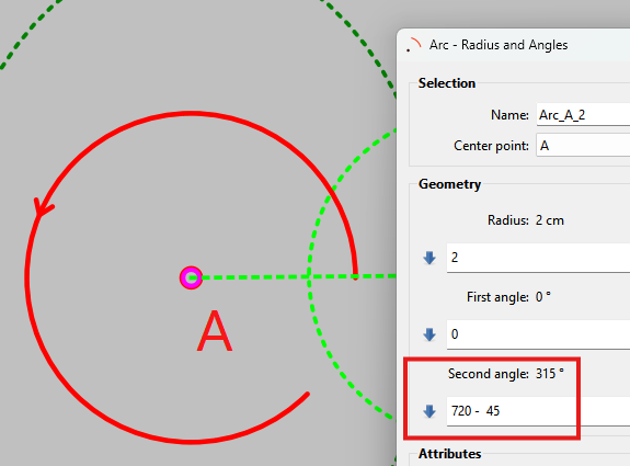

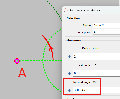

This has already been fixed… you can use 360 (or any multiple there of) again. Arcs will now correctly normalize between 0 and 360:
