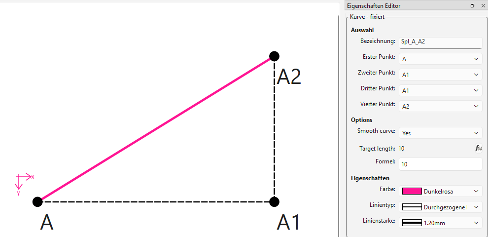

(before/after comparison — manual handles vs. auto-smooth)

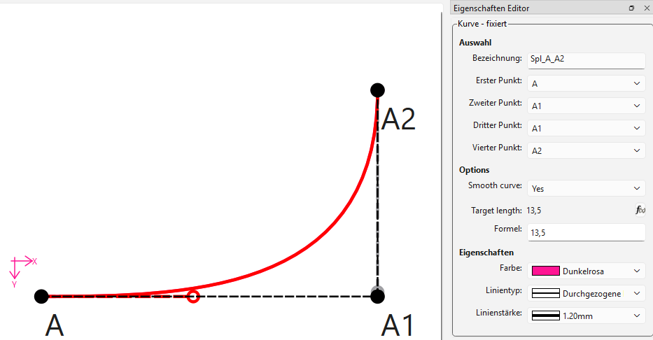

(Curve with target length field filled in)

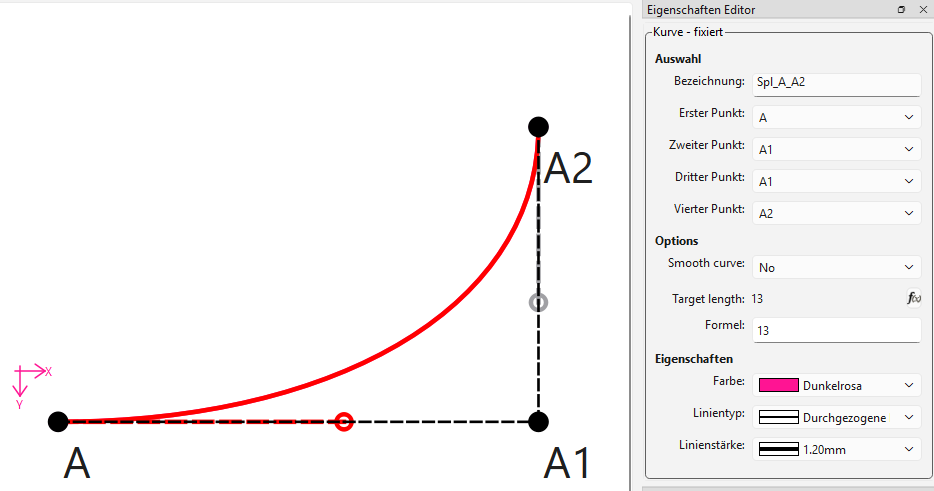

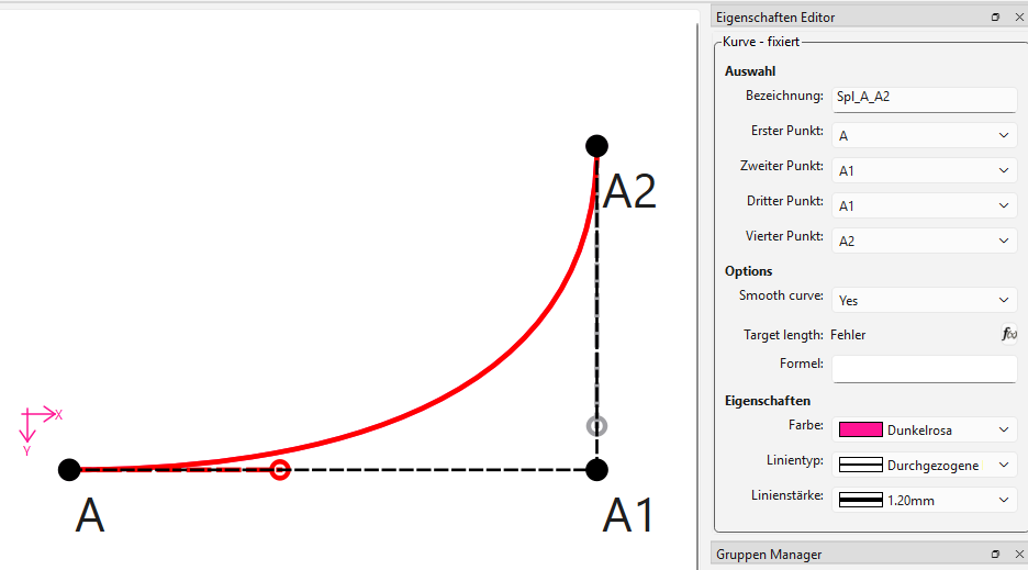

The addtipns do not show in the tool dialog:
But do in th eProperty Editor…which is surprisong as the Editor is normally a PITA to deal with.

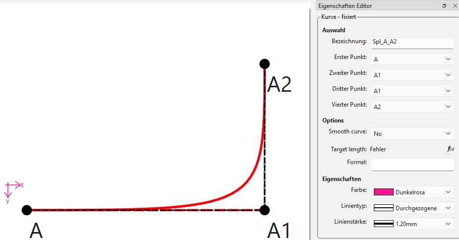

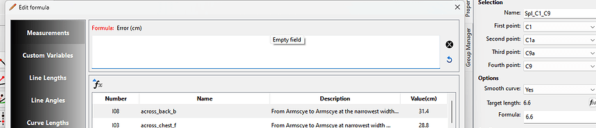

The target length formua is showing an error.

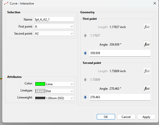

Theh curve name has disappered from the Tool Dialog:
Should be:

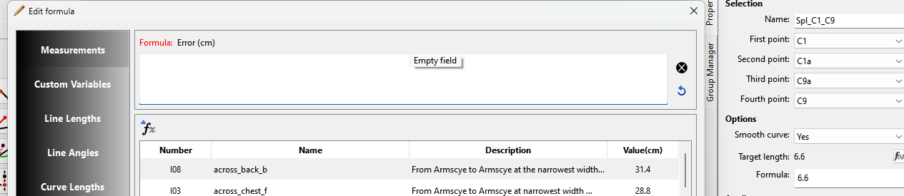

Even though there is a value in the Property Editor.. the fx Editr is emptyand displays error:
Ditto on the Curve Interactive… no options.

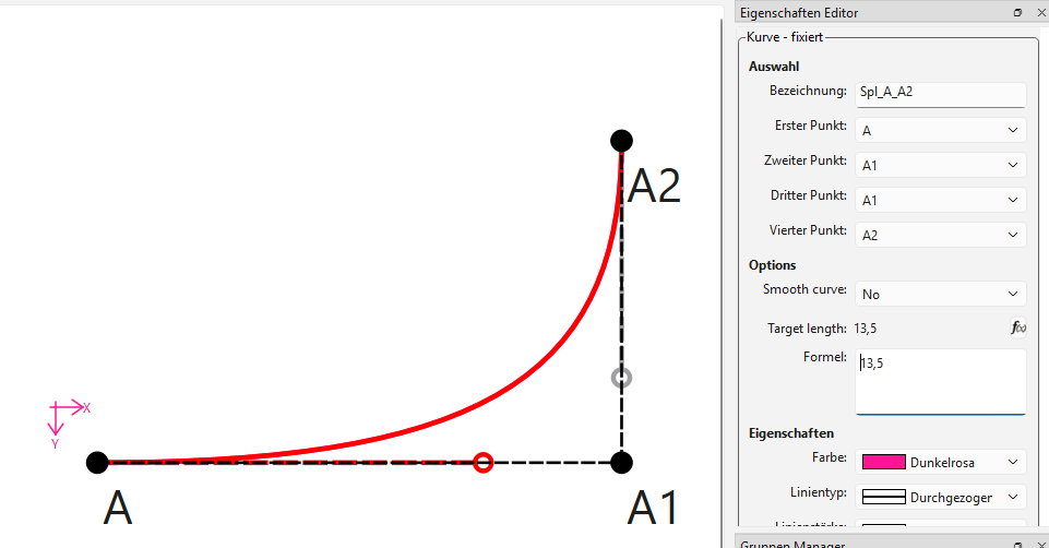

There is no “checkbox” plugin for the Property Editor, so the tools are usless without the checkbox option.

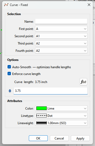

And as I thoufght, Claude has no clue how to edit the ui forms… that’s why there is no options in the dialogs:
yes that is correct. I fokused on getting it to work in the Property-Editor. -The “Target lenght“ only activates, if the Formula is filled, but empty it shows “Error“. -The checkboxes never showed up, so I switches to a yes/no drop-down. Im not sure wether or not I did that for the dialog. -For the Issue with the name- i have no Idea how that could have happened. Same for the Edit-Formula-dialog :face_with_raised_eyebrow:

Man are the UI forms wacked out. The checkboxes here are up and off the upper corner:
Right… the Property Editor does not have a Checkbox property plugin that I’m aware of. On the other hand the ui dialogs are all messed up and I can’t figure out why. They are in the ui form, but something aint right as they don’t show, and can’t be edited.

Yes and no. Ok.. I figured out why there is no target dropdown… but it’s kinda of an odd behavior to have an empty field disable an option. And the app should not show “error” if there is no error. If I was confused… average users will be really confused. I only figured it out when I read the code: Not sure what I’d do… I’d have to think about it.
  • I’d add a dropdown “Use Length”… Yes / No
  • Change “Target length” to “Curve Length:”
  • Check dropdown state instead of fx being empty.
  • Preset Length Formula to zero to avoid “error” status.
Unforunately there is no way to connect a dropdown to the length formula to disable it if “No” is selected. That’s another reason why the Property Editor SUCKS.

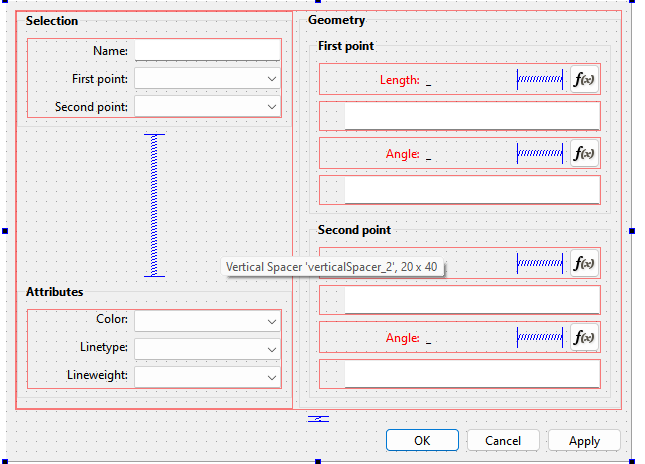

I found the issue in the dialogs… they’re not visible… because they are visible = false.
Name is still missing though… :thinking:
