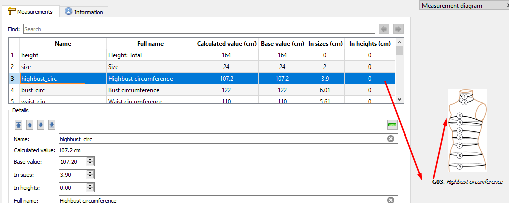

Well done, @sabbie. If you click on a code in the list, it will give you an image of the area that needs to be measured. You may need to toggle the icon to show them:
The name will be at the bottom of the diagram:
