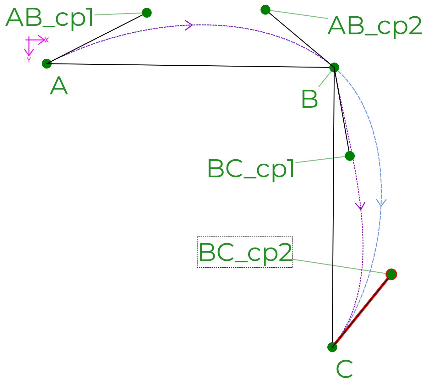

The cubic Bezier splines tool seems to use the wrong control point angle for segments beyond the first one. It seems to use the reciprocal angle of the previous control point rather than the one that is set.
Here’s a minimal example. The spline ABC (dashed, light blue) uses control points AB_cp1 and AB_cp2 for the first segment and BC_cp1 and BC_cp2 for the second segment. Based on experience with other software and in mathematics more generally, I expected the resulting curve to be identical to the union of the two single-segment cubic splines AB and BC (same control points; dotted purple). However, the second segment of the bezier spline is quite different, and the effective control point at B is not actually BC_cp1.
It turns out that the second segment is taking the length of the assigned control point (B to BC_cp1) but the effective control point angle angle is 180 plus angle(B, AB_cp2).
My question: is this the expected behavior? If I want different control point angles in my patterns, should I just use a sequence of individual cubic Bezier curves, like the purple dashed line?

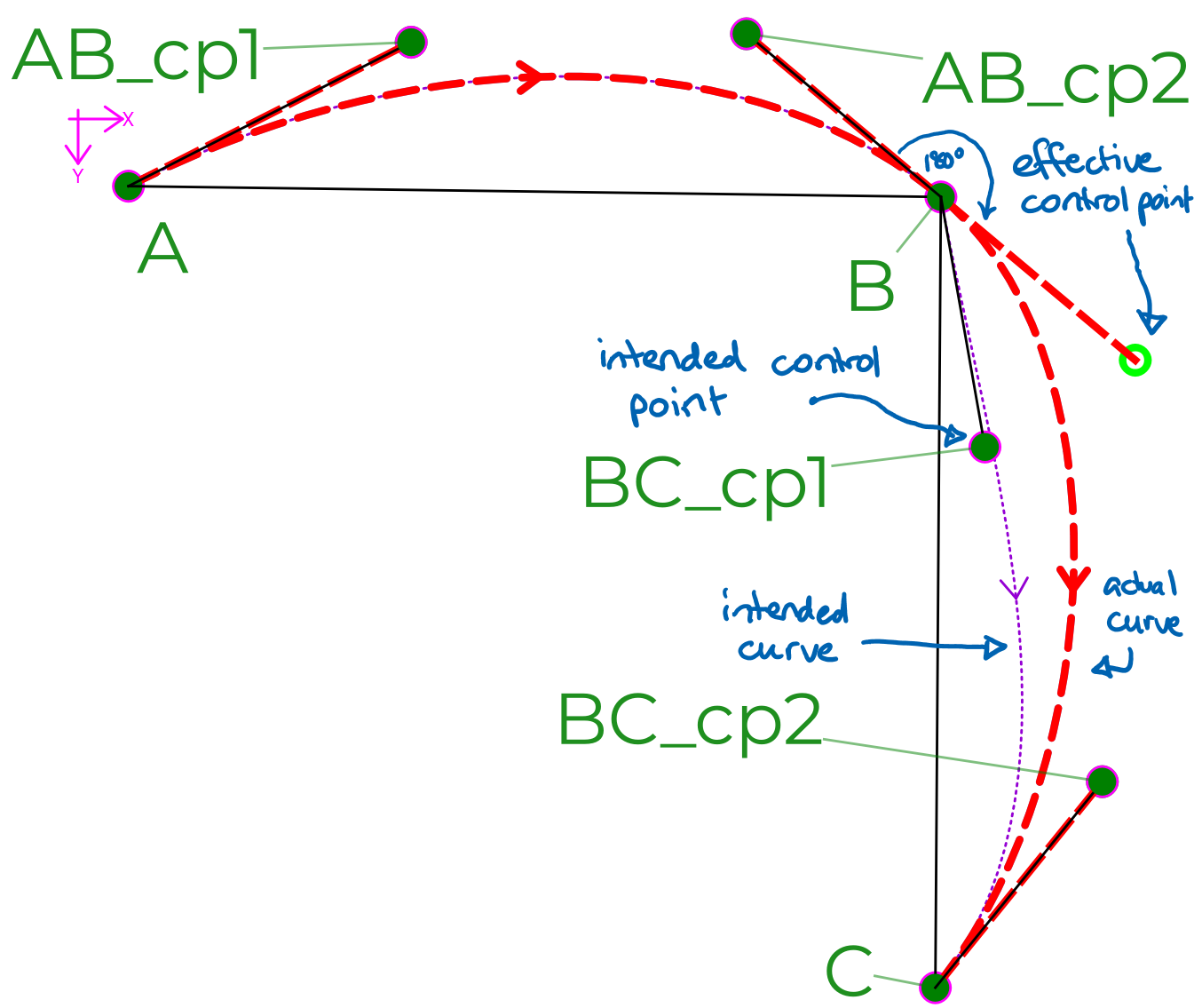

Edit: here’s an annotated version of the above diagram, to clarify which are the intended and resulting curves.
Definitely a bug, the control points on either side of a mid-point using the Spline tool should be stuck 180° apart at all times, both visually & mathematically. Which release date are you using? Does it still let it appear to vary when you restart Seamly? There’s a good chance that @Douglas will want to see a copy of the misbehaving pattern.
Why would it be setup like that? Because the times when one would want a sharp angle in the middle of a curve are virtually non-existent. In all my YouTube watching, I can recall a few times when a pattern had to be altered to eliminate an angle in a middle of a curve, but none where an angle had to be induced in order to achieve a good fit.
So yes, it is intended that if you want an angle between two curves you will have to use the simple Curve tool twice. If I remember my definitions right, Curve is a spline between two points, while Spline is a spline passing through one or more points.
Thanks, Pneumarian. I now see that the behavior I described is intended, i.e. a feature not a bug. :slight_smile:
Funnily enough this came up because I am replicating an existing pattern with splines where control point angles aren’t 180 degrees apart! Never mind, I can work around it by using a sequence of cubic Bezier curves (“curve with control points” in Seamly parlance).
The 180 degrees restriction just means that Seamly can only express a subset of possible cubic Bezier splines (those with continuous first derivatives), unless you build up the curve with individual segments. As far as 2D graphics and CAD packages go that’s an unusual restriction, but probably reasonable for this domain especially since there’s a workaround.

Then changing the angle of BC_cp1 should not be possible and should show the value of 180 plus angle of AB_cp2.
Have no idea what you mean. The spline path tool is currently programmed to add / subtract 180 to the “other” control point angle when the one of the angles are changed - with the exception of the start and end nodes which only have 1 control point.
It’s not a bug, it’s a feature with an expected behavior.

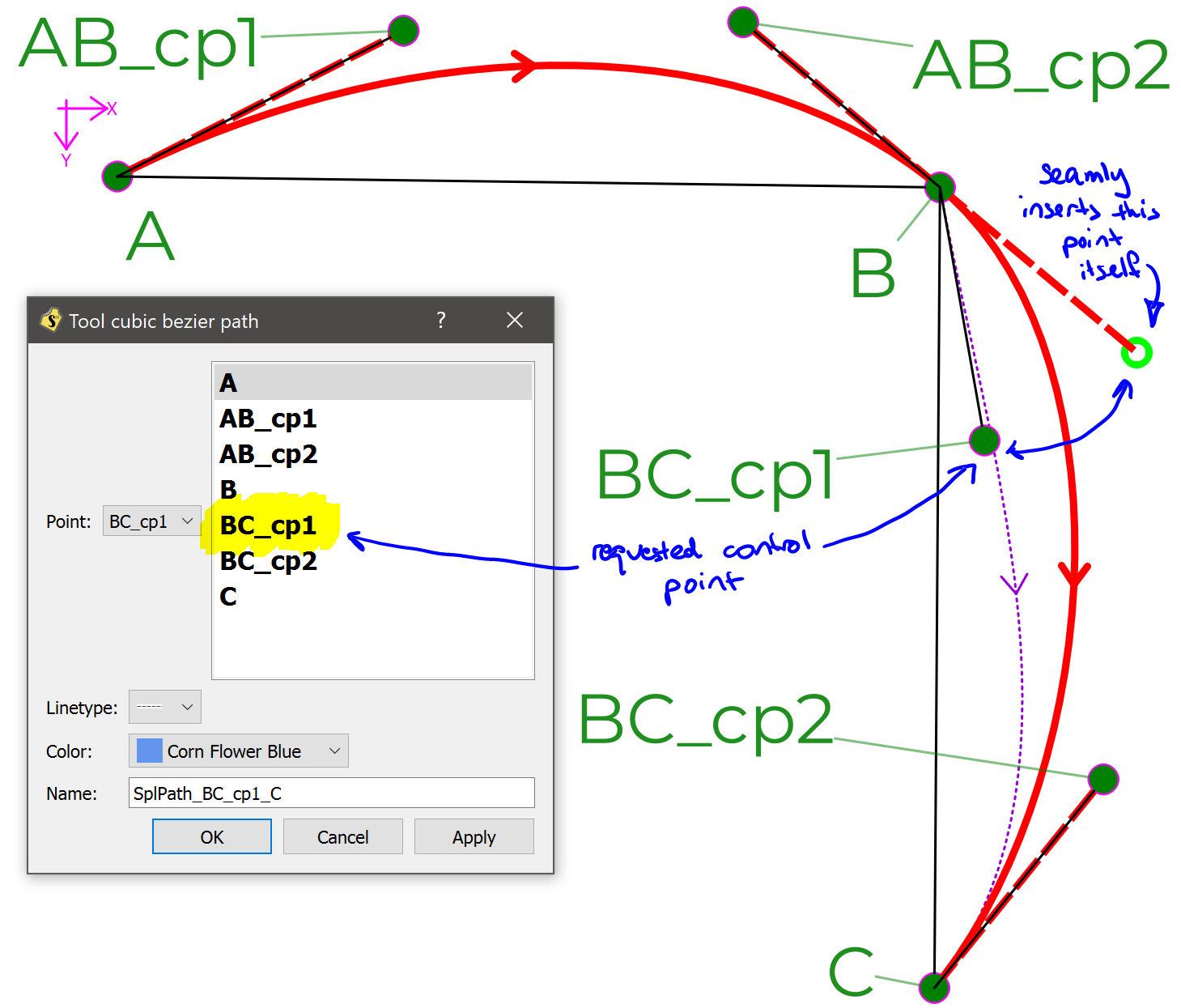

I should perhaps clarify, the image above was made with the “cubic bezier path tool” aka “spline with control points (SP)”, which accepts arbitrary control points, not the “spline” tool. Screenshot:
