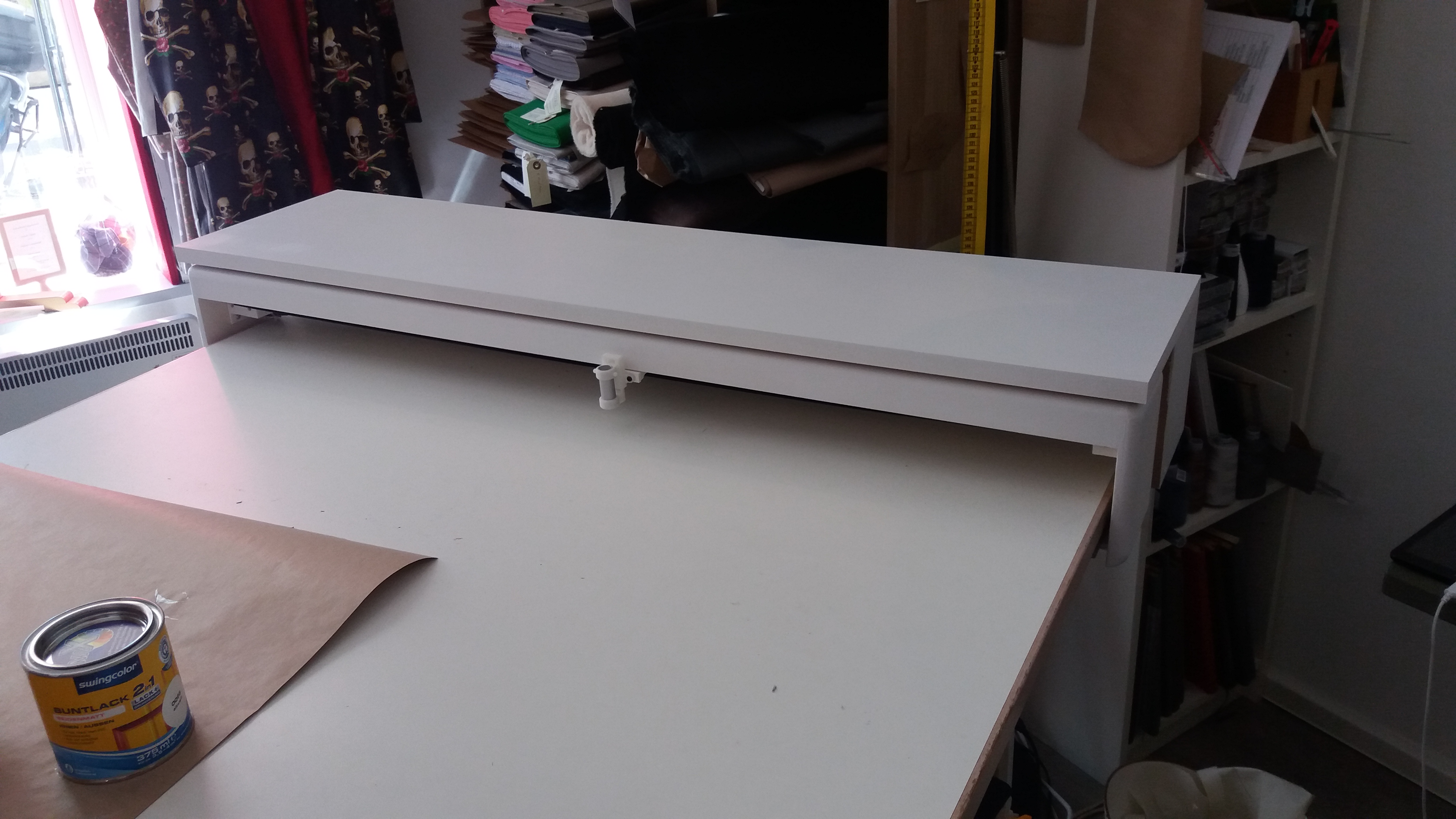

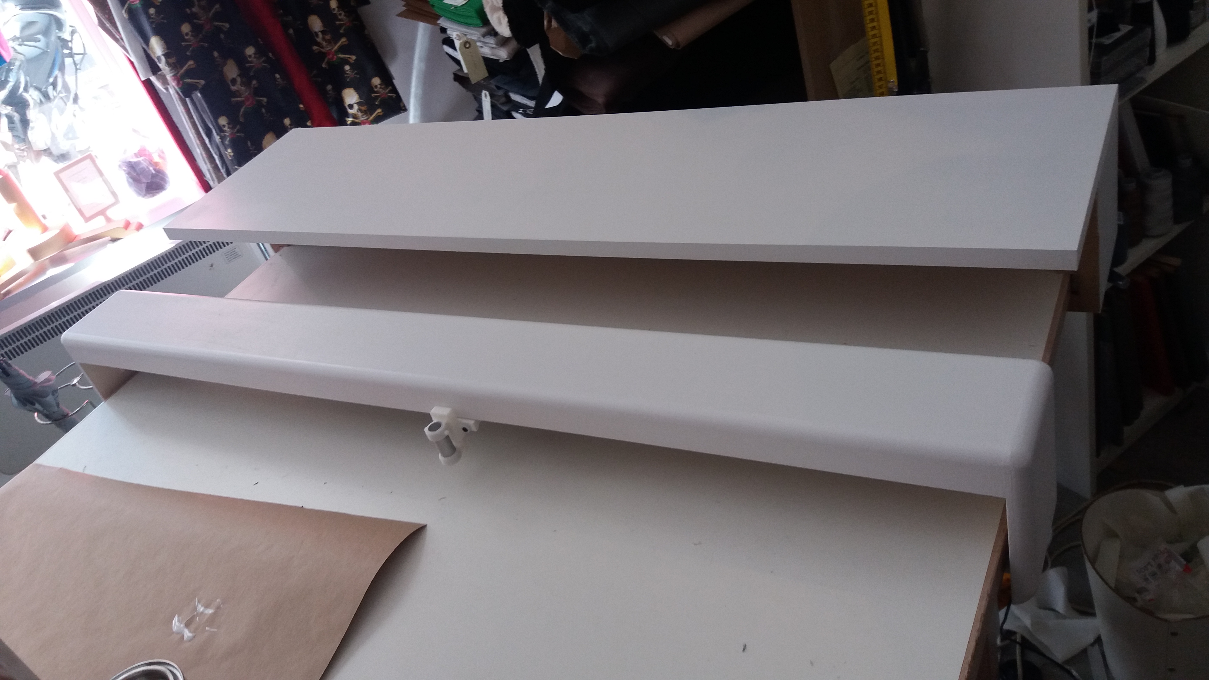

Almost finished my new plotter. Based on a version from Norbert at CNC v2.1 - HomoFaciens
You can find more infos about this project on my hackaday-profile
Just added some pics and videos- Tell me what you think…
4 „Gefällt mir“

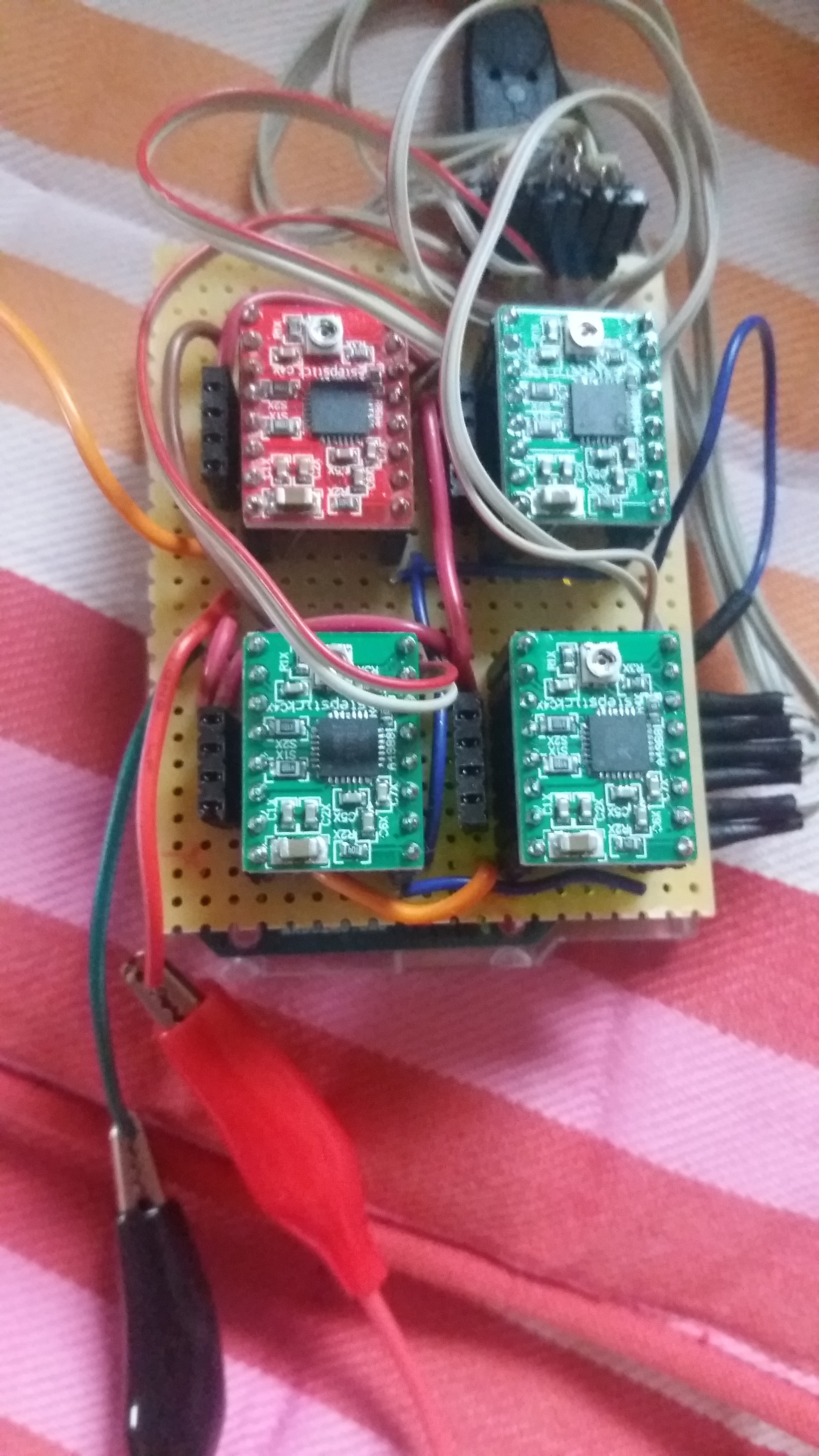

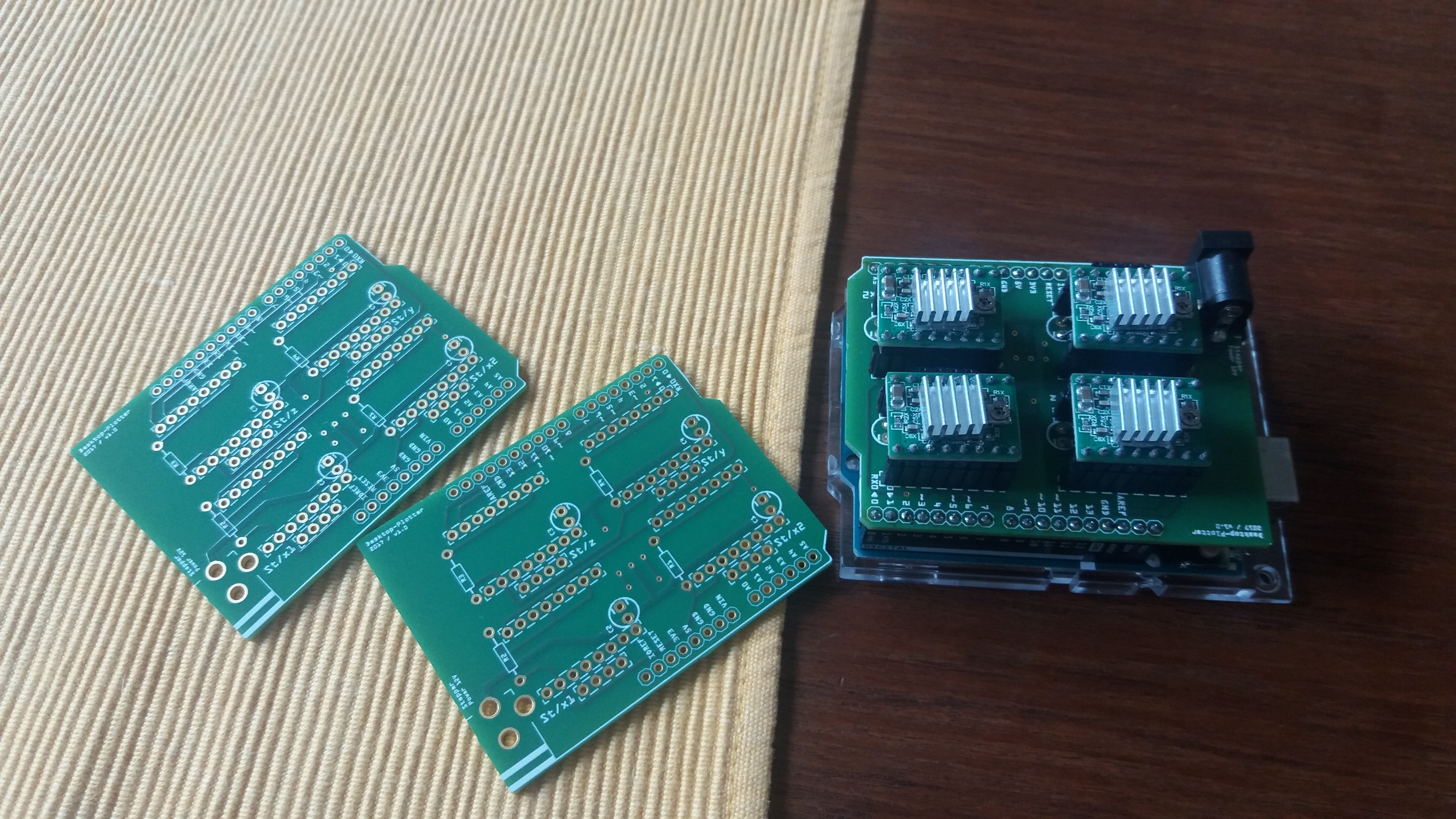

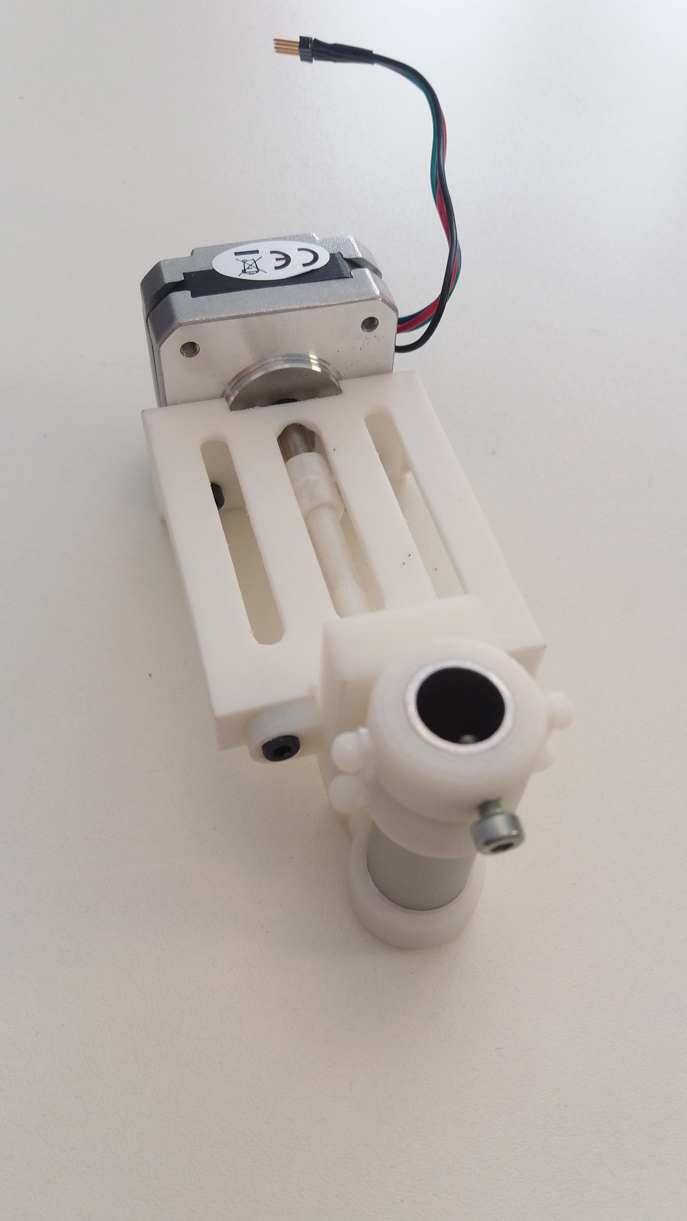

Here are some pics of the making process…
08 49

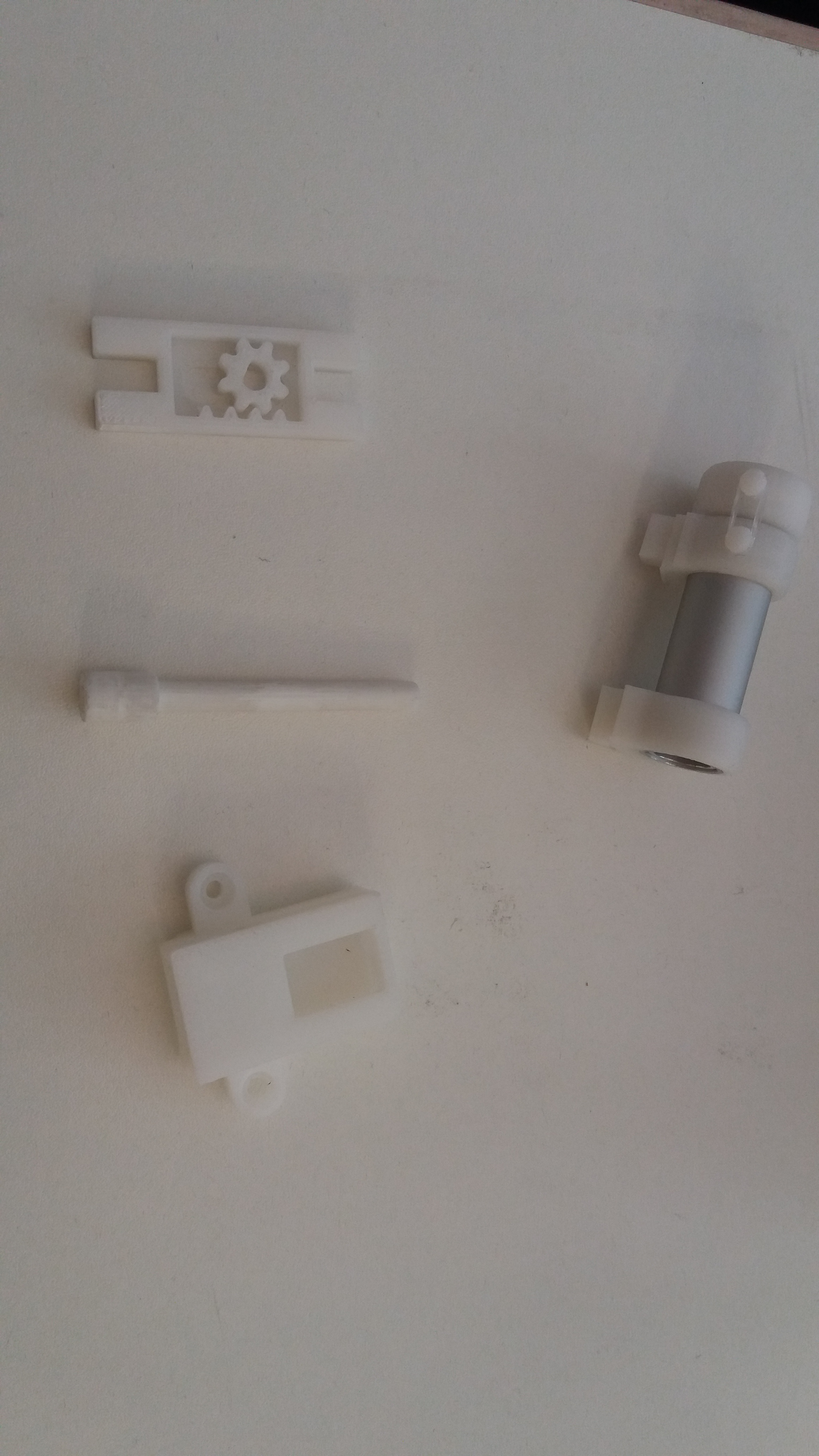

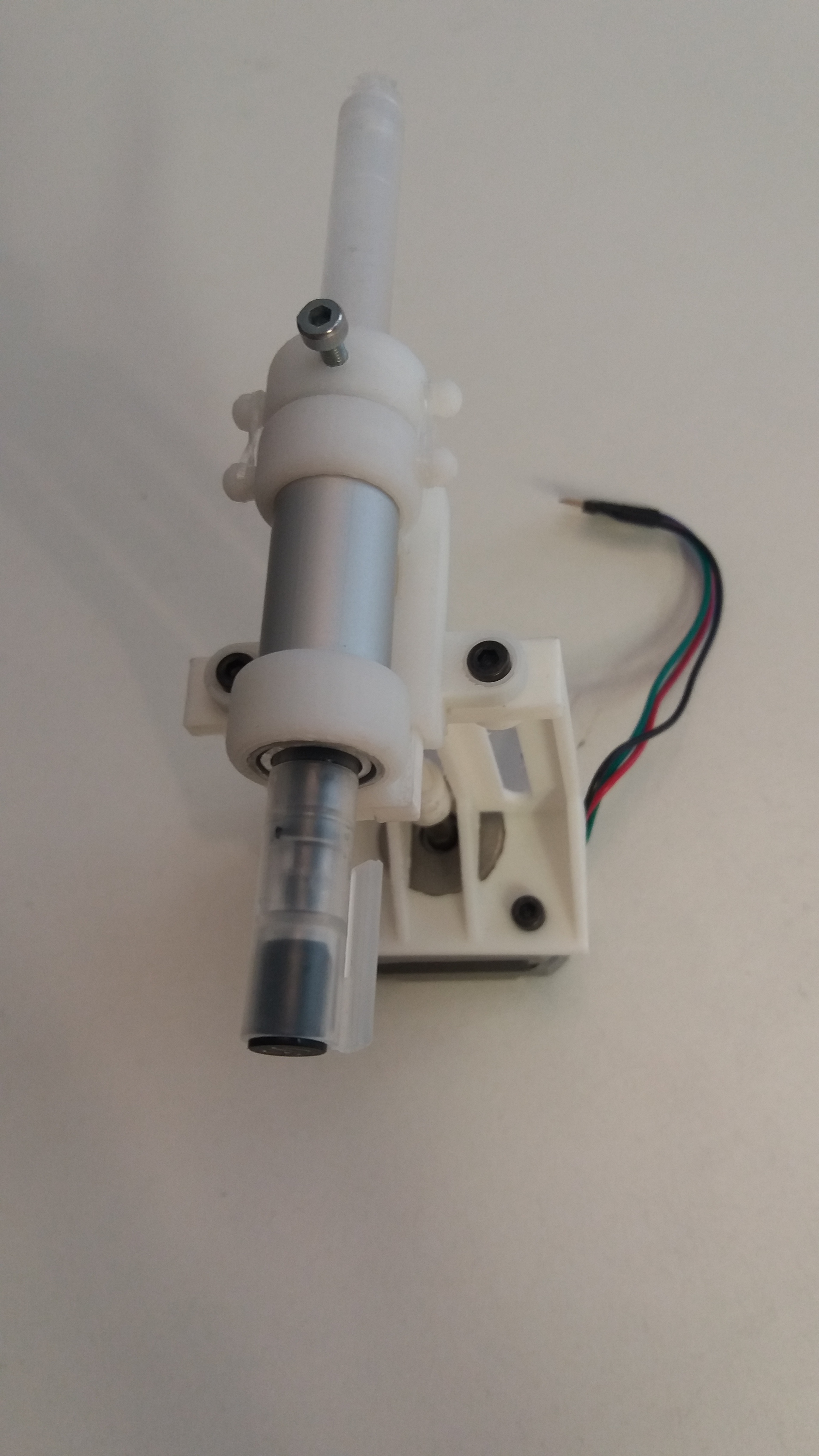

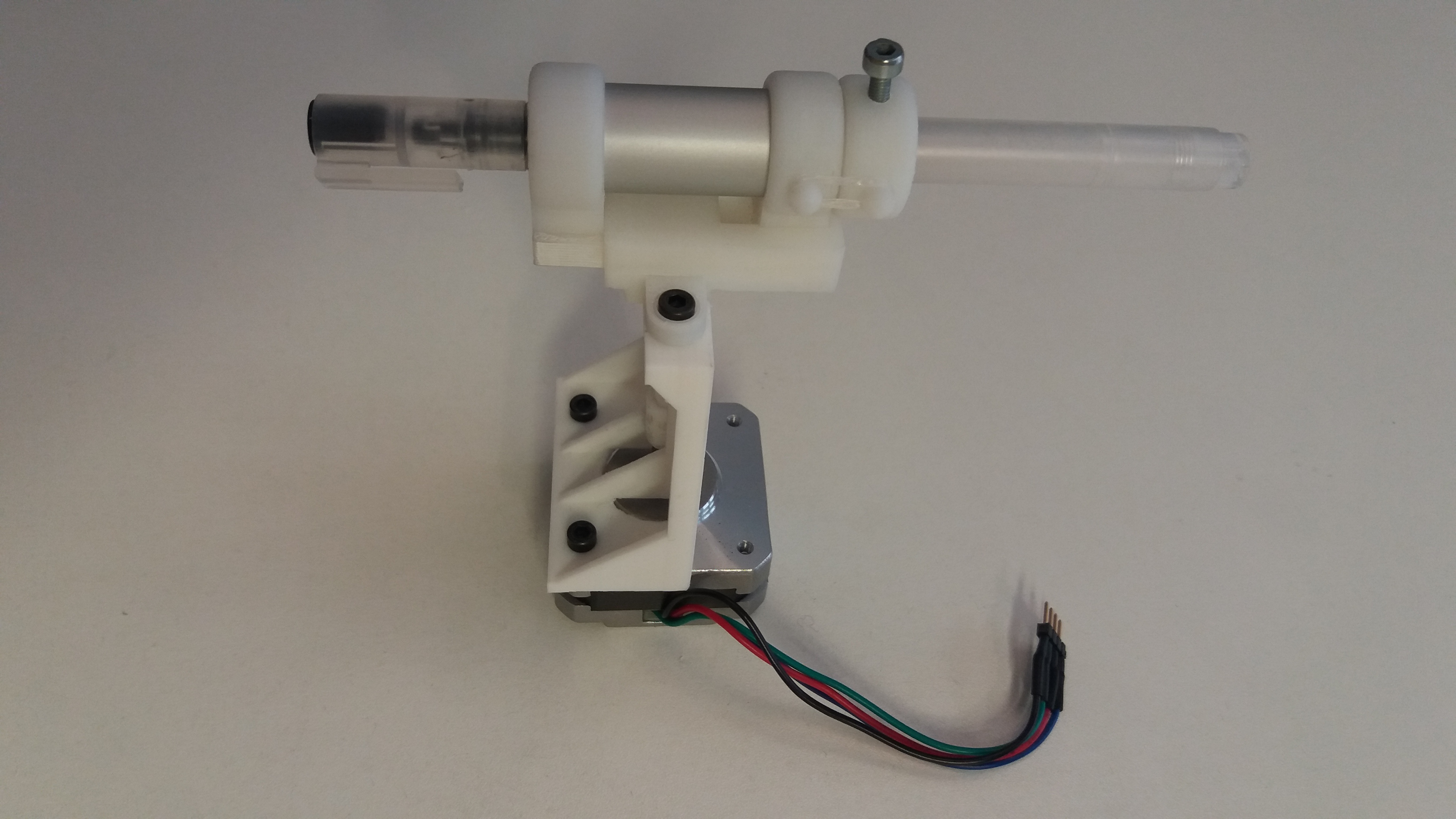

and the pen-lift

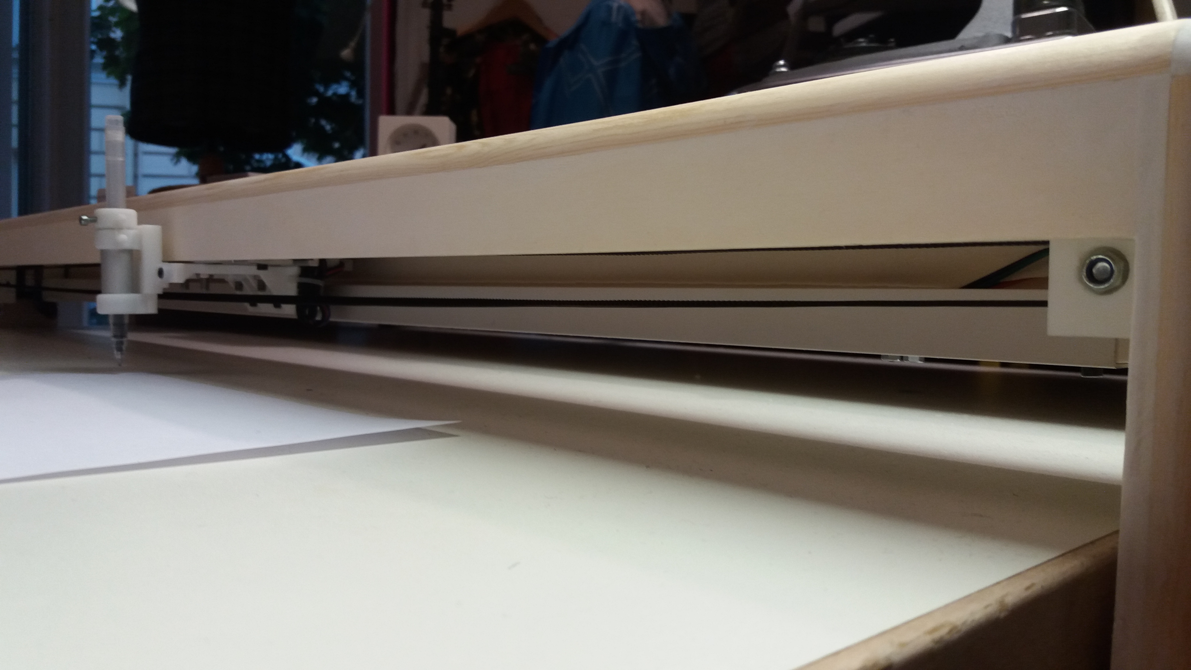

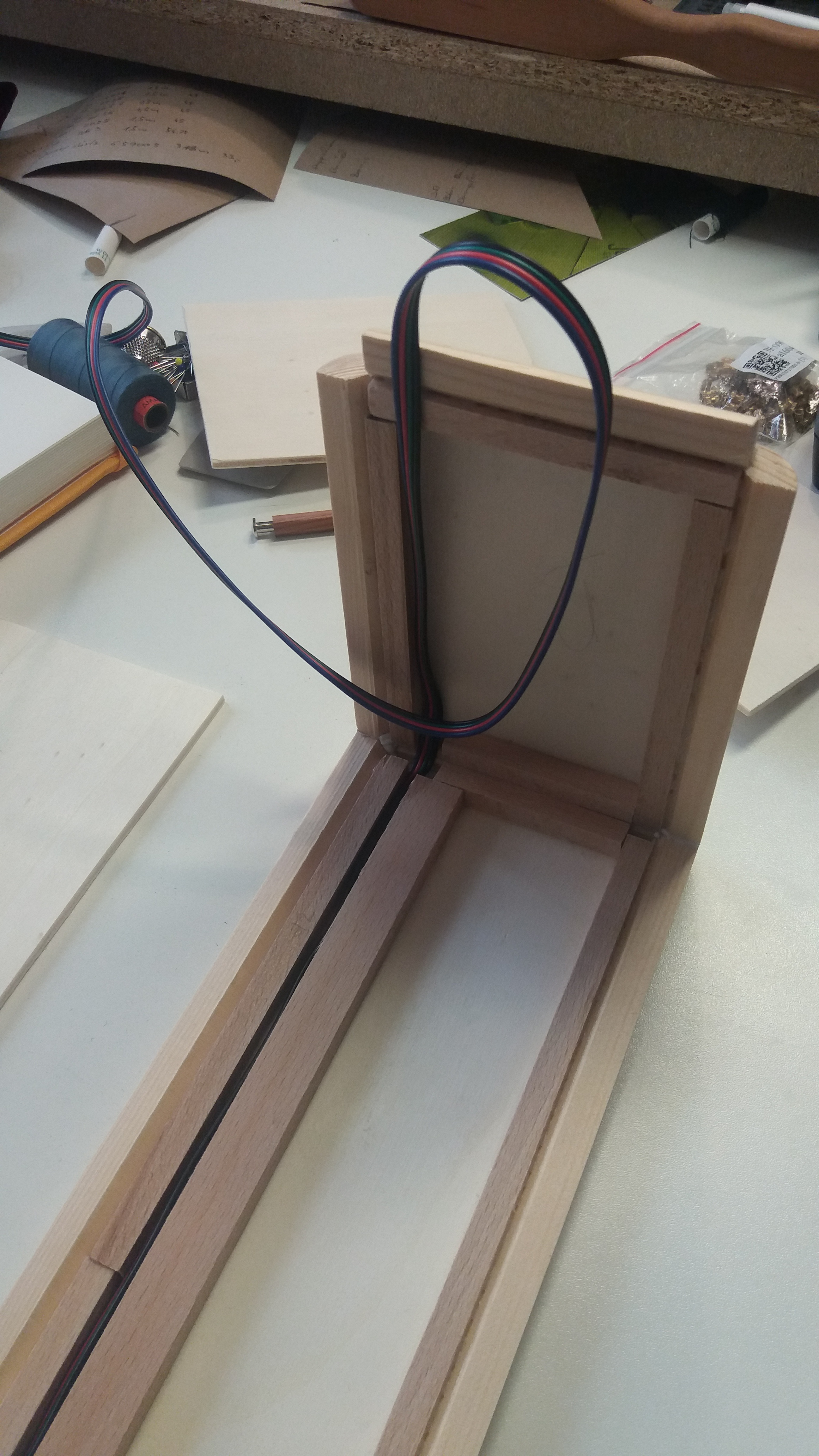

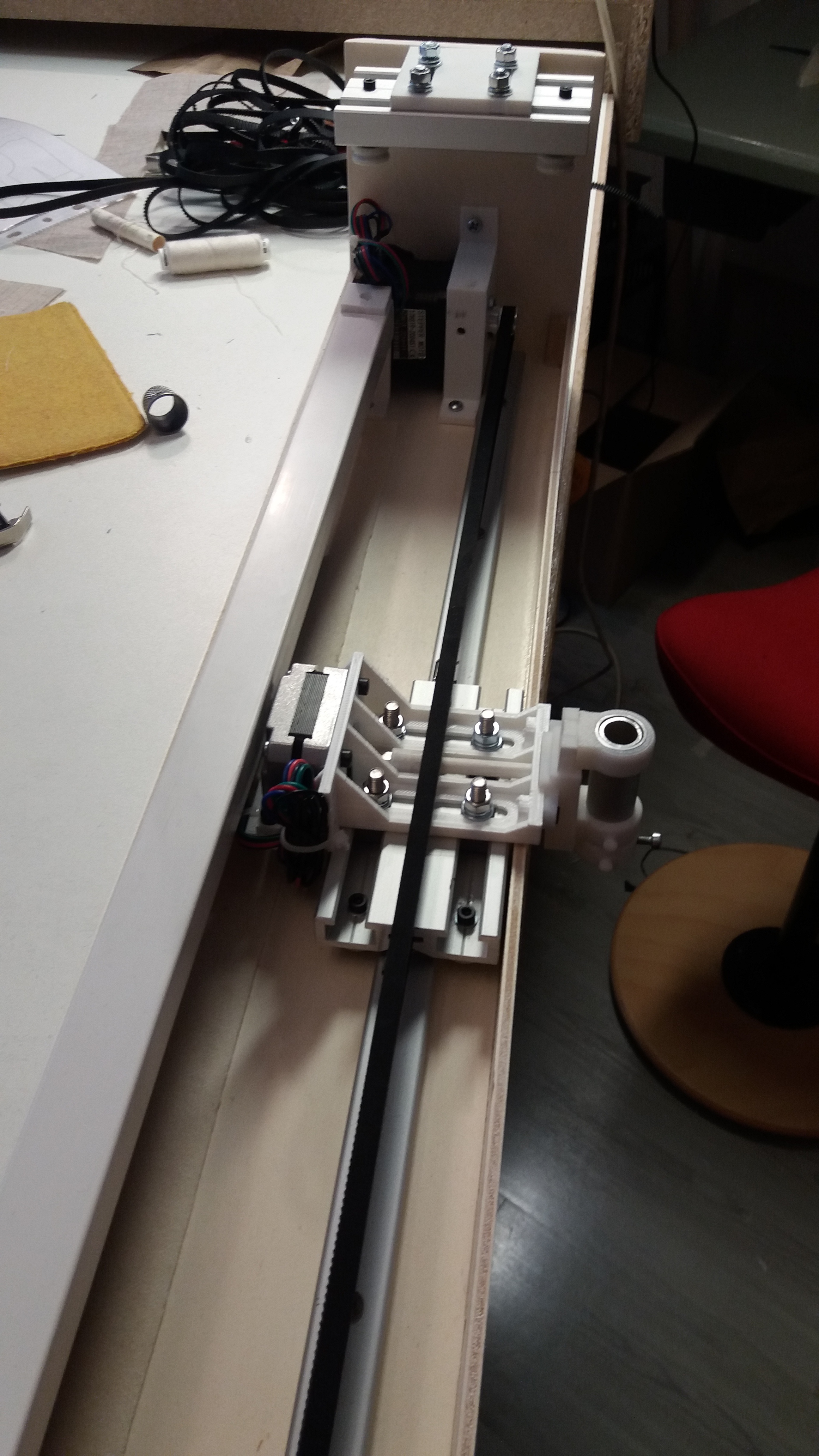

the y-axis
