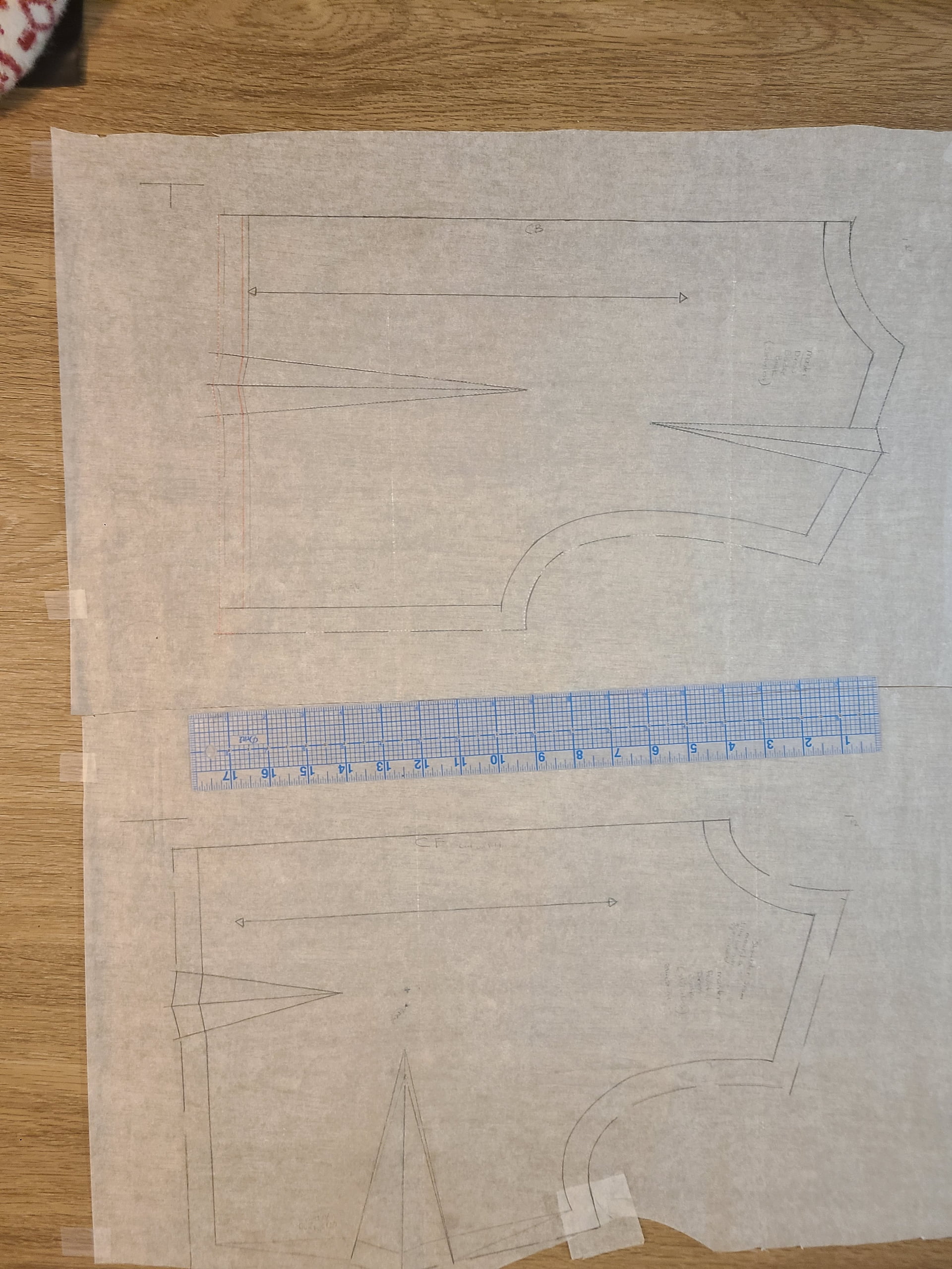

Lol, I could never hate your responses. I am the one that is slow at comprehending all of this and ask for your patience. copy of original bodice pieces.sm2d (11.4 KB) I will check the measurement but that is also the same length on my sloper I did years ago and the shirts I made with it fit great on the shoulder. The only think with it is that the bust and waist are too small now, lol. I will attach a copy of it so you can see how it looks. I managed to trace the pattern but I can’t figure out how to do anything else with it.

Which images are you needing?
The ones you loaded into the old pattern to copy. They didn’t come over with the pattern.
Ok, see if this works.
original bodice pieces from surefit.sm2d (11.4 KB)
You should see the actual patterns on the left and then on the right should be what I have after tracing.
Thank you! Diane

So I need the actual images so that I can point Seamly to them to upload into the pattern.
The only other thing I have is just the photo I uploaded
