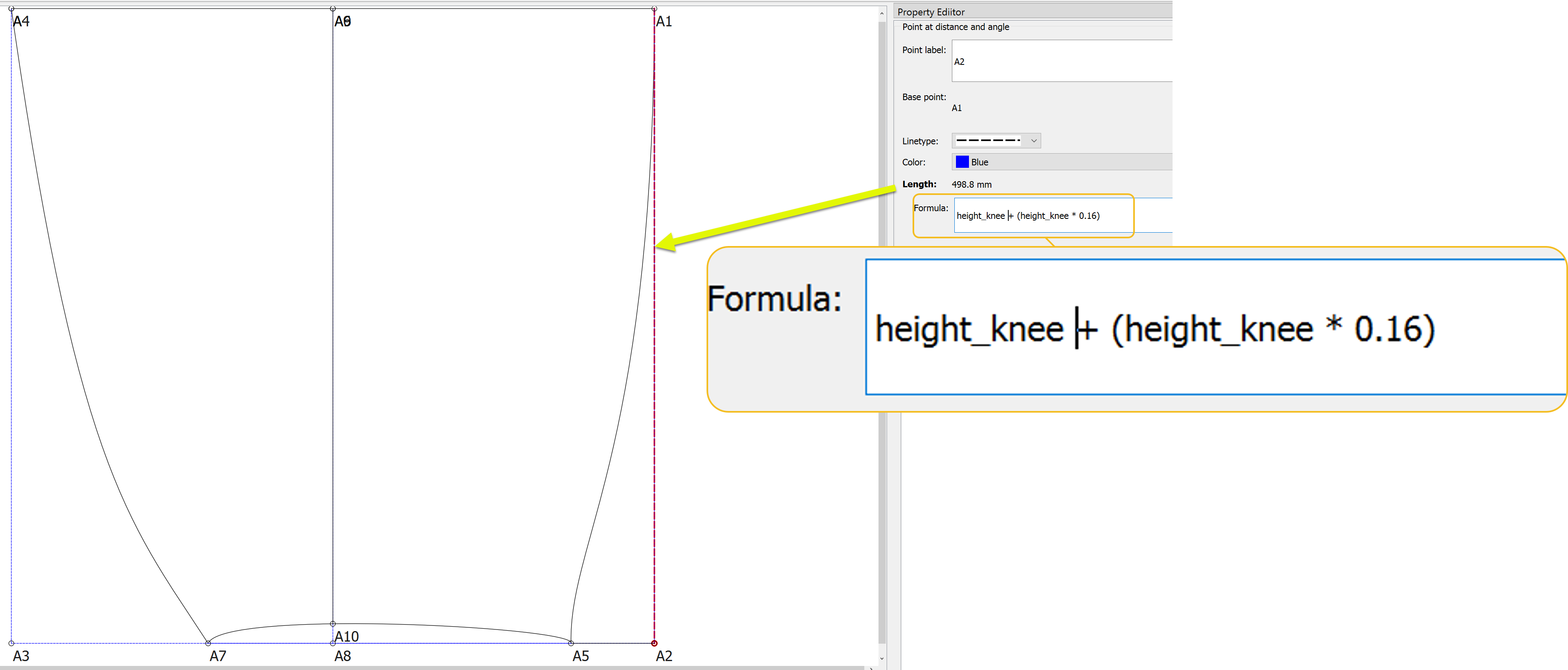

Absolute noobie here for this software… but I do a ton of 3d modeling and am trying to apply that parameterized methodology to this parameter-driven program.
Just a thought… if you don’t like the fixed 3cm value for whatever instruction you’re referring to then can you turn that into a percentage based on what you’re looking at? if its 3cm for your 30cm calf or whatever, then its 10%, right? The person with a 31cm calf will have a 3.1cm margin. Does that work for you? So the formula you enter would be “(measurement_x *.25) + measurement_y * .10” or whatever your calculation turns out to be.
I don’t know if someone else with more experience would consider it ‘good practice’, but I’ve done it in a couple costume pieces so far because it made sense. Like here where I want the length to be enough to cover the knee, not the middle of where the knee bends.
It seemed reasonable that would be proportional for most people. So I took what I liked on me, and added that as a percentage to the pattern.
In some other places where I wanted a piece to end between point A and B (the next measurement higher up the leg. I had to calculate as well. Line length = MeasurementLengthA + ((MeasurementLengthB-MeasurementLengthA) / 2)
Again, I may find out that it doesn’t work. Maybe when I get to a basketball player I’ll learn all the height is 90% in the leg bone and the knee is only 4% bigger than my own. But that’s where the “tailoring” versus “patterning” would come in, right?
