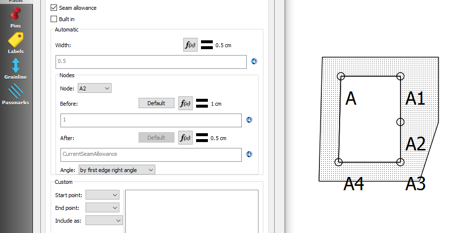

Anyone else notice this problem? The transition between seam allowance widths sometimes doesn’t create a “corner”.
Selecting different options in the Angle dropdown field didn’t change this result in any way. I’ll try to figure out when this problem was introduced, because I’ve created patterns before with a proper zipper extension.

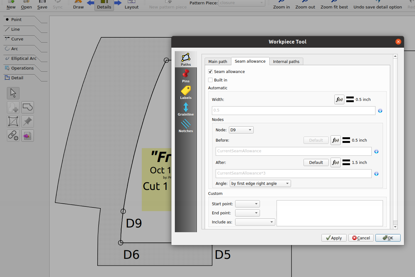

On a different pattern that I tested on the sleeve cap curve, I got this with the 1st 4 options:
And on the last 2 options, I got this:
But I think this is only recent, but I can’t ever remember doing this, so I’m not sure.

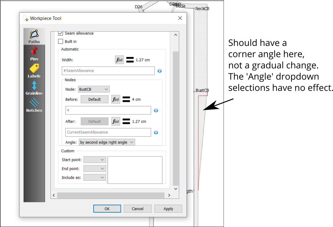

I was using a Windows build from Oct. 1. Here’s the pattern & measurements:
20201011_MyFrenchDressBlock.val (43.3 KB)
20200331-Susan.vit (7.3 KB)

Now here’s Susan’s pattern (in a Sept build) changing the seam values:
Changed 4 to 4.01 and found the lowest I could go before it flipped out again - 1.275. notice the transiton is right at the BustC3 node. Susan1
Now if I used 4.0 notice how the transition is past BustC3… probably 1.275cm. Susan2
And the I found the highest highest value I could go - 1.258 and leaving the 4.0 vlaue alone, the transitio is back to BustC3 ??? Susan3
In other words - at least in this instance - if the after value for BustC3 was between 1.258 and 1.275 the seam would do what Susan showed in her example.
OBVIOUSLY something is amiss. Since I always use inches with 1/2 or 1 inch I’ve never seen this issue before. As soon as I get a chance I will take a look at the code to try and determine what is going on.
