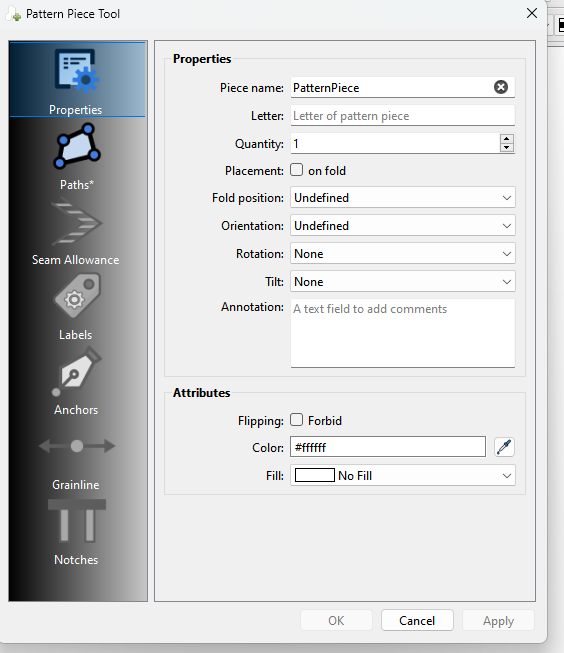

Once you select the points and curves for the path of the new piece… Press ENTER. This will open the Pattern Piece Dialog:
You can then edit the properties or path before editing the pattrn piece in piece mode.
Note for any tool follow the tooltip in the status bar on what to do:
Thank you very Much ! It worked :smile:
