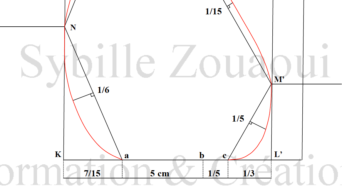

I use the Esmod method for sewing patterns. Here are the instructions of the method:
  • sleeve crown length = armhole depth - its 1/8th
To find the depth, Esmod request to join the front and the back and drawing lines :

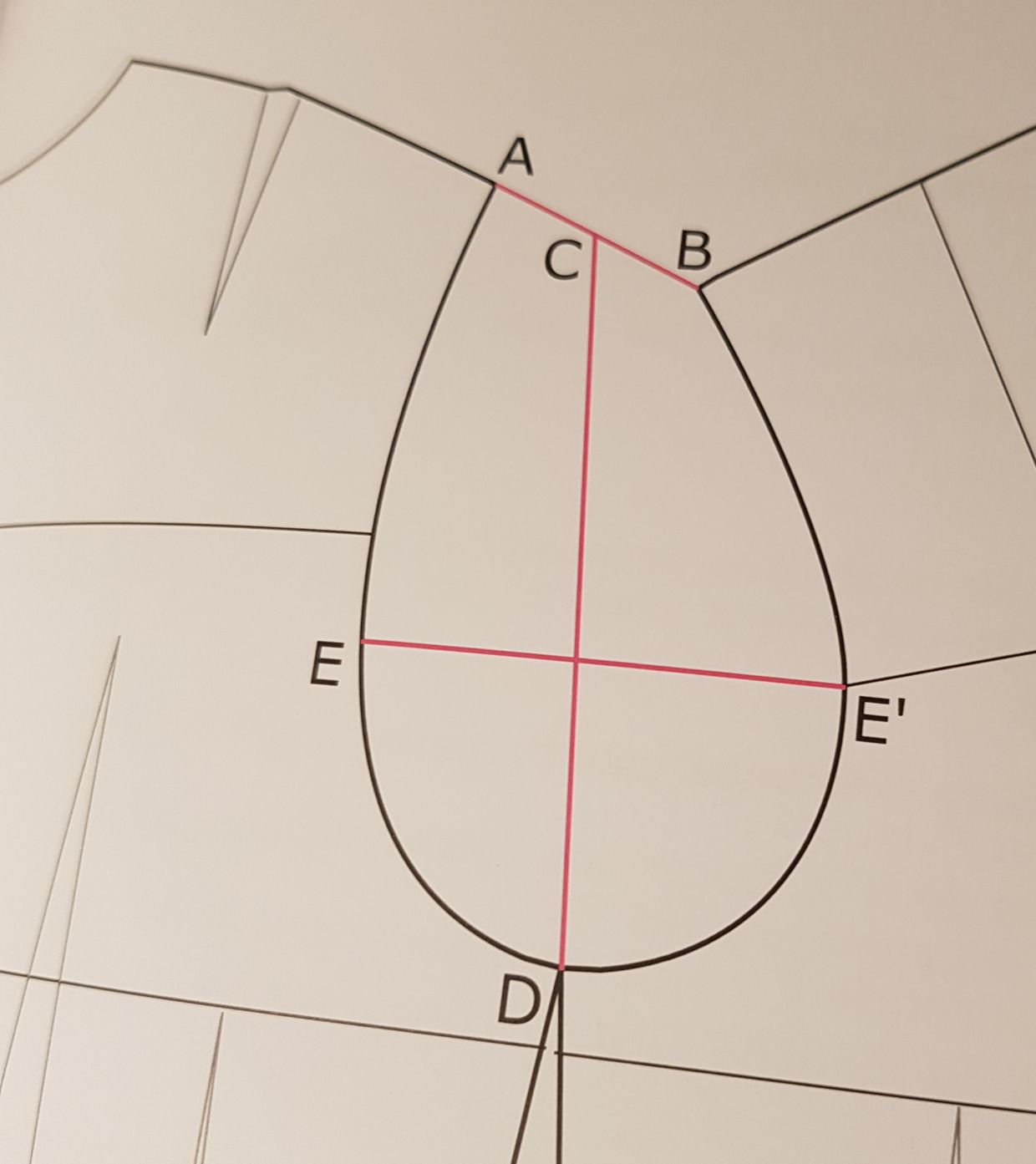

I haven’t really tried the Esmod method, but looking at your image and the instructions, you could easily place the nodes in Seamly2D, draw in the lines and then use the lines in the formula.
The line A-B the centre is C. I’d use the tool Mid Point Between 2 Points:
I’m not too sure what the distance is along the curve A-D which will give you E and the curve B-D which gives you E1. Here I’d use the tool Segment a Curved Path:
Or perhaps points E and E1 are already there for the purpose of drawing the curves. Then it would be a simple matter of using the Line Between Points tool to draw the line (the same tool would be used for the line between C & D):
Once you have the lines drawn, you will be able to use them in the formula for the sleeve cap and Seamly2D will automatically change the values when you use the same pattern with different measurements. :slight_smile:

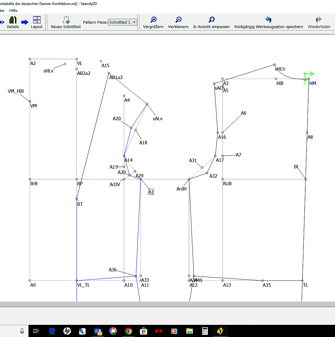

Thank you @Scholli :grinning: That’s exactly what I want to do but I have a problem: the sides of my model are not juxtaposed:
53
But in the Esmod method, before drawing the line (A27-A28 in your example), it is necessary to maintain the centre front and the back lines parallel, pin together at underarm (in my example A99-A98a1 are not superimposed). So I’m looking for a formula using lengths to find the armhole depth without having to move everything :blush: The formula I found and shared in the previous message does not give the right depth. I tested by printing the pattern and doing the drawing method. I do not find the same length :thinking:
@MumuLcy ich habe gemerkt, dass es im Vorfeld sehr wichtig ist zu überlegen, welche Schritte noch folgen. Der Punkt 98a1 lag doch vorher wo anders. Lag er nicht auf Höhe des Punktes 99? Dann gibt es vielleicht die Möglichkeit die Armlochhöhe in einem voherigen Schritt zu bestimmen. Wenn das nicht geht würde ich eine neue Gruppe anlegen. Darin dann den Abnäher mit nur den nötigsten Punkten zulegen und die Armlochhöhe bestimmen. Dann kannst du die Gruppe unsichtbar machen und weiter arbeiten.
Ich glaube nicht, dass es eine andere Möglichkeit gibt. Wie würdest du den die Armlochhöhe bestimmen, wenn du auf Papier gezeichnet hättest? Ich denke du müsstest auch die Seitennaht von beiden Teilen aneinander legen, oder?
Wie sieht denn dein Grundgerüst aus? Vielleicht kannst du das mal zeigen.

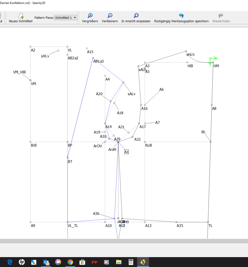

I think I’ll have to actually do a process integrating Valentina from conception. Here is the pattern before the creation of the clip and with the enlargement.
46
The points are not exactly one on the other. You’re right, I’m going to calculate the armhole in advance next time. Here the offset is not very large but for the next it may be larger because this is due to the margin of construction of the method (5 cm).

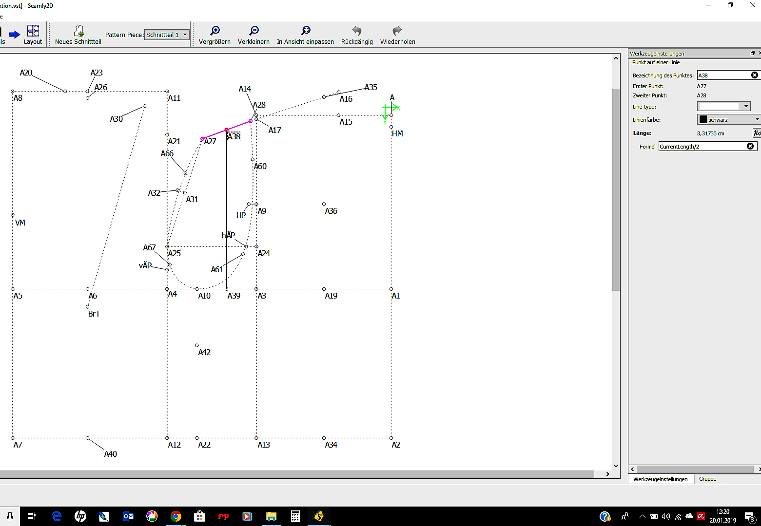

@MumuLcy, I think you can draw in the line from shouldertip to shouldertip with a node halfway using the points before you did the rotation for the dart and then draw the line down to A98. And then that distance will be available to you afterwards for the next part of the draft.
