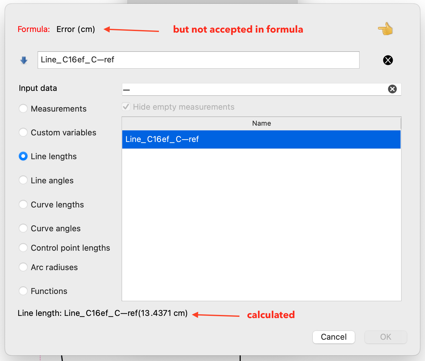

Calculation non accepted in formula because of separator character in point name
please see video here:
It looks that the lenght of the line is correctly calculated but not accepted in the formula calculation. My guess is because the ~ in the point name. I tried also with en dash and em dash: same result.
See screenshot: where I used an EM dash
What characters can I use apart to underscores? I find confusing that the underscore is used as separator in the point name and also in line names and spline names. I tried Camel case but to me is not that legible.

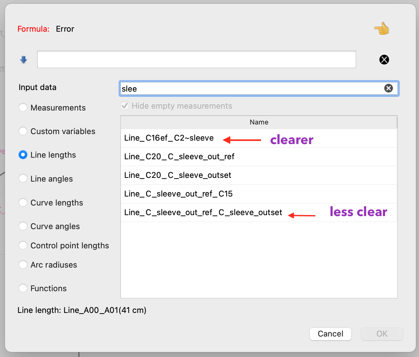

The less clear line in the example could be a line between:
  • C_sleeve_out and ref_C_sleeve_outset
  • C_sleeve_out_ref and C_sleeve_outset
etc.

En dash, unicode U+2013: –
Em dash, unicode U+2014: —
Bullet. unicode U+2022: •
are such characters, which doesn’t make sense to me as they have no mathematical meaning and are used in good typography, also they are not listed here
A Case for different dividers in point names
Elaborating from the example in the original post:
Sometimes I name my points with names related to what the point are:
  • waist_reference
  • anchor_labe01
  • anchor_label02
  • sleeve_outset
  • sleeve_outset_ref
  • etc..
If the underscore is the only separator in the string it can be difficult to understand if it’s separating between two part of a point name or it’s separating two point:
example: Line_armscye_fitted_neck_back_point can be a line
  • between armscye_fitted and neck_back_point
  • between armscye and fitted_neck_back_point
C_sleeve_out_ref_C_sleeve_outset can be a line:
  • between C_sleeve_out and ref_C_sleeve_outset
  • between C_sleeve_out_ref and C_sleeve_outset
Having only one divider forces to workarounds, such as putting a prefix in front of every point or constructing a sort of positional grammar of point qualifier, it’s possible, but I prefer to be able to name points more freely.

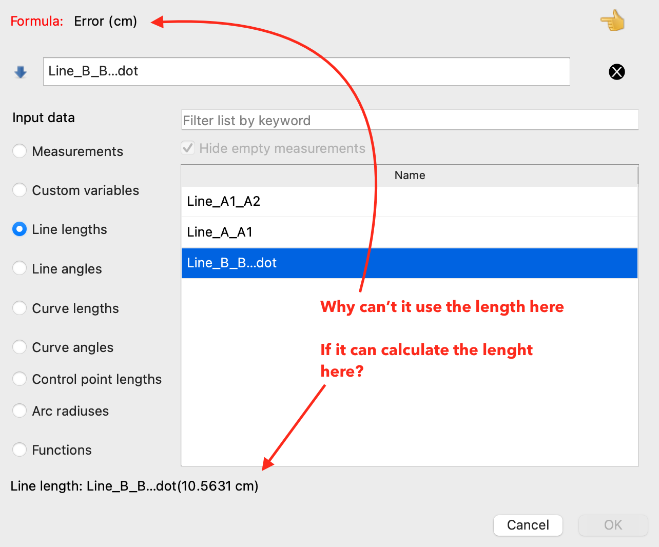

It looks to me that the math parser is stricter than the regex pattern. For eample, I tried the
BOX DRAWINGS LIGHT DOUBLE DASH HORIZONTAL
Unicode: U+254C : ╌
And it’s accepted in the point name but does’t work in the formula.

but when using characters not accepted by the math parser Seamly is still capable of calculating the lenght of the line, even if one of two points has “illegal” characters in the name. Why can’t it use it in formulas?
Because the math parser isn’t paying attention to the name, unless it’s written in a formula, (Based on what I’m seeing in the XML, so I think I got that right.)
