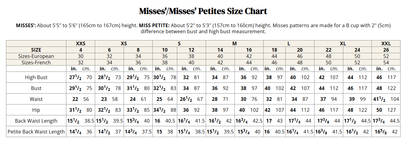

really just means it’s size #1, 24 is size #2, 26 is size #3… 72 is #26 and the actual measurement for each size is determined in the multisize measurement file? And if I (finally) understand correctly what you’ve been after me for so long is that besides being able to use inches, is to define a range of the sizes - which would subsequently display in the dropdown - so for ex: using a US “Misses” size chart range of 12 sizes 4 to 26 where the measurements for each size is calculated in the multisize file? In which case the size range belongs with the measurement file NOT the pattern, and we would edit the range in SeamlyMe NOT Seamly2D?

We want to be able to customize a size chart with a starting size, an ending size, what the increment between each size is, AND for which ever chart you use work in the units you want. Theoretically we should be able to create a mesurement file in cm, and load them into a pattern in inches or vice versa. Then in the measurement file the measurments would be calculated as per the grade rules you set up… for example using the US sizes in the misses chart we would have size 4 to 26 incrementing by 2, the bust size would increment by 1 1/2" from size 4 to 12, and by 2" from 12 to 26. We would move the “chart” (range of sizes) setup from the Pattern Prefs in Seamly2D to SeamlyMe… and get rid of the cumbersome checkboxes of heights and sizes. The chart would be dynamically created by either 1)Providing the start size, the end size, and the increment OR 2) Custom sizes to accomodate for ex: XXS to XXL. Then… within reason… when you load a measurement file the toolbar dropdown (re)configures to the chart associated with the measurement file loaded.
So in a around about way to @Radhika 's question… no, currently we can’t change the dropdown to show odd sizes / heights, but what I have in mind we could.
