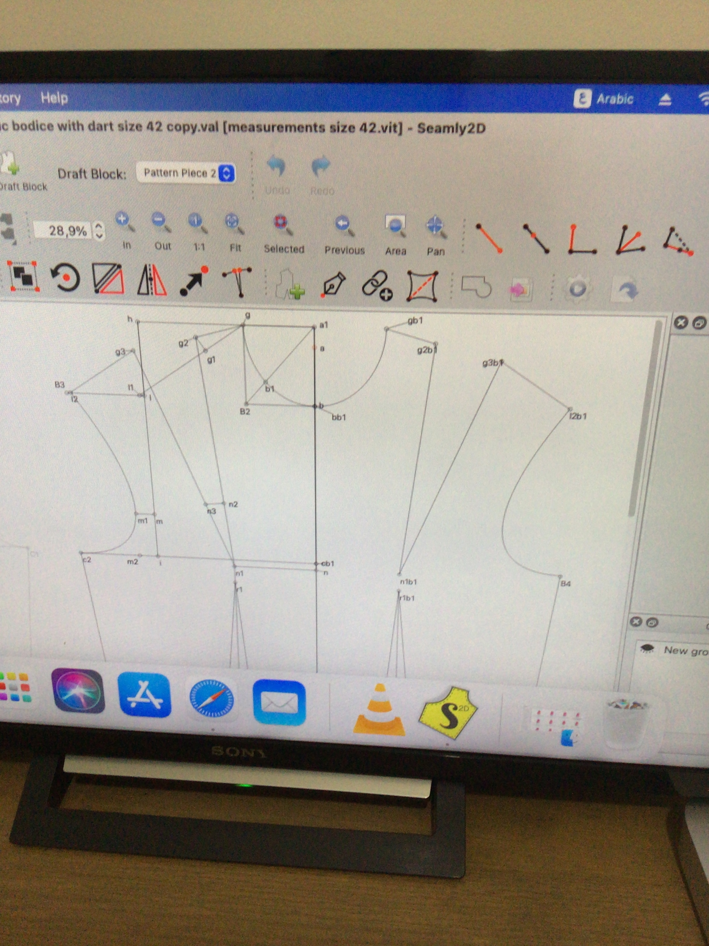

Can print the hole pattern
How can i print hole the pattern with all lines and number
To print all the lines, you will need to create a detail of all the outlines and add the lines and curves inside the outlines as internal paths.
Unfortunately, you won’t be able to print the labels at this stage.
However, you could take a screenshot of what you see on your screen, if you are using it for a tutorial, where the exact size isn’t important. I use a program called Lightshot for this purpose, however, I believe there are other programs.
thank you very much god bless you
Hmmm… so - would there be a good reason to be able to export the draft mode screen (scene) to say a png or svg? Pretty straight forward to do… would just need to paint the scene to png / svg and save file… just like in piece and layout mode.
Hmmm… Yes, I think that would be hugely useful to teachers & lecturers teaching the Seamly2D pattern making or for someone writing a manual for Seamly.
I took a quick look earlier… maybe able to adapt the existing SVG export method to also handle the draft scene, if not Qt has built in functionality for the various file formats so this should be an easy feature to add.

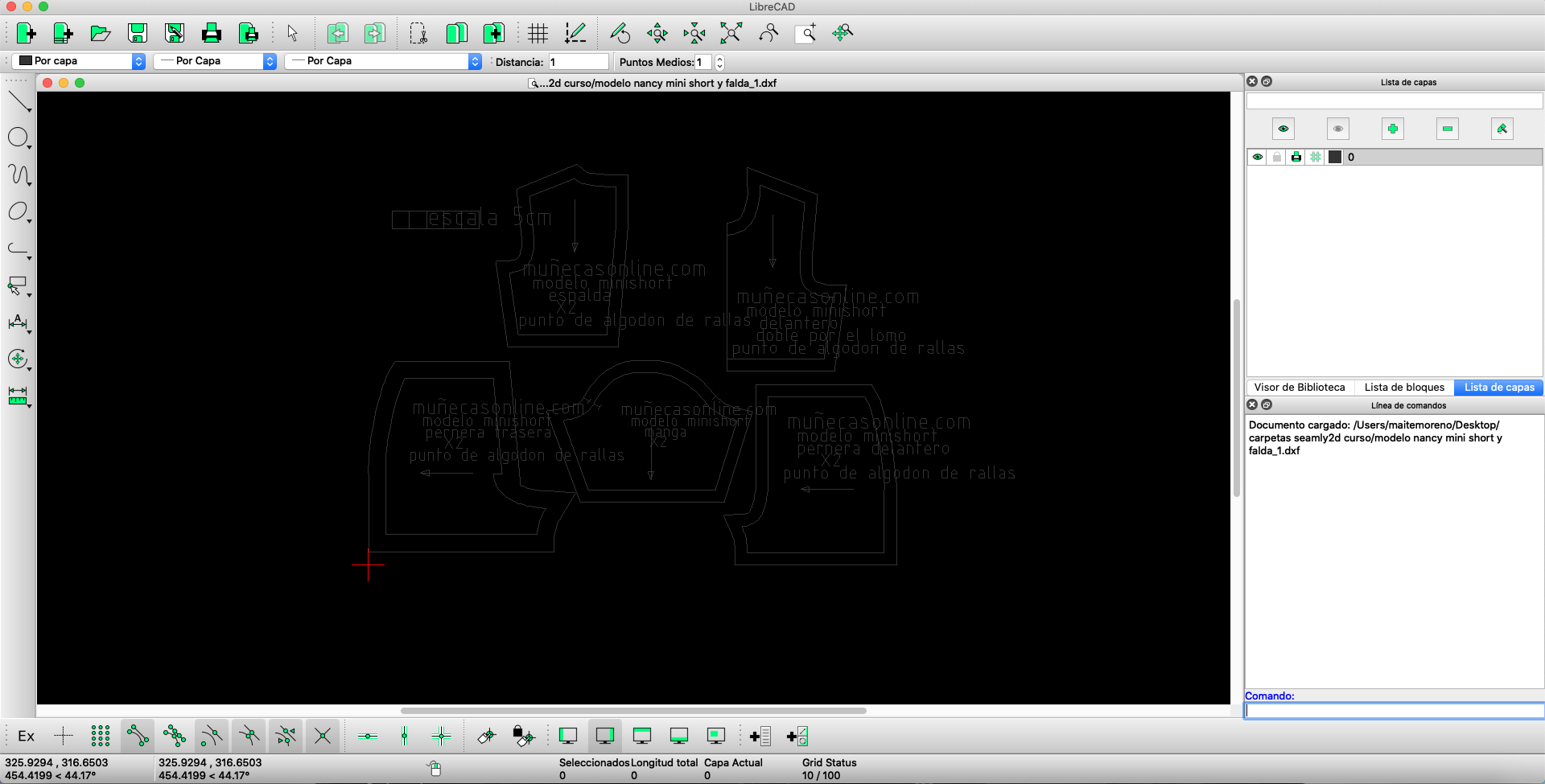

yo eso lo hago si no necesito medidas con una captura y Captura de pantalla 2021-03-17 a las 11.01.40
donde puedo hacer Captura de pantalla 2021-03-17 a las 11.01.57 Captura de pantalla 2021-03-15 a las 19.41.18 pero si necesito medidas exactas lo hago con “librecad” que es un software libre CAD 2D
lo tienes que pasar a formato .DXF para poder hacerlo.
