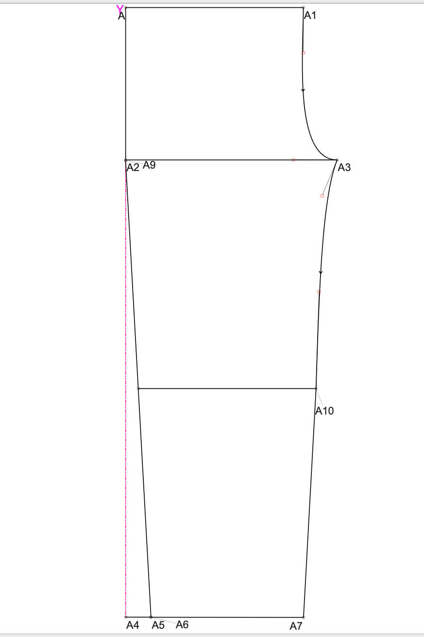

Hi Grace sorry but the problem has surfaced again I can’t make a pattern piece with this image.

That being said… what’s the purpose of the duplicate points A2 & A9 and A5 & A6?
So Select A, A1, Spl_A1_A3, A3, Spl_A3_A1, A10, A7, A5 or A6, then A2 or A9, Enter. Wtach to make sure the path is highlighting as you click around the path. You should see the Pattern Piece Tool dialog.

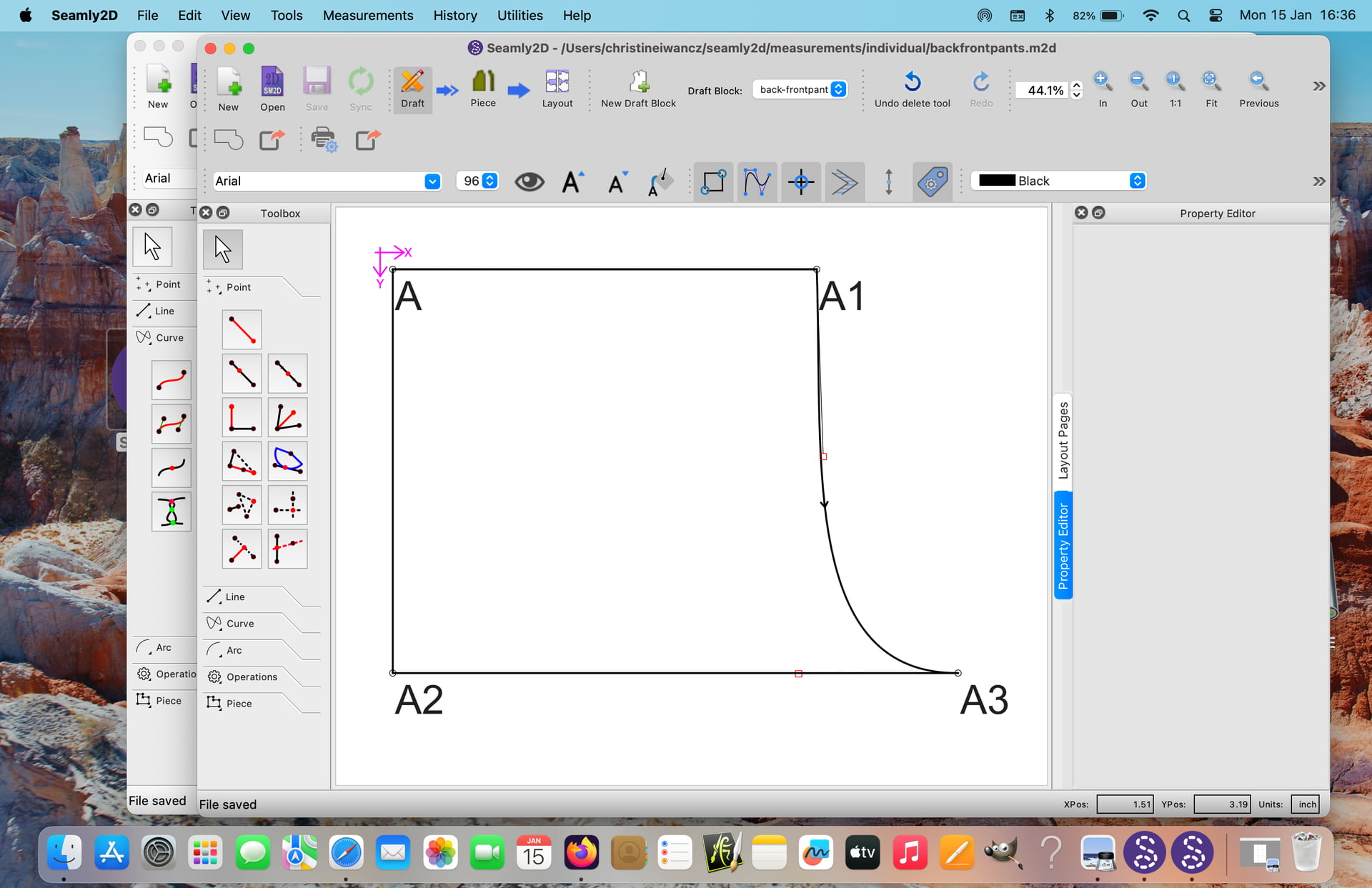

Hi Douglas, the A4-A5 is the 1.5” node from the corner red line. The side seem is A6-A9 should have linked to A2 I zoomed the image to place the line dead centre of A2 but it added an extra node A9. I made sure to press the shift key when I knew which lines were anticlockwise. I have just recreated a simple pattern with simple lines the only line going anticlockwise is A2-A3 here is the screen shot.
Ah, that was confusing to me at first too. Seamly drafts are not based on lines, but on Points. The only structural lines are the curves. The lines are drawn between points only to show which point your point is based from. There is also a Line Tool for when you need a measurement between two disassociated points, (which can also be used aesthetically.)
When tracing the pattern you do not use the point or line tools, you use the Add New Pattern Piece tool (first tool in the Piece toolbox, or keyboard shortcut NP) as pictured in @Grace post. Having activated the Add New Pattern Piece tool, the status bar at the bottom of the screen will indicate what you are to do. In the case of this last picture you might start at Point A, then A1, Spline_A1_A3, A3, & end at A2. tap enter & you get the Piece dialog where you can fix accidental back-clicks & name the Piece.

Thank you, I will give that go on this simple pattern reading your explanation and Douglas I must be missing some nodes, I have been going round in a clockwise direction but only picking up one node, five in total ending at A.
If you missed a node don’t worry. You can always use the insert node tool to add any points or curve sections you missed. Also in most cases the app will detect if a curve needs to be reversed, so you don’t have to use the shift key. You can always reverse a curve later if need be. The direction of a curve is indicated by an arrow.
Also - not that it applies in this example, but if you have a point on a curve - say for a notch - you need to select the curve, the point, and the curve again.
