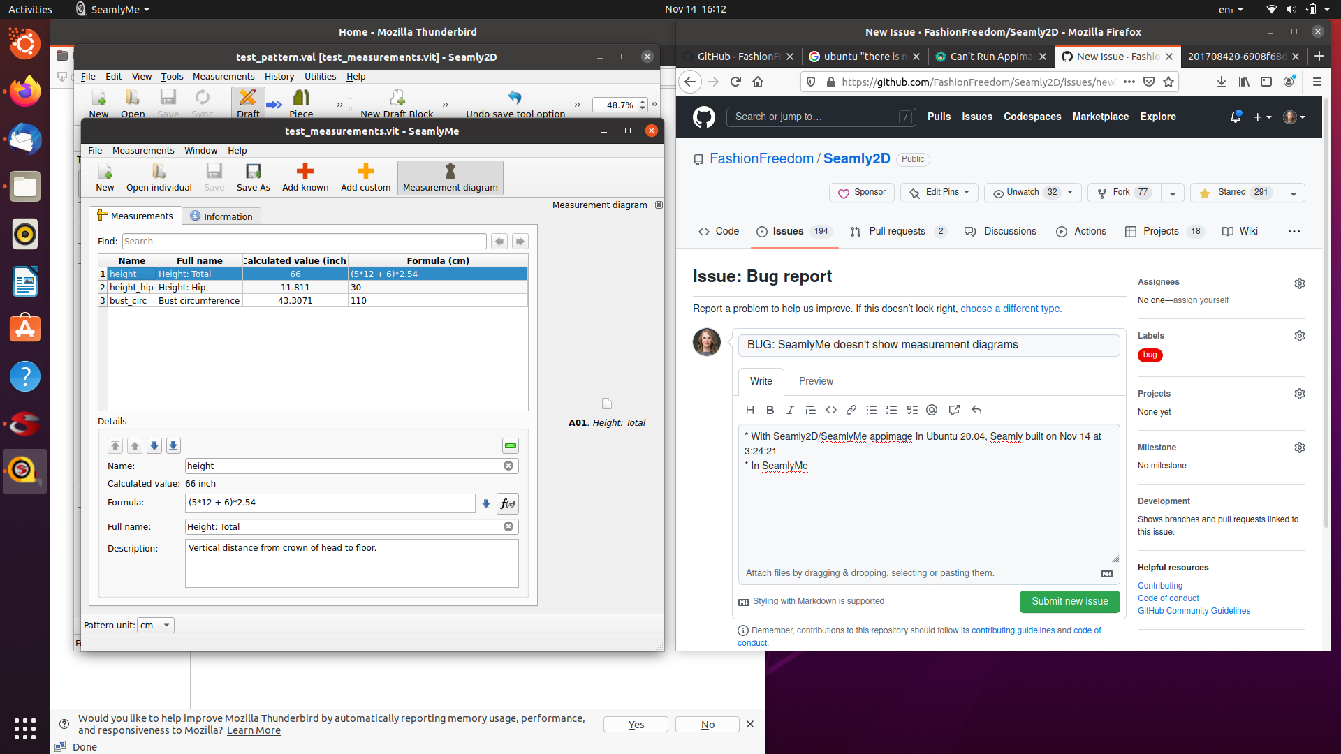

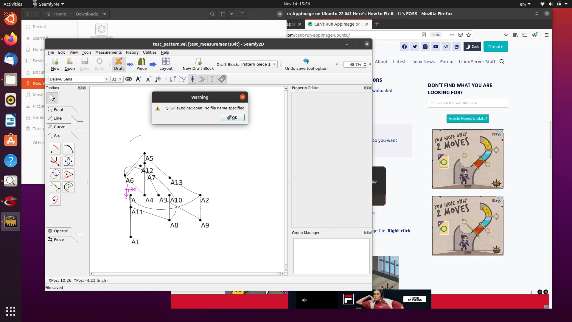

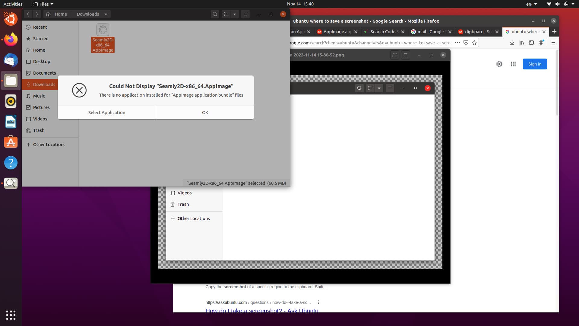

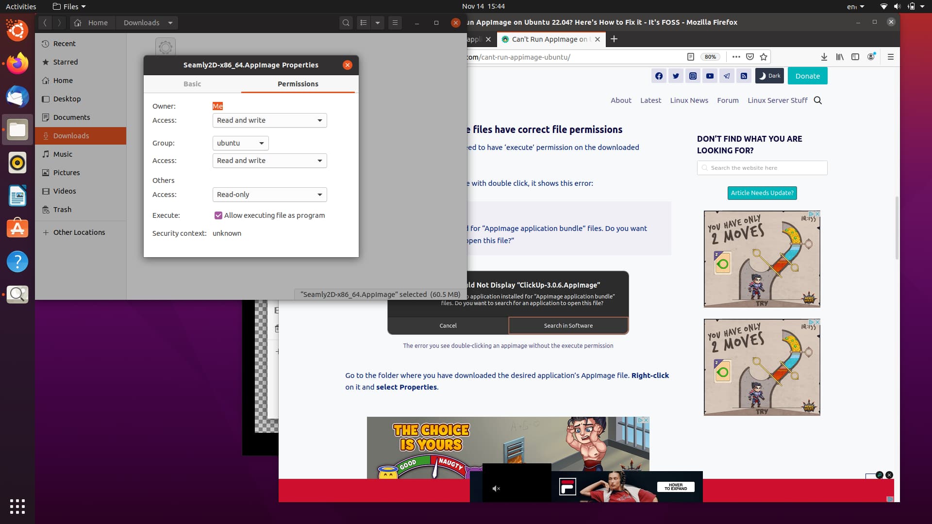

Hi everyone, [Try the latest AppImage, Veuillez essayer notre dernière version] !
Please try our latest build!
  1. After you download the file, you will need to right-click on the .appimage file, and set permissions to ‘Execute’.
  2. If the appimage can’t be displayed, install libfuse2:
    sudo apt install libfuse2
  3. There may be an error message that a filename isn’t specified when you open SeamlyMe, but click on ‘OK’ to move past the error message.
  4. The SeamlyMe diagrams aren’t displayed.
HTH!
