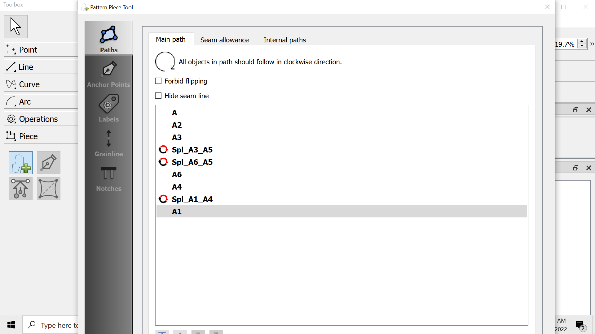

I just downloaded Seamly a couple of days ago and now I am trying to figure out how everything works! I successfully made my first draft and now I am trying to turn it into a pattern piece. However, after I successfully select all of my points and I hit enter, the pattern piece box/window pops up, but not the whole box. The screen cuts off the bottom portion of the box, so I cannot save my pattern piece. Is there a way that I can adjust the size of the box so that I can see the whole thing?
I tried to add a picture, but I don’t think the picture is downloading right. The top of the pattern piece window/box also does not give me any options for minimizing/maximizing the window. It only provides a cancel X in the top right corner.

I don’t have time for a full write-up at the moment, but in short the problem when this happens is likely that somewhere your display settings have everything sized up over 100%, probably somewhere in your OS Accessibility settings.

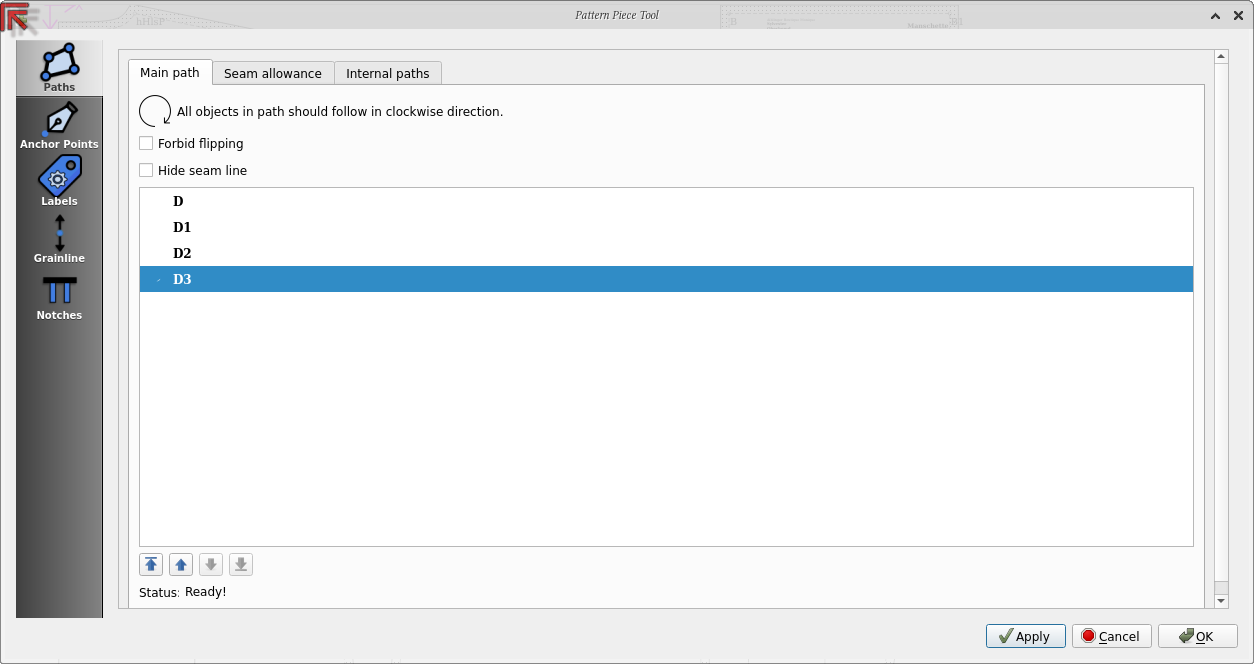

I just tried it, I can resize the window and move it. For moving the window I move the mouse pointer to the window bar, it becomes a cross. I then can move the window around.
For resizing I move the mouse pointer to an edge or a corner, it becomes a dart with a line or a dart with a corner like in the picture. If I hold the primary mouse key then, I can resize the window.
That is a good possibility. The dialog form probably has a minimum height policy set… which is fine for most display settings. For smaller resolution screen settings when viewed at 125% or 150% it could be an issue.

The only thing that I can do with the window is move it down (but I need it moved up so I can see the bottom). It won’t let me adjust the size or move it around any other way

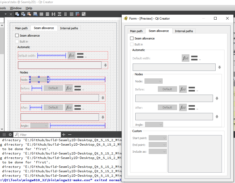

Don’t have to. By removing or setting the Minimum height policy to a smaller value - say 500, it should allow the Dialog window to resize automatically depending on screen resolution. That may mean that scroll bars get added to see all the contents - which I prefer to not see. A user shouldn’t haver to scroll in a dialog to find all the buttons / text boxes / etc. Also, the question would be “What” screen size? Everyone’s can be different.
That being said… yes, the dialog size could be programmatically sized based on the screen size VS being set in the form via Creator, but that adds more maintenance and defeats the purpose of the WSYWIG design of ui forms in Creator. In other words you can’t design and see what a form looks like unless you build and run the app. In the real world it’s most likely one team is coding while another is designing forms. For example… since I already have the form loaded - here’s a preview of the SA dialog:
I prefer to only add code for a form when it can’t be done in Creator.
