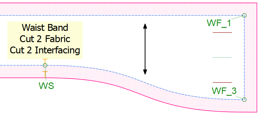

UPDATE: Got the internal paths separated into Internal paths and Cutouts (Cut on fabric). The solid pink and dashed green lines are internals.
internal_layout

Well I think I have finally deciphered the Rosetta Stone of the pattern pieces… that is the Work Piece AKA Seam Allowance AKA Pattern Piece tool. :slight_smile:
In a nutshell each pattern piece you see in piece mode is basically a QGraphicsItem… which can have among other things a Pen (foreground color), a Brush (background color) a (QPainter) Path (list of points), and most importantly be the parent of other QGraphicsItems. So each piece will have a grainline item, a notches item, 2 label items, the main path or “seam line” AKA m_seamAllowance, and internal path items (which can be cut or not), points, point names which are created as GraphicItems on the fly VS in the class constructor.
items
So you ask… where does the "seam allowance or “cut line” come from? Well… currently it’s computed from the main path and appended to the main path that is displayed as one QGraphicsItem - depending on whether you hide main path, or use “built in”. As you can see in the pics both the seam and cut line are the same pen color, linetype & linewidth… as they should be as they are the same graphics item.
piece
So what does this mean? I need to split the 2 paths into separate QGraphicsItems with the same piece as the parent. That way each item can then have it’s own pen. It also means since I understand the construct of the seam allowance I can now fix (in the future) another issue (or 2) related to the seam allowance. :slight_smile: Such as displaying the seam line when choosing the “built in” option - which we can’t do at the moment.
I do have one question if anyone has any input… that’s in regard to the seam allowance fill. Aside from other fill hatch style options… what color do we think the fill should be? The seam line color? The cut line color? or the tool (piece) color? Which for now is probably just going to be black (the default piece color) although I have ideas for being able to colorize and / or hatch pieces… maybe by fabric type, right wrong side, etc.
Got the display working in piece mode. Whoo hoo! This is how it looks with the “seam allowance” fill color set to the cut line color…
Also, set it so if the Seam allowance or the Built-in are unchecked, the cut line color is used for the main path instead of the seam color. In the future I’ll work on getting a seam line to display properly if the Seam Allowance AND Built-in are checked.
builtin
I checked the SVG and PDF exports, and they appear to be working properly. I do need to fix the DXF export(s) as they use custom functions… where everything is just black.

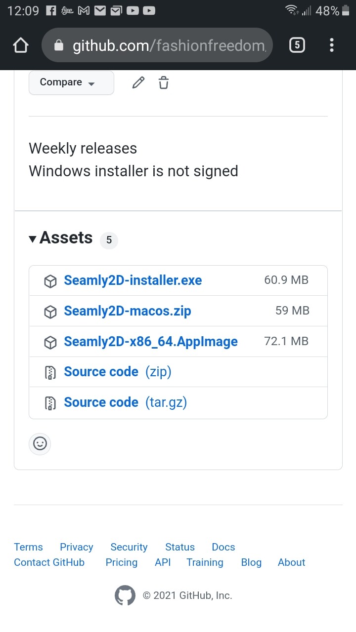

You need to download the asset for which ever OS you are using… installer.exe for Windows, the macos.zip for Mac, or the appimage for Linux. Then install as per OS.

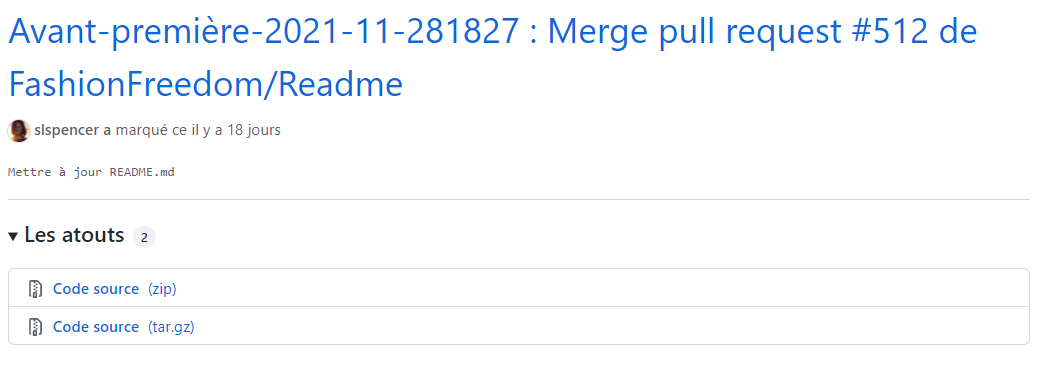

Merci pour la réponse, quand je clique sur le lien voilà la fenêtre que j’ai
si je clique sur les codes sources en zip voilà ce que j’ai image et donc je ne trouve aucun fichier d’installation. Jusqu’à présent je n’avais aucune difficulté mais là j’ai une colle, désolée de vous ennuyer avec ça. Bonne journée
