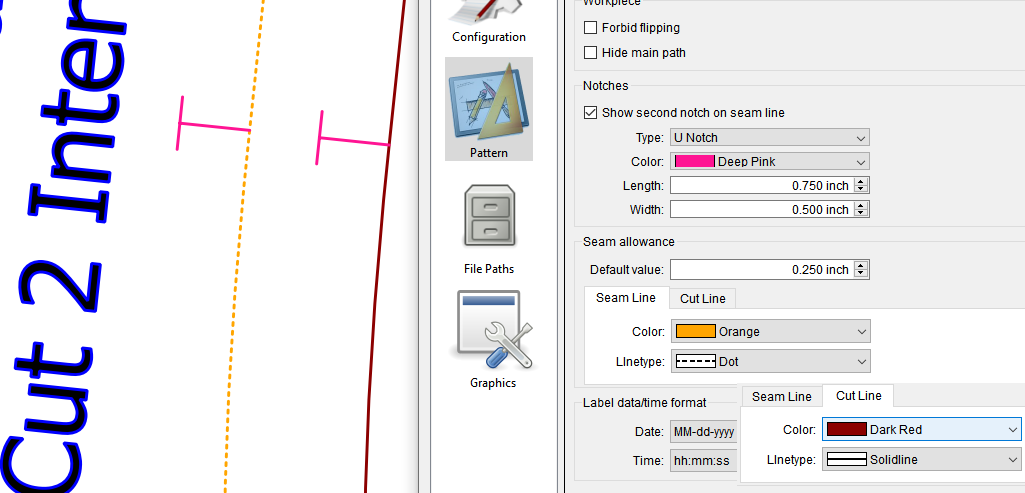

I started work yesterday on updating the Pattern preferences dialog… for now I’m just adding a color drop down for notches, and adding Seam & Cut line drop downs for color and linetype.Oddly the “internal” paths have their own class with a linetype used in the piece & layout… so I could add a color drop down here:

Prefs for the notch color, seam line & cut line color | linetype working. For now I put the seam line & cut line attributes in a Tab widget to save space.
This looks awesome!!
Cant wait to use it :smiley: will it also possible to change the stroke width of cutting and seamline? Thank you so much for your work !
We could do that… a pen has 3 basic attributes - color, line type, and line width. There’s a few others, but not as important. Currently the app uses just “hairline” as the width, or basically the minimum width. I can easily add the width to the piece and layout (and any subsequent print / export) modes.
