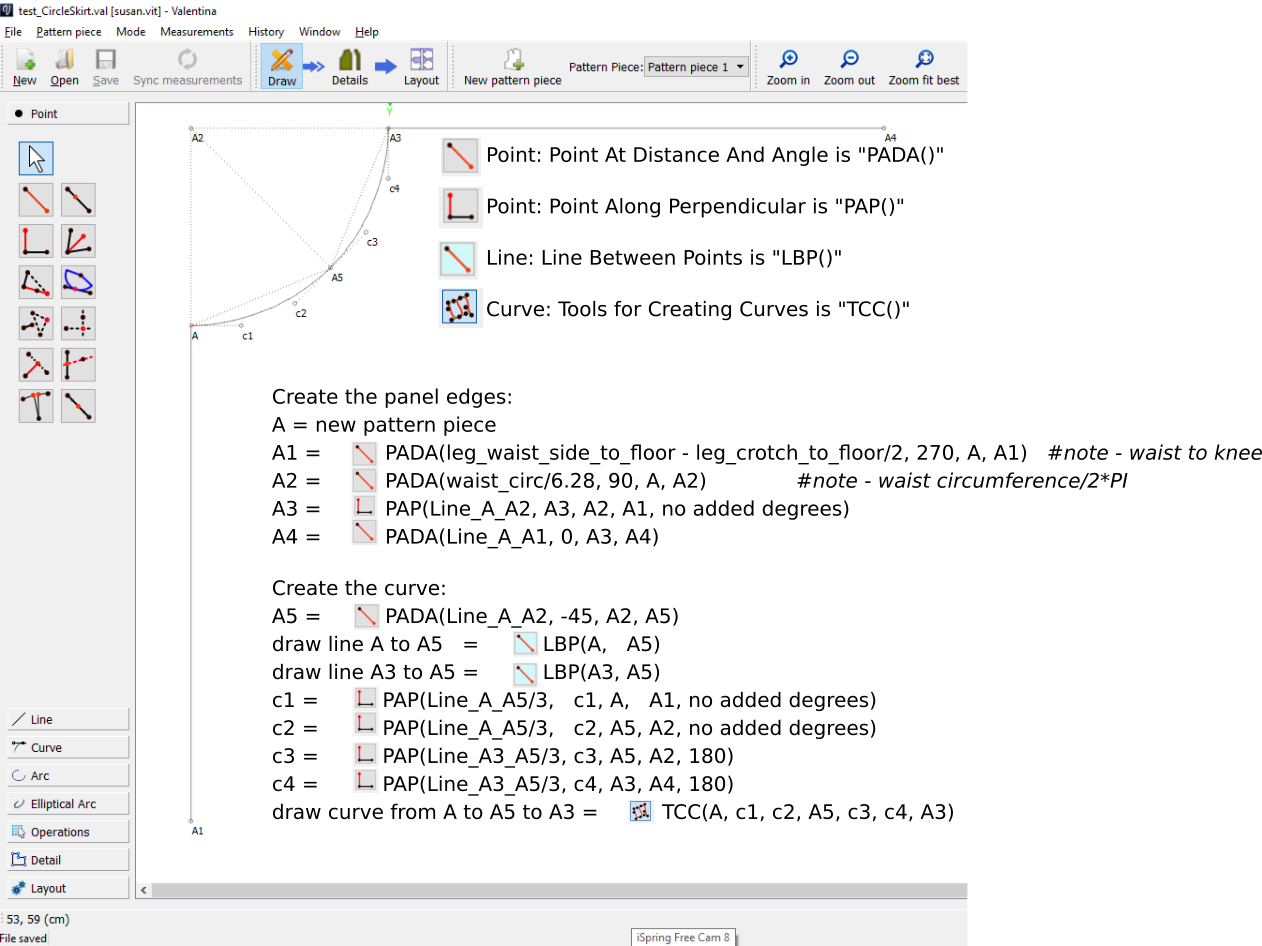

To create a circle skirt you’ll need the radius of a circle where the diameter is your waist circumference.
diameter = 2Piradius waist circumference (waist_circ in Valentina) = 23.14radius = 6.28*radius radius = waist_circ/6.28
This circle skirt is completely resizable because it uses control handles for the curves, and doesn’t use any absolute numbers except Pi.
The curve’s control handles are 1/3 the length of the line between the curve’s segment end points, and they are perpendicular to the lines at the curve’s segment end points.
This image shortens the skirt length to better show the labels. Click on the image to enlarge:
Create the hem curve similar to the waist curve. This image shows correct waist to knee measurement:

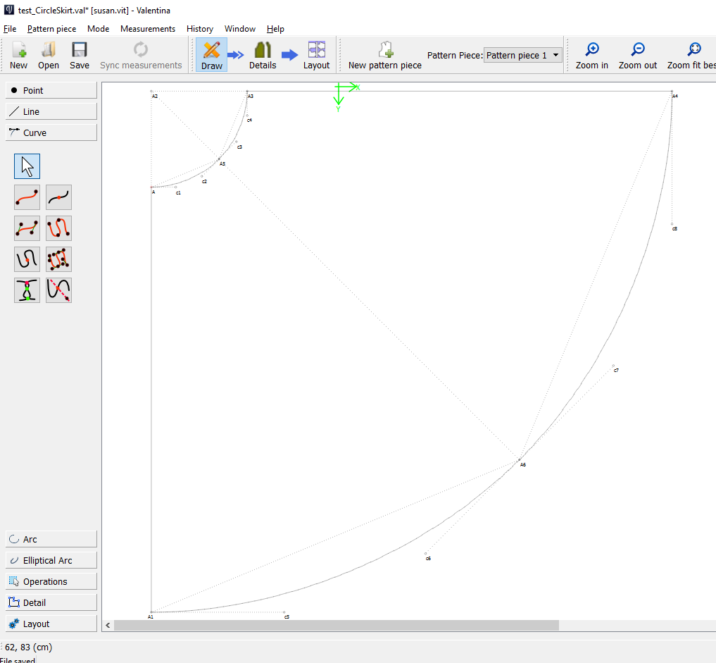

@definitalie That’s why I didn’t post the *.val & *.vit, instead I posted the instructions. Re-sizable curves require understanding that only comes from creating them.
A true circle using Bezier curves can’t be created in quarters. Each quarter must be divided in two. The control handles are 1/3 distance of the lines drawn from from begin to middle, (1st section) and from middle to end (2nd section).
So each panel of the circle skirt is a quarter of a circle, divided in the middle. And @definatalie you could change the direction of the hem curve to A4-A6-A1 so that you won’t need to reverse the hem curve direction when you create the detail seamline (so that the entire seamline flows in a clockwise direction).

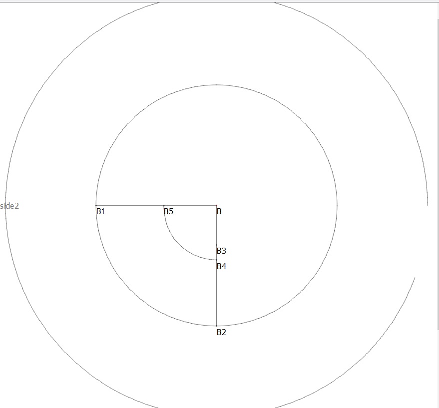

I know what she meant but I don’t quite understand the instruction. I tried to make the pattern from hip circumference but how can I determine the waistline? If I added it by the same formula, isn’t that turned out to be the same with if I make the pattern from waist circumference? Here is my pattern:
circle skirt from hip
B1 is hip side, B2 is hip back. I used Hip circumference/6.28 formula. B3 is waist back (calculated by the same formula with how I get hip radius), B4 is also waist back (if using hip length from waist back; say 19cm), B5 is waist side (using hip length from waist side; 19.5cm). From the picture, if I join the B4 and B5, the waist circumference is too small. But if I used B3 as waistline, what is the difference with using waist circumference formula from the start? Also, the skirt length would be too short. Maybe you could explain what I do wrong?
Edit: I add the hiplength into the formula for hipline (hip circ/6.28+hip length from waistline). Is this the way to do it?
Btw, I compare the circle skirt made from hip circ and the usual skirt, it seems the new skirt is slightly bigger.

It looks like concentric circles to me, that is not what @Sue describes. What is your B3, isn’t that the point hip-waist in the front? Than there should be a curve B5-B3. It looks to me as if you had an arc B5-B4.
@Sue: do you mean the skirt would have a stitches to join the circle skirt (from hip) and the regular fitted piece from waist-hip? So it’s going to be have three pattern pieces (front fitted waist-hip, back fitted waist-hip and circle skirt from hip)? Something like this?
semi mermaid skirt
@moniaqua: B3 is waist back according to waist circ/6.28 formula (measured from B point). B4 is waist back if I measure it using waist-hip length from hip line (B2 point).
