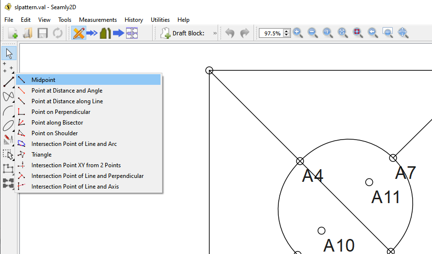

I propose changing the “Add Details” page tab to “Add Piece”, and the “Pattern Piece” to “Details”… reason being you add a (Pattern) Piece from the draft mode, and you add details to a (Pattern) Piece in piece mode. Yes I now that technically add an internal path could be considered a “detail”, but this is one of the idiosyncrasies of the application that you can’t add one in Piece mode. Also keep in mind that the Piece mode → “Details” page will also be populated with other tools such as Text, Symbols, and Buttonholes.

Well… If you refer to the pic I previously posted, that’s exactly what I did… draft mode looses 2 tab pages, and Piece & Layout modes have only 1 tab page each. BTW… the toolbar “down the side” is a Dock… similar to a toolbar widget, but with different properties. I only say this because you can move “toolbars” to the side like:
dock2
And if you want to get rid of the clutter… toggle off all the tool toolbars and the Toolbox dock except the Toolbox toolbar:
