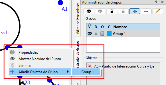

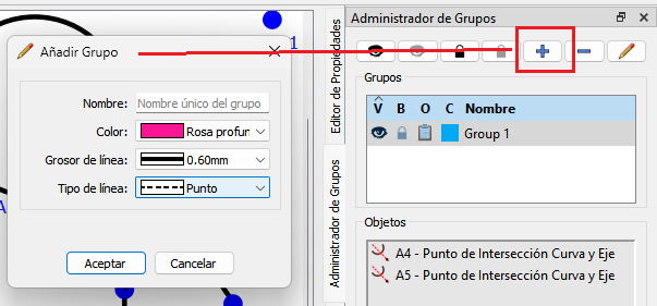

The easiest way is by clicking the + to add a group in the Group Manager. You can then name the group and assign it a color, line type, and line weight.
You can later delete or edit a Group by selecting it, and clicking on the delete or edit icon in the Group toolbar or by using the group item context menu.
Then by using the right mouse button context menu on the object you want to add, you can select which group to add it to.
The object will then show up in the Objects window when you click on it’s group.

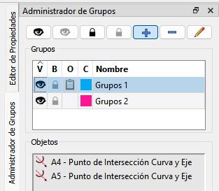

So here Group 1 has 2 objects - Points A4 and A5… while Group 2 has no objects yet as indicated by an empty icon on the “Object” column.

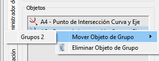

Then if you want to move or delete an object by using the right mouse button context menu… here I selected Move to Group 2:

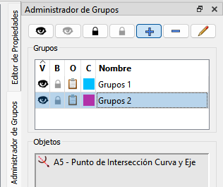

and now Point A5 is on Group 2:
