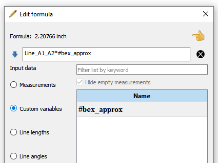

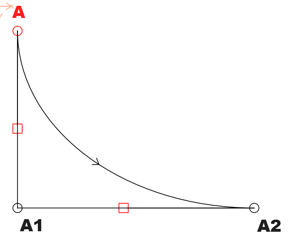

The other factor that determines how smooth a curve flows is the length of the control points. Not only is this important in just drafting a single pattern, it’s essential to change the length of the control points with the measurements. That’s where you will see users defining the length of the control point by some formula of length * a factor. It’s easier to look at curves within a triangle… with the control points along each leg and the curve along the hypotenuse… like:

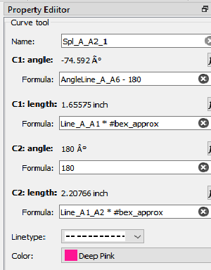

Where the length of the the control point at A = the length of Line_A_A1 * factor and the length of the control point at A2 = Line_A1_A2 * factor.

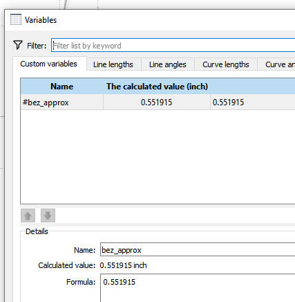

So just what is the value of the factor? Well without getting into the math it’s an approx for bezier curves and can be defined as 0.551915. So in other words the length of control point A = Line_A_A1 * 0.551915… so basically 55% or a little over 1/2 the length. So again, what this accomplishes is a smooth transition for whatever is before and after this curve, and regardless of the “size” it will always be proportional.
Something that I do is put the bezier factor into a variable in the “variables table” so it makes it clearer WHAT the factor is for.
So now the formulas become:

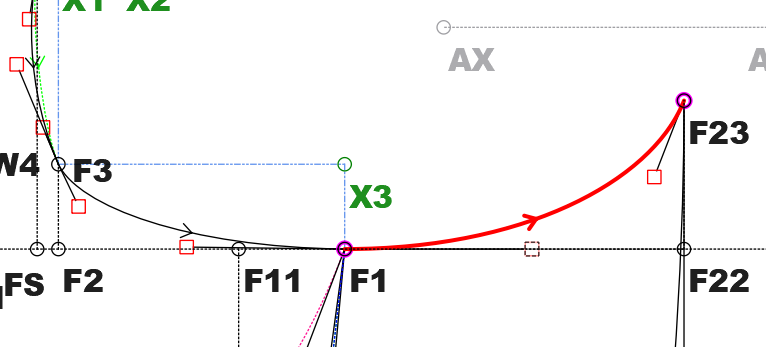

You may then be wondering well how would all this apply if you need to find those triangle leg lengths. if they not given? Well then you have to add points to allow you to have access to the line lengths as illustrated here:
Here you can see I needed a lengths for the curve between F3 and F1… so I added the point X3. Now I have access to Line_F3_X3 and Line_F1_X3 and the control point lengths become Line_F3_X3 * #bez_approx and Line_F1_X3 * #bez_approx. BTW… I could have just added lines F3 - F2 and F1 - F2… but I find it gets messy with over lapping lines.
Just another note… as you will run into this issue at some point - you need to define any lines you need BEFORE creating the curve as you can only access tools that have created BEFORE the current tool.

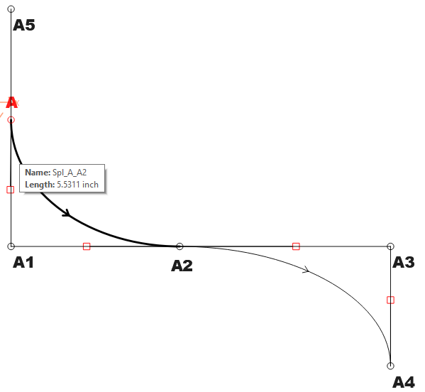

I added another curve to illustrate how one curve transitions into another:
curve.val (1.9 KB)
So what you should get is a smooth transition from A5 to A4. `

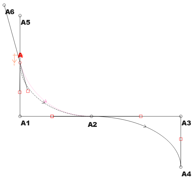

And Here’s an example of using the angle of Line_A_A6 to set the angle of the control point to smoothly transition from a new (pink) curve into Line_A_A6:
Note the subtraction of 180 degrees to the angle… this is flip the control point direction as if the line was actually Line_A6_A… if that makes sense.
3curves.val (2.3 KB)

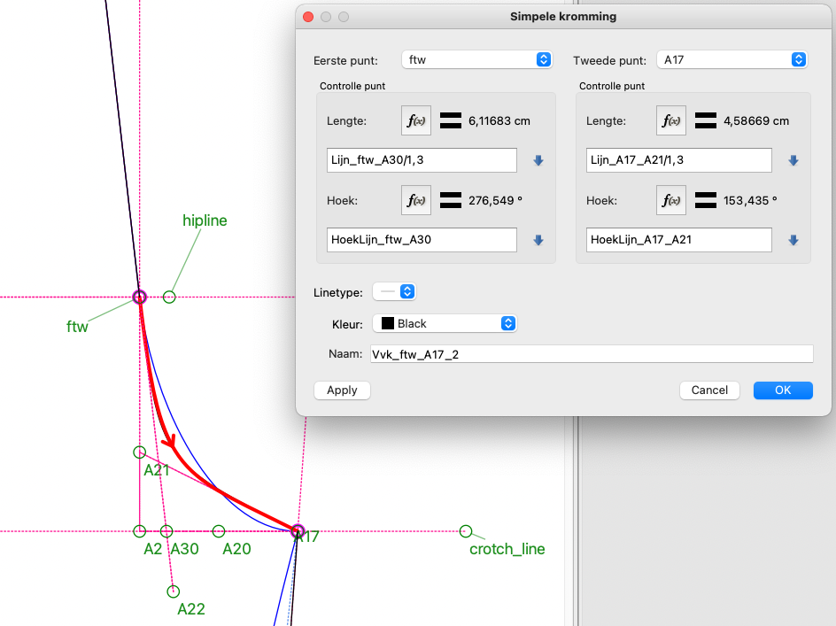

Since my pattern shows a different crotch curve than the one Grace made I tried to adapt it to the instructions. Does this look like it works (like you explained) and should scale? (Grace = blue, me = red)
Is there a difference as to why I would use the line going up + 180 or the line going down as it is? (see picture 1 and 2) Since both give the same end result?

Because they’re not the same line (segment)… even if they’re along the same axis. The start and end points matter, as it determines whether you’re going clockwise or counterclockwise. Does it matter… no as like you said the result is the same. For me though I tend to think in terms of the line and curve going in the same direction… thus I’d go with the angle + 180.
I used the line above as the angle of the 1st curve handle to create a smooth transition from the line into the curve. & then I used the line between the start node (of the curve) divided by 2 (or you can use *.55 for accuracy) to form the start of the curve.
The 2nd handle, I used the line A17 to A2 for the angle of the handle. The reason is that this curve will connect to the back of the trouser curve, so one needs to create a continuous transition from front to back, so by using this line, I would also use the corresponding line on the back panel. and then used the length of that same line divided by 2.

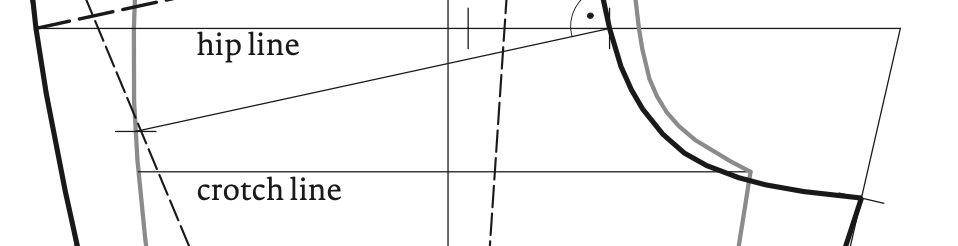

Thanks for the added advice and suggestions, I just keep tinkering away :slight_smile: It look me a while to figure out what you meant with a smooth transition between front and back. But than I thought you might mean the ‘meeting of angles’.
But the pattern shows this kind of transition. So the angles seem to be doing something different than what you’re proposing. I’ll try and sew it together somewhere this week to see how things compare. I’ll be back! haha
As someone who has more experience with origami than with pattern drafting, I get the impression that the crotch-point in this pattern is supposed to have a slightly angular join, like a paper bag.

Just looking at the front & back crotch, those in the image can work once the seam allowance is added when you do the Details.
I moved the blue line to the Waist 2 line & made slight adjustments to the curves:
I think it compares better with your image now.
