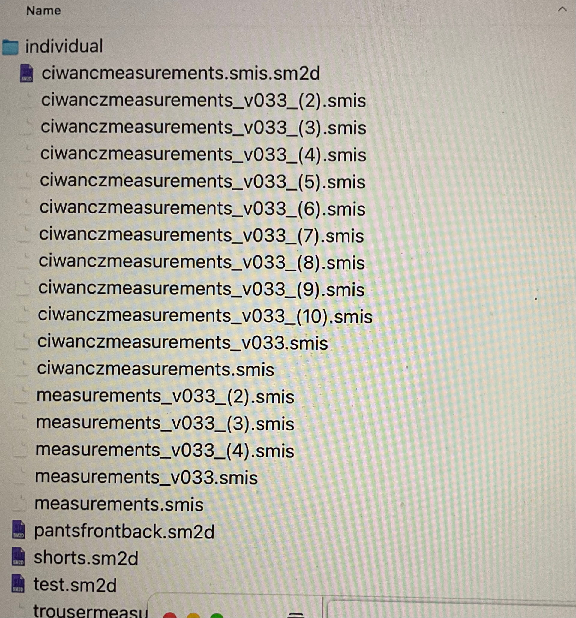

I am really confused when opening a measurment file for a pattern I have been working on. When the files folder for individual measurments is opened there can be upto ten or more files with the same name except for a perenthesis with increasing numbers. example(1>), this number goes up on every file, which one do I open the first or the highest numbered file and Is it safe to delete all earlier numbered files. W
hen I do a save is that when a new file is created
1 curtida
If you change the view mode in your file explorer so that it shows details, then you can look at the file creation/modified time & date, and you’ll be able to easily see which are the newest.
The highest number is normally the most recent save. However, they’re probably all the same and come about by opening the original file, Ciwanczmeasurements.smis and not the Ciwanczmeasurements_v033.smis, which has been converted to the latest version.
@Douglas, please correct me if this is not so.
Thank you, now I know its safe to delete all earlier ones. I was concerned I was picking the wrong file and not being able to edit the pattern. In preferences I have the measurment files in my full name directory, ChristineIwancz why its abreviated the file name I don’t know unless the directory is still around when i first downloaded an earlier version of the program. I can’t find it anywhere hereI on my Mac.
1 curtida

Hi Saphire… the extra files with the v33(x) extensions are backup files. v33 being the schema version format of the measurment files. Since we recently updated the schema to ver 034 to change the vit and vst tags to smis and smms, when ever and old ver file is loaded - which is in ver 033 format it creates the backup files. This applies to pattern files as well.

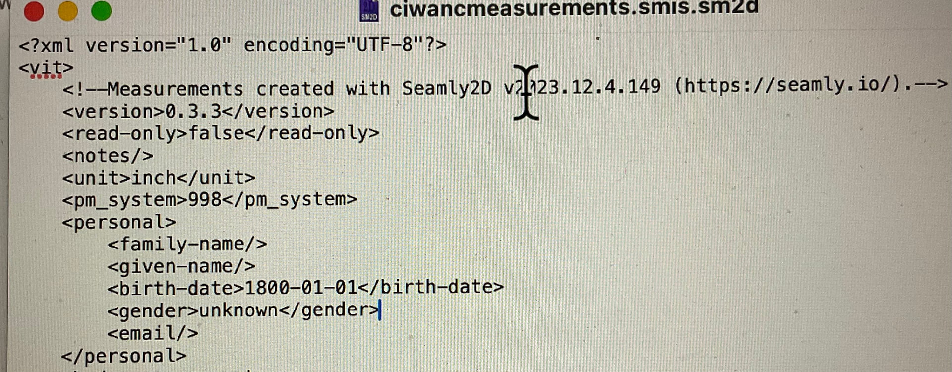

If you open the file in a text editor the old format reads as:
<?xml version="1.0" encoding="UTF-8"?>
<vit>
    <!--Measurements created with Seamly2D (https://seamly.io/).-->
    <version>0.3.3</version>
while the new format reads as:
<smis>
    <version>0.3.4</version>
To eliminate the backup files you just need to load the orginal measurement file into SeamlyMe, and Save it (more specifically Save As the same name assuming you haven’t made changes). This will save it as ver 034 and stop the backup files. You might get a message saying you’re saving as a new format… that’s perfectly OK to do so. Especially since you already have multiple backup copies. :slight_smile:

Here is the open file

Yup. Just open it in SeamlyMe and it resave… it will update to smis and ver 0.3.4, and the backups will stop. At least until we update to v0.3.5 - wheneve that may be. :slight_smile:
