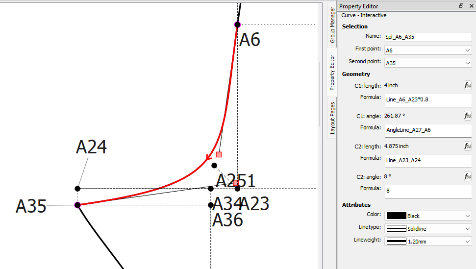

The warnings are being thrown as the Property editor tries to build the first and second point drop down boxes. No error here on my end running the current release Windows build downloaded from Github:

ok. i just went back into the file. when i click on curves no error until i go to ‘piece’ and then come back to the draft mode then the error happens when i click on any curve.
2 tykkäystä
Aha. Now we are getting somewhere… I got a report of a similar issue… but only after changes were made to a patten piece, then going back to draft mode.
And Bingo… I just repeated the error.
For now, what I found avoids the issue is if after making changes in Piece mode, and going back to Draft mode, is to undo, then redo. I’m not sure if this is resetting the increment count, or if it’s forcing a reparse of the pattern? Obviously to fix this is my priority.

The other option for now is to disregard the Property editor and use the Tool dialogs… which don’t use the history to generate the combobox items. BTW… you can probably confirm we’re dealing with the same issue. If you go to Piece mode, change something like just moving a piece, go back to Draft mode… then open the HIstory - it will probably crash.

Just a note… I have figured out what the problem is… just need to figure out exactly where the problem is so I can fix it. Until then you can work around the problem by switching draft blocks and back to one you want. The issue only appears when there is more than 1 draft block, which is why it took awhile to figure out what was going on as I was only ever testing with 1 block and I never got the warning errors.

Yes. I’m pretty sure of that. Not sure why Susan could not reproduce the error right away earlier… might have to do with the fact it only happens when you load a pattern (with more than 1 block) and haven’t added any blocks… or maybe not starting the app fresh.
