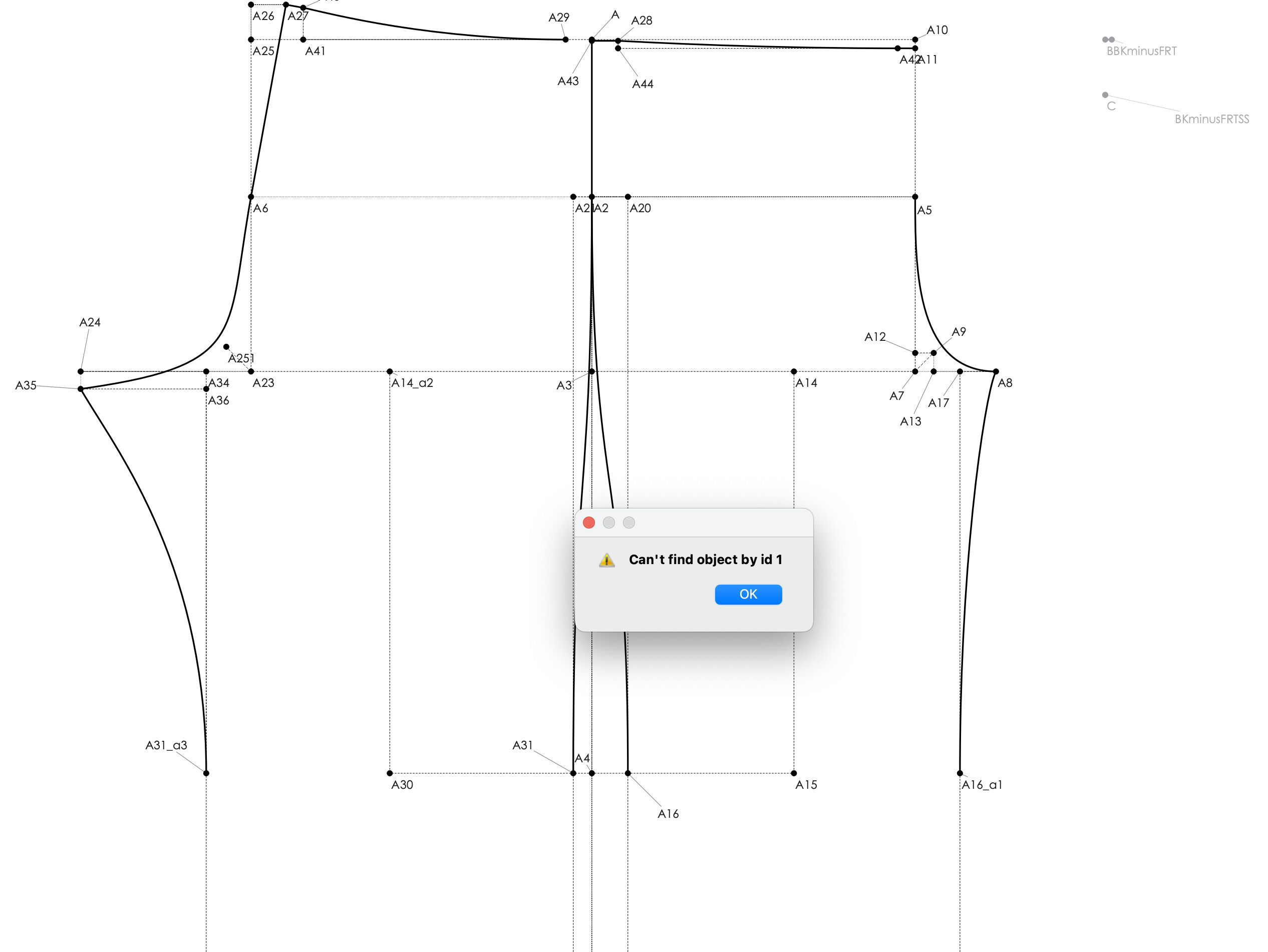

I keep getting these error messages. luckily closing out of the file and going back in makes it so i can continue working.

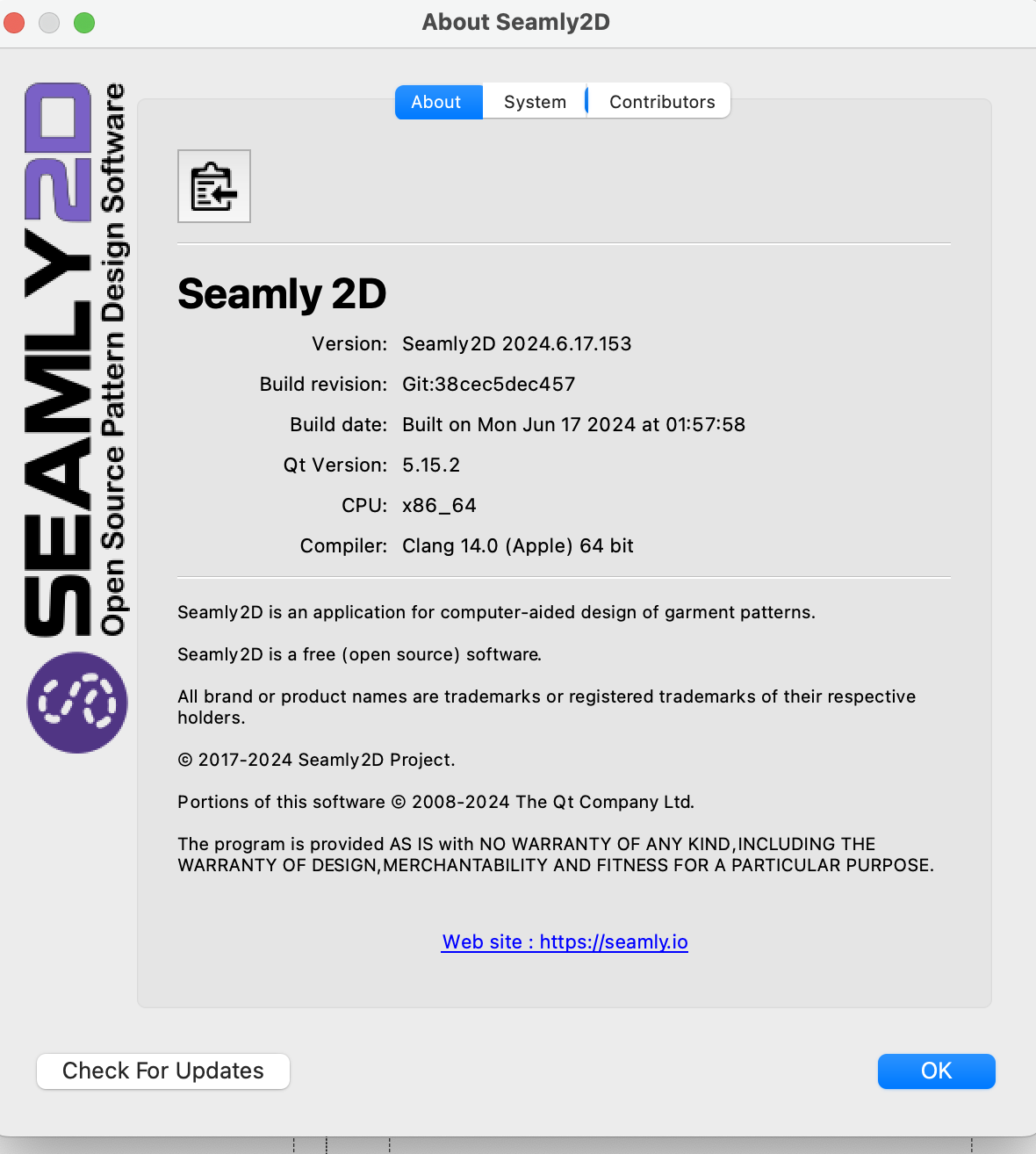

Could you post which build ver you are using? You can goto the Help->AboutSeamly2D and click the Copy to Clipboard and just paste the system info here.
Screenshot 2025-01-10 034624

I really do think you should click the “Check for Updates” button in the bottom left corner & let it download. Once the update has downloaded, it will open up in the Explorer. Close Seamly and double click on the Seamly EXE file and install the latest update.
The version of Seamly that you’re working on is already over 6 months old and a lot of things have been repaired since then, which is probably why @Douglas & I aren’t getting any errors when we open your pattern.

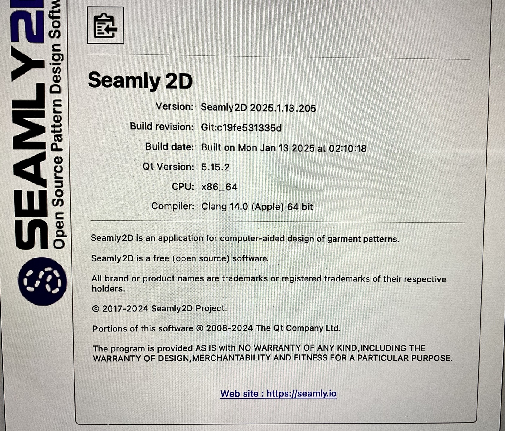

weird thing is that i thought i did the update but it must not have worked. just tried again.
2 tykkäystä

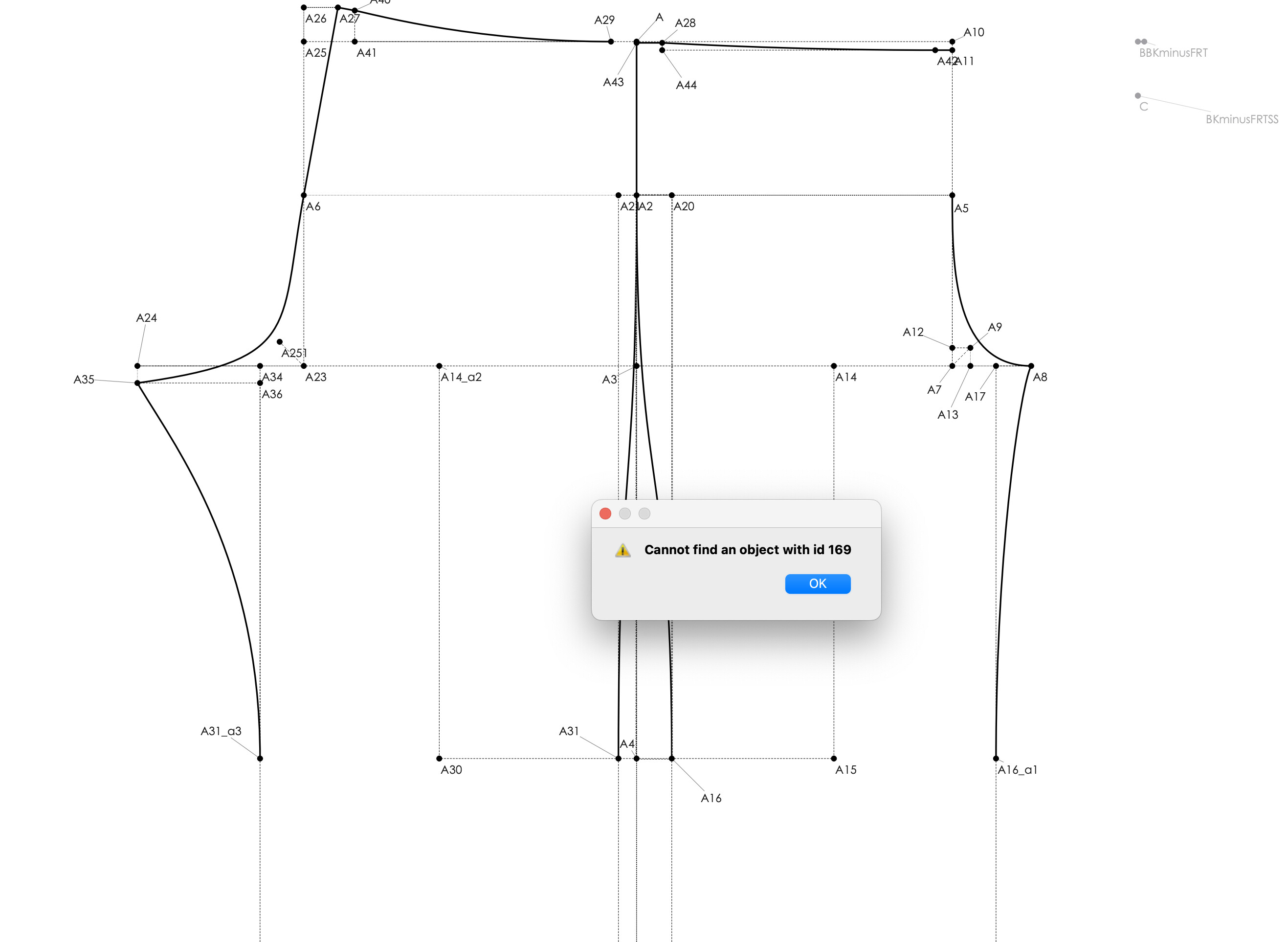

just updated and just got this message again.

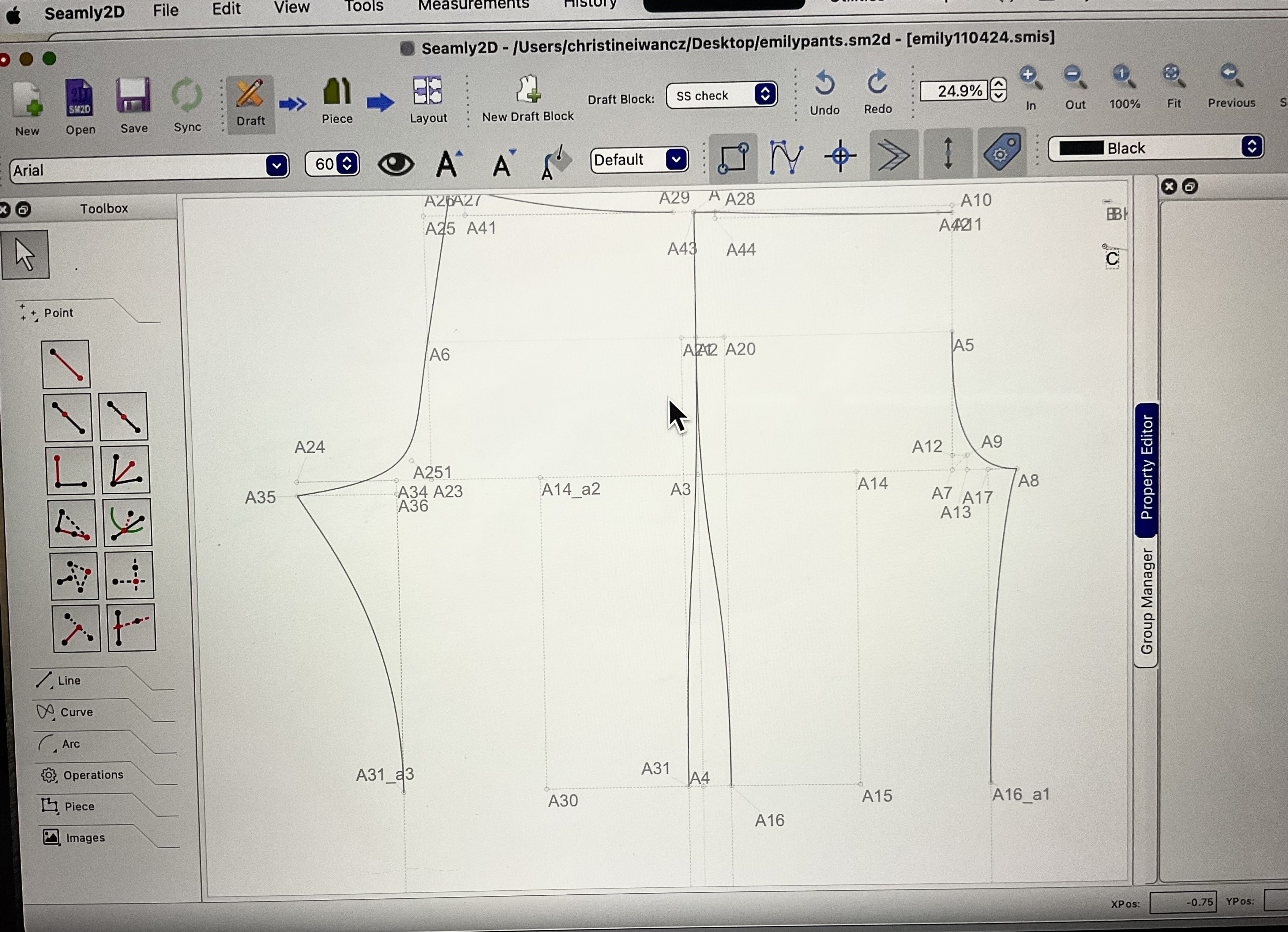

I use a an M1 mac air would you like me to download both files to see if I get the error.
2 tykkäystä
Hi, @Saphire
It would be interesting to know if you do, since both @Douglas & I work on Windows.
2 tykkäystä
Yes Please. :slight_smile: We ned to determine if it’s the Mac ver of the app that has an issue or if it’s that particular pattern file.
In either case I’m a bit confused as there’s no issue with the pattern file loading in the Window ver, and @emilyli apparently is having an issue with either the release for last Jun and the current release.
2 tykkäystä
There were no errors on last version upgraded to this weeks ver and still no errors Hope it helps

Aaaahhh… I think I’ve found something… I clicked on the curve A6_A35 and got this error:
Clicked on OK & got this error:
Clicked on OK & everything’s fine.
So it could have something to do with that curve.
