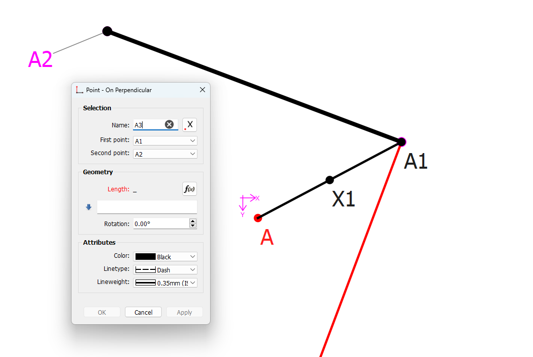

Since the modification is not very complex I decided to code an “automatic construction point labelling” button in the dialogs of the following tools : End Line, On Line, Midpoint, Perpendicular, Bissector, Length To Line and Intersect Arc and Line. I don’t know if this is a problem that other people are facing or if there maybe is already a functionnality in the software that could be used to make the creation of “construction points” easier, I’m thus creating this post :blush:

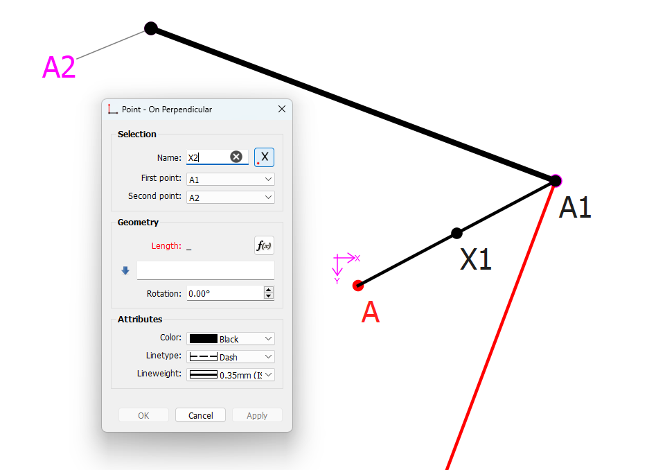

When the button is clicked, it fills the name with the next available “X” point, it is thus really simple to keep the original pattern numbering of the method used while using construction points.
Before clicking:
After clicking the button:
