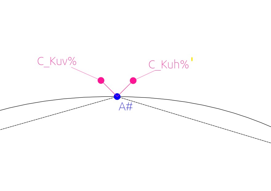

Sorry that I bother again. for example as I want to check the curve length of the sleeve with the armhole length. it is possible to calculate in the variable table. It works with the curve length once. As soon I do a refresh i get zero. Right now I have to add added control points. No clue if it just with multisize mea. Right now this is what I do

I hide a little calculation in a line on the sleeve to check this, so that it’s not totally taking up space in the pattern drafting, that I can check easily:
