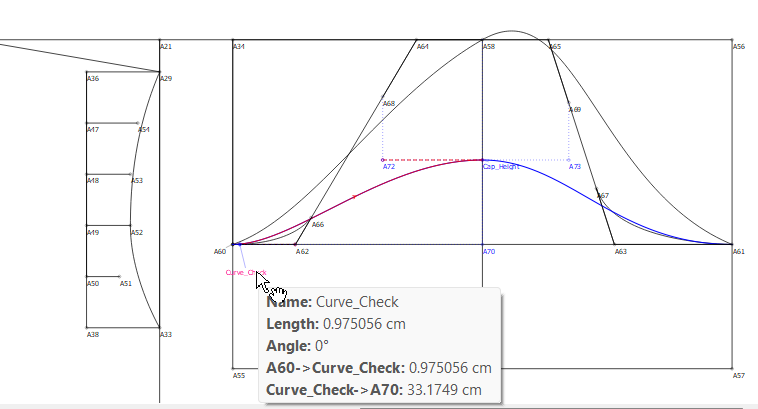

Now I fixed this pattern. It was far from right on the first post.
I expressed the control points as variables. I did not try Grading yet but I hope It will be in shape.

I’ve had a look at your pattern and this is what I’d like to explain:
  1. The cap height is best calculated in relation to the armhole height.
  2. The cap width must always fit the biceps.
  3. If you make the cap height higher, then the width must be less and if you make the cap height lower, then the width must be more.
  4. The cap height must always be in proportion to the armhole curve. If the armhole curve is only slight, then the cap height is also slight, if the armhole curve is pronounced, then the cap height is also pronounced.
With all of this in mind, I have changed the cap width formulas - I added *2 to the formulas you had - and added a new point with a formula for the cap height which is based on the average armhole height.
I’ve redrawn the curves.
Since you have a very fixed cap width, I have adjusted only the cap height to get a very shallow sleeve cap that should suit your very shallow armholes, leaving less than 1cm difference between the armholes curves and the cap curve as you can see in the image:
Here is your pattern back:
