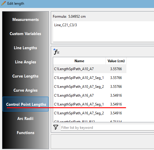

Hello, @MG2024
I just want to mention that the curve handle lengths are in the Control Point section of the Formula Wizard:
I hope this helps you.

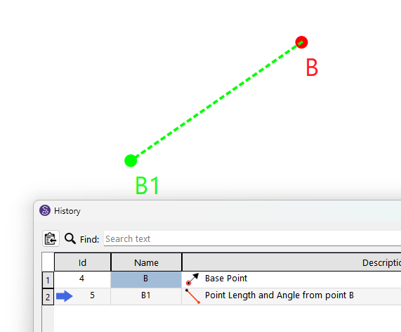

I assume you mean to “anchor” the B block to point A34, so that if A34 moves, so does the B Block? Easier said than done. Currently the app does not provide access to point data across blocks. For ex… here the B block can not see the points in the A block:

Oops, thanks This option was not available on my mental screen.

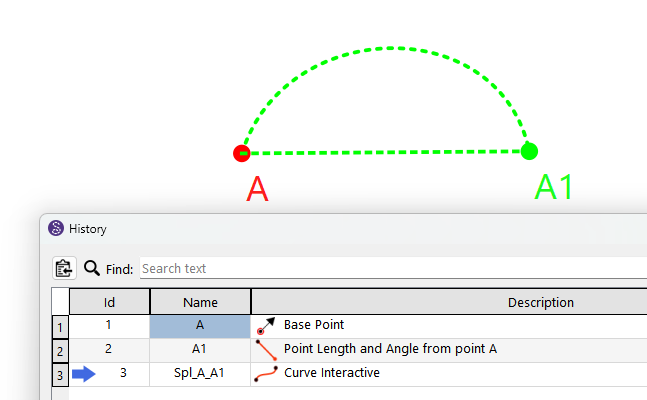

Correct. Seamly’s Law #1 - Points are only accessible to points created later in the same block - i.e.The History. For ex:
Block B does not contain point A1, so it can’t reference it. Trying to do so will throw an exception such as above. In fact that’s what I did to cause the above error… I changed the basepoint of B1 from B to A1 in my editor.
