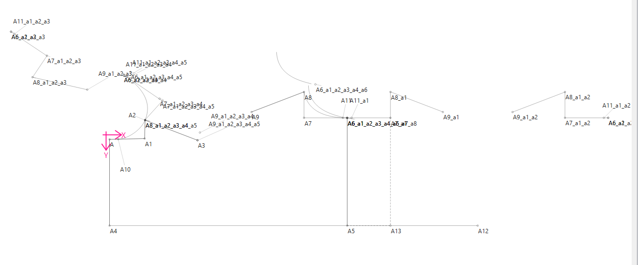

So this on what I’ve been working…

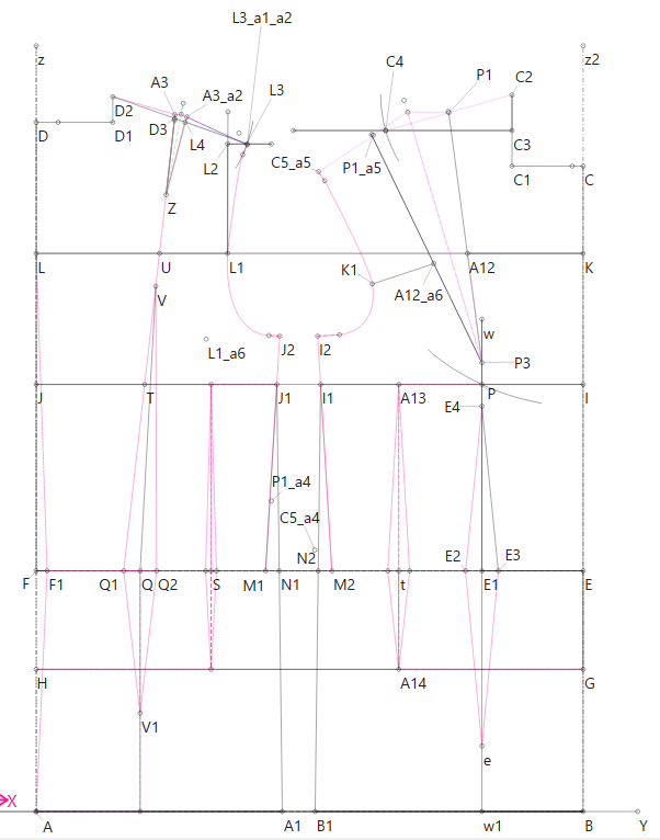

And this a test I made to manage to connect the neckline :

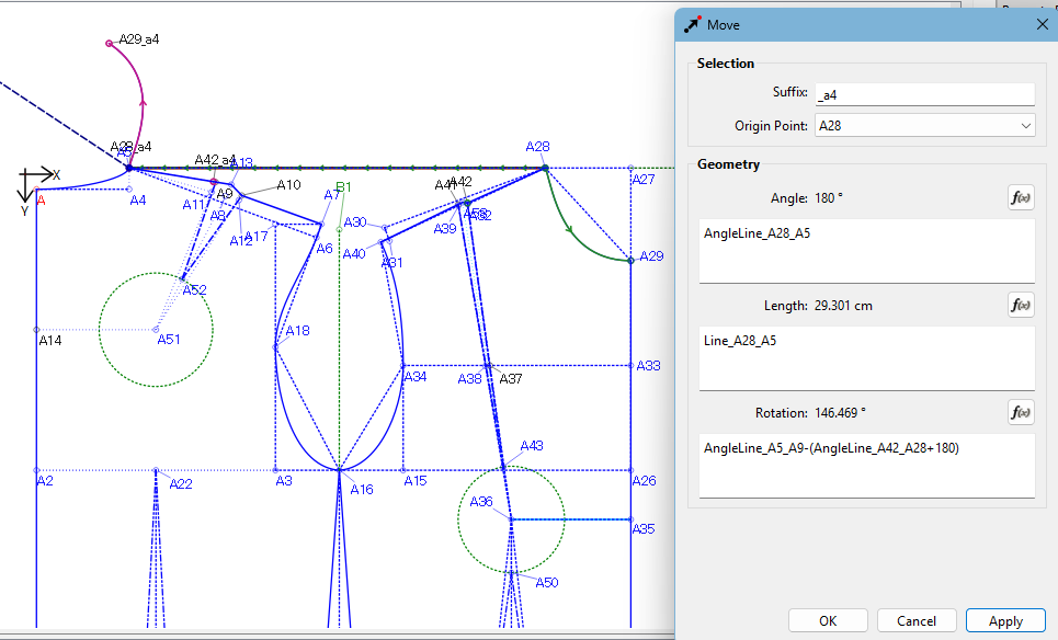

The best tool to use is the Move tool:
Before you use it, complete your neck and armhole curves & place a line from the Front High Point Shoulder (C2) o the Back High Point Shoulder (D2) (because these are the 2 points that you want to join together).
Pick up the Move tool and, while holding the CTRL/CMMD key, select the neck front point, the neck front curve, the high point shoulder point and the point at the start of the shoulder dart (C, curve, C2, P1) - make sure that they have ‘walking ants’ (dotted lines) around each one - and hit Enter. Move and rotate the selection anywhere and hit Enter again.
In the property editor box that comes up, change the Point of Origin to the point at the start of the line you created before (C2). In the Angle box, enter the angle of the line previously created (C2_D2) and in the Length box, enter the length of this same line.
In the Rotation box, enter the angle of the back shoulder slope (D2_D3) minus the front shoulder slope (C2_P1) and hit Apply to check that everything is correct. If one of the lines are going the other way, add or subtract 180°. When everything is correct, hit OK.

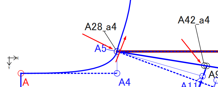

If your curve needs tweaking, tweak the original curves until the moved curves line up:
Here you can see a close up of my move where the 2 neck points match exactly the shoulder lines match exactly and I’ve tweaked the back neck curve so that the 2 curves run into each other with a straight line:
