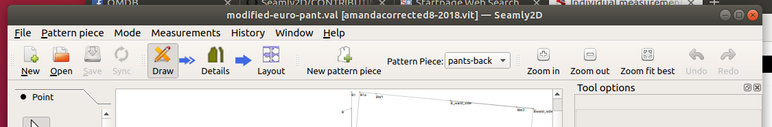

If you look at the top of the window (see screenshot) you will see the name of the .vit file in use. The way to avoid changing the .VIT file is to make a copy of it before you start.
In my example, the name of the measurement file is amandacorrected8-2018.vit
I started with the file amanda.vit and made a copy before using it.
