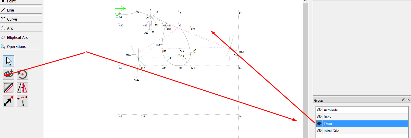

Hi, @CoudMode
Unfortunately, as far as I know, you can’t do this in Valentina yet.
What I would do is to make a group of the front piece. That way, I’d have that all in one place where I can turn it invisible if it gets distracting to me. Then I’d make the back piece on top or next to the front piece. That way, I’d be able to access all the points of the front piece.

Hi,
i tried this way ans it’s a good solution. Thanks !

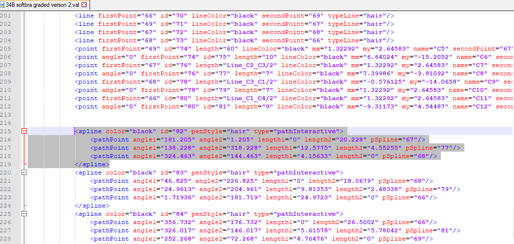

Aaaaactually, if you open up the ‘.val’ file in Notepad++, you can do all kinds of things. (Most of which will fail unless you understand how XML files work.)
notepad ++ may work, but if you have an editor that is aware of XML syntax and highlights in color it is MUCH easier.
It is. You just need to click through Settings|Style Configurator|XML, enter ‘vit val’ in ‘User ext.’, then click ‘Save & Close’ to let it know that Val’s files are XML.

Please, make a copy before opening a .val file in a text editor. There are a few sad posts on this forum where someone hacked their pattern file in a text editor and created errors, then couldn’t get it back.
OH, LORDY, YES! Always make a backup before doing something ‘adventurous’. I ‘save as’ and add an exclamation mark to the beginning of my file name to mark that it is one.
Yeah… changing things like a color or cm to inch is one thing… deleting or adding stuff is probably going to fail with some error blah blah id=xxx not found. It can be like messing up a < table > in HTML. :slight_smile:

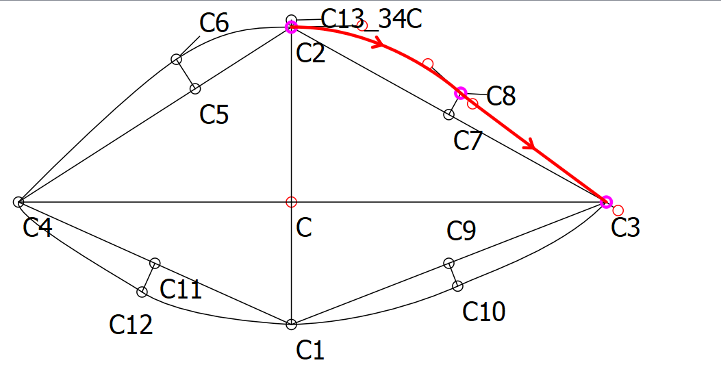

I don’t “know” xml but I opened a test val pattern and it seems pretty straight forward. So keeping on this topic about copying one pattern piece to a second pattern piece via the xml file I have a few questions. A) can this be done in Seamly yet or no? B) if not does XML have global and local variables? C) if so would it not be an idea to have the id’s be local vs global variables?
The first error I got was the the id was not unique so I went and found another .val file that already had multiple pattern pieces to see how it was laid out and how each pattern piece starts with the next id after the last one on the pattern piece. Could it not be made to start each pattern piece at 1? I can handle the find and replace of A to B, but trying to keep focus long enough to edit the ids properly… haha not likely, it would be quicker to redraw the pattern :wink:
How do I copy a line in notepad++? I successfully changed the color from pink to black but do not know how to make a duplicate line. I am familiar with basic HTML.
As you can see, each item has an ‘id=##’, so you will need to create an item using the same tool in Seamly, then drag it to where you want it in the program and then paste the values part over the code there. DON’T FORGET TO SAVE TO A DIFFERENT FILE NAME BEFORE ATTEMPTING TO DO THIS!!!
But… excuse me for asking… why would you want a line exactly over another line? Since you can use the existing line or curve over & over again in many pattern parts?
