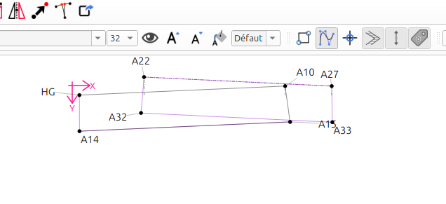

I’ve drawn a pants pattern with a waistband at the front and back on the rough draft.
I’d like to have the two pieces placed end to end so I can generate the pattern piece. I haven’t found a copy-paste function with rotation to make this change. Does anyone have a tip?
This is an isolated group of the complete design.

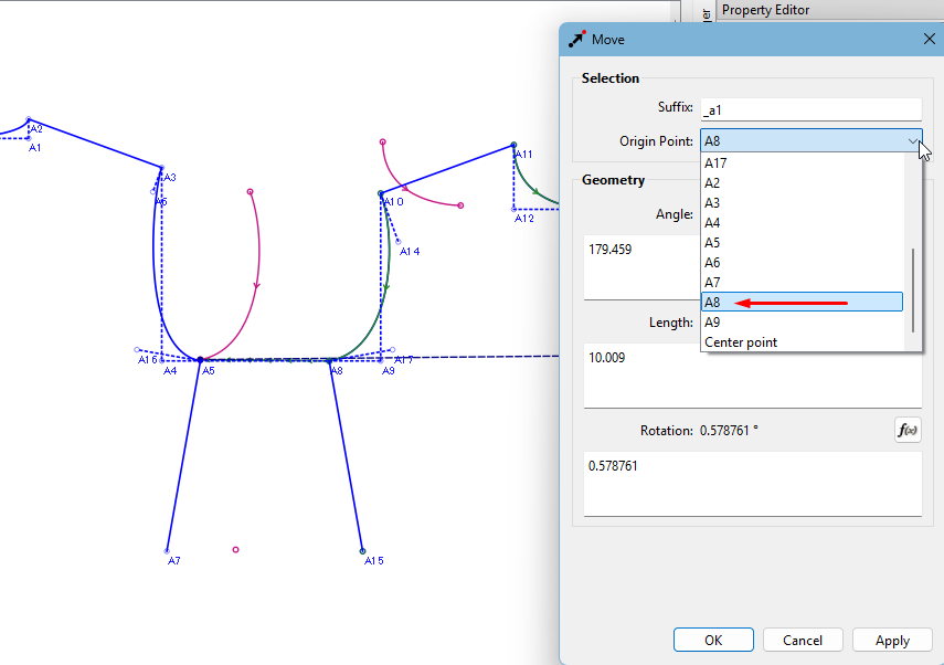

in this post @Grace was just writing about copy and rotate few hours ago:
There is also a Union function in the Piece mode to unite two pieces. But if you use it, do not make any Internal Paths for the Piece before the Union. That leads to sorrow. Using the method which @nejcek74 linked to is better, more stable; using the Union tool is easier, but somewhat prone to breaking your file.
