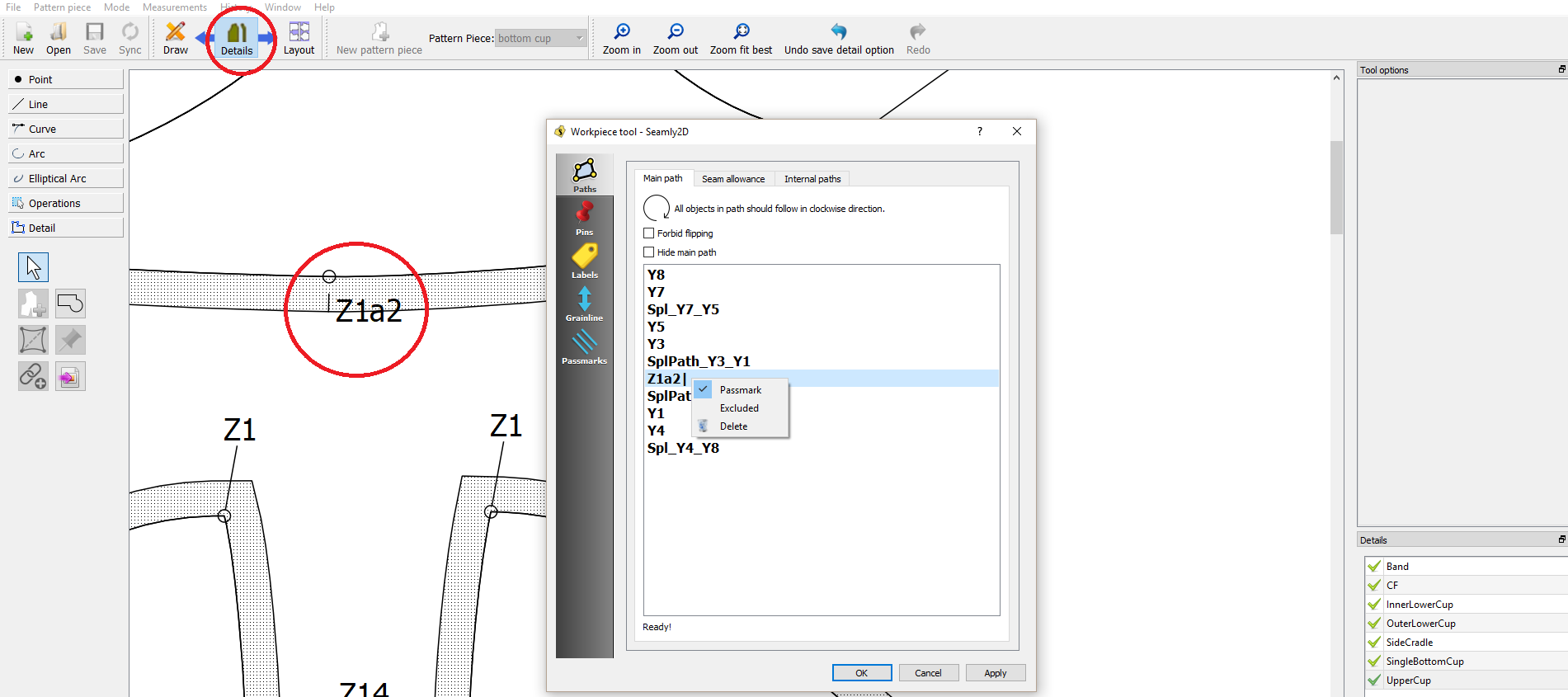

Do you mean notches with des crans de montage? In Seamly2D it’s called passmark. You need to have made a detail for this. On your path you can select the point where you want your notch to be, right click and select passmark. This will only be visible if you have a seam allowance.

1. Create passmark points in Draw mode:
2. Create seam allowances and passmark lines in Detail mode:

I try, but unfortunatly the ‘‘Apply’’ buton dont show??? It’s hidden. I upgrade the new version (S2D).
It Works!!! Sorry to disturb and Thanks, I use the Function instead of writing «Spl»… my version is in French, probably that’s why!
