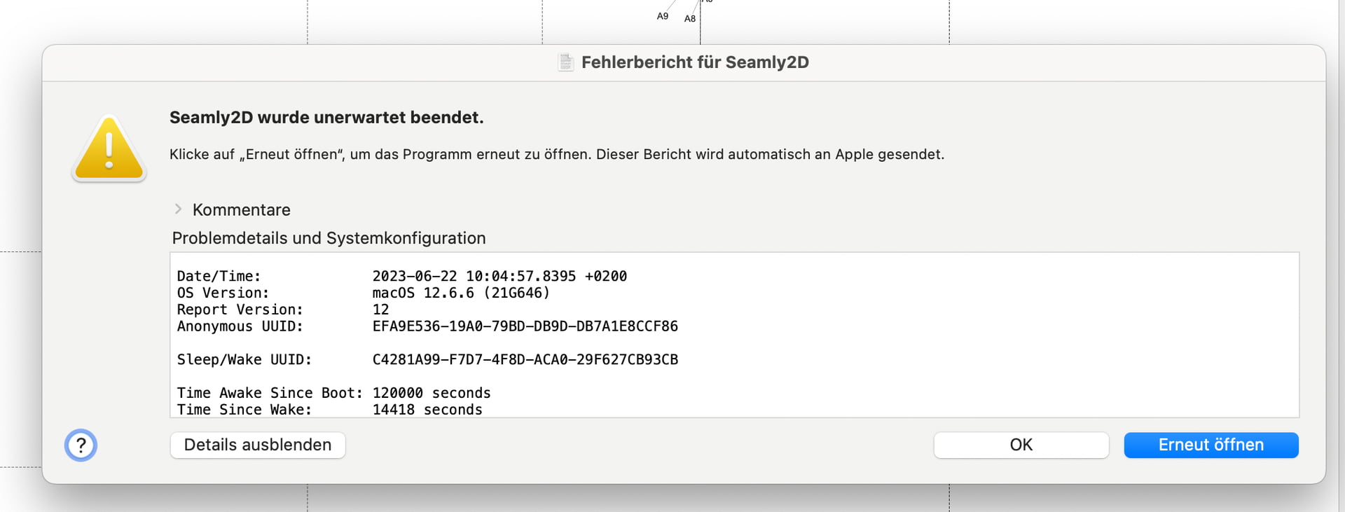

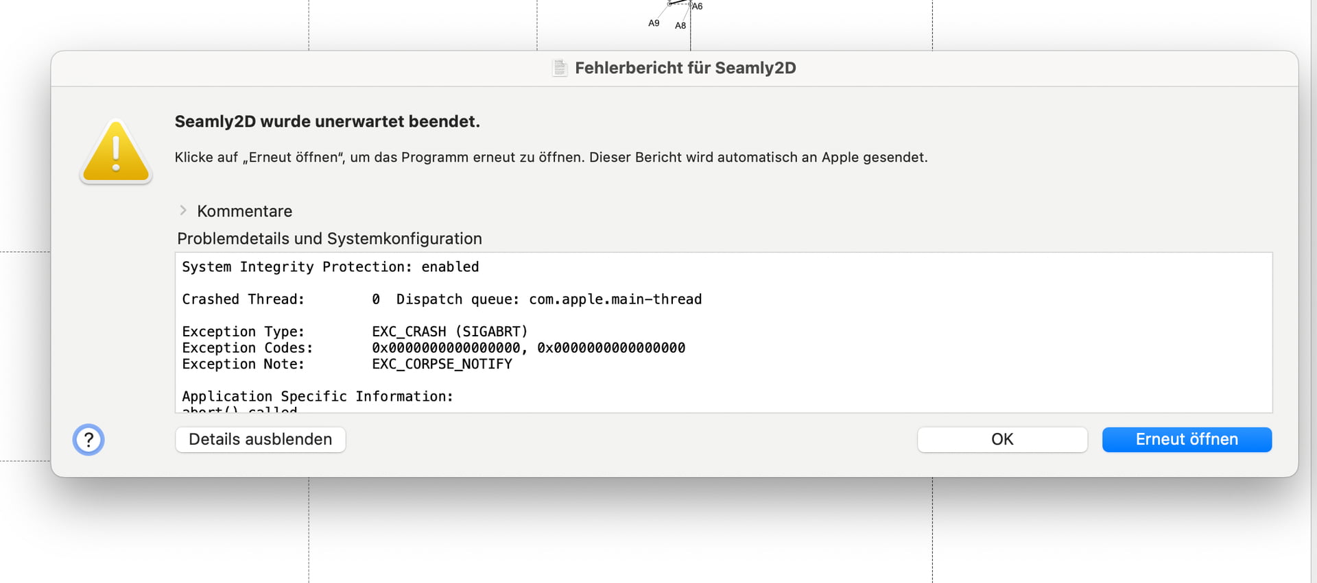

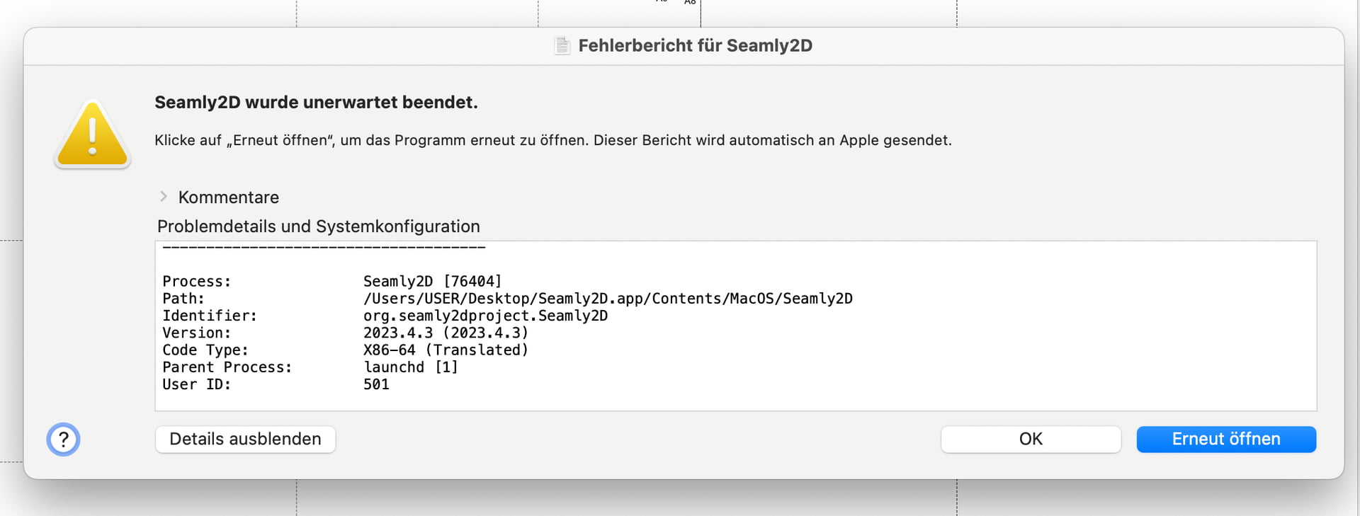

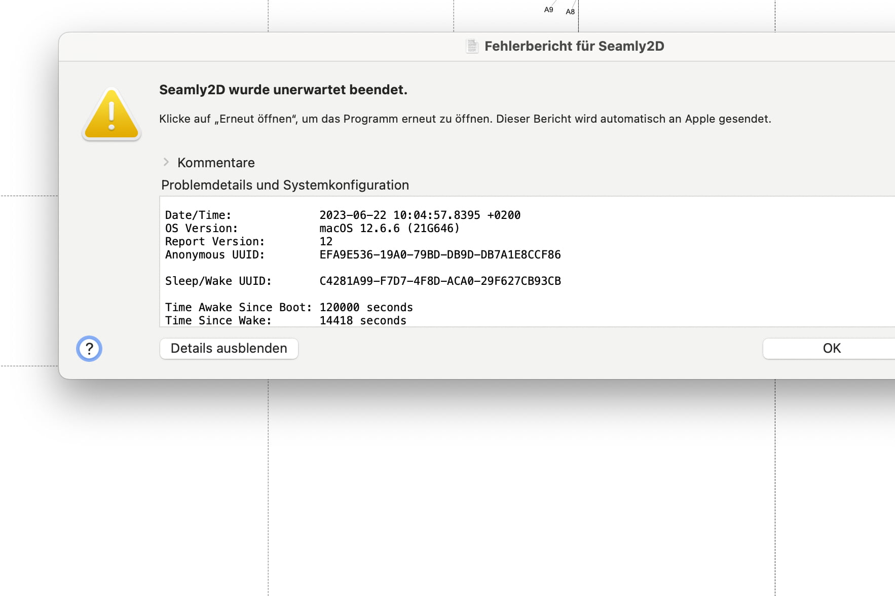

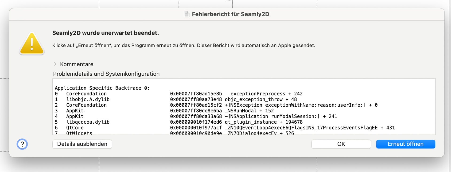

Hello everybody attached i send some screenshots after my last crash a few moments ago
I hope its usefull for my problem
Hello, @H.Naehmann
Thank you very much for the screenshots, I’m sure they will help @Douglas. Can you describe exactly what you were doing at the time of the crash? And also let us know which Mac OS you’re working on, please. @Douglas should be alone in a bit and will see if everything is useful to him.
