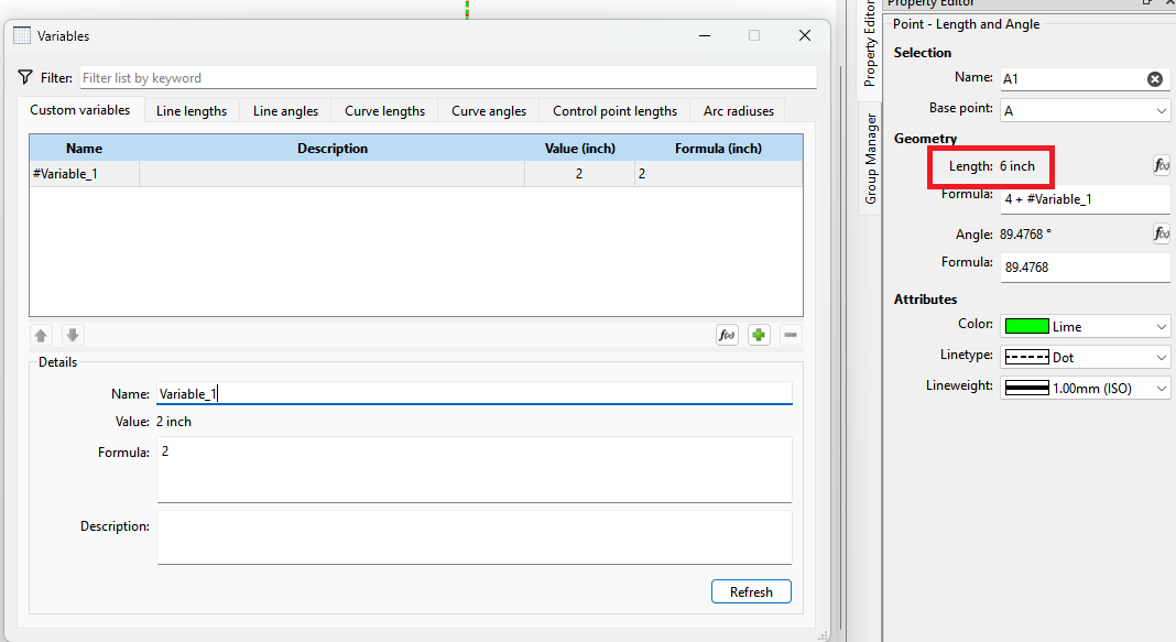

Did you Click the Refresh button?

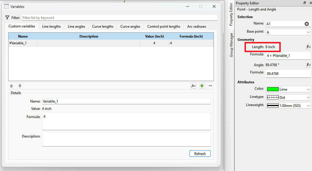

Length is 6
I then edited the variable and clicked Refresh… the Length is now 8
I did a refresh.
