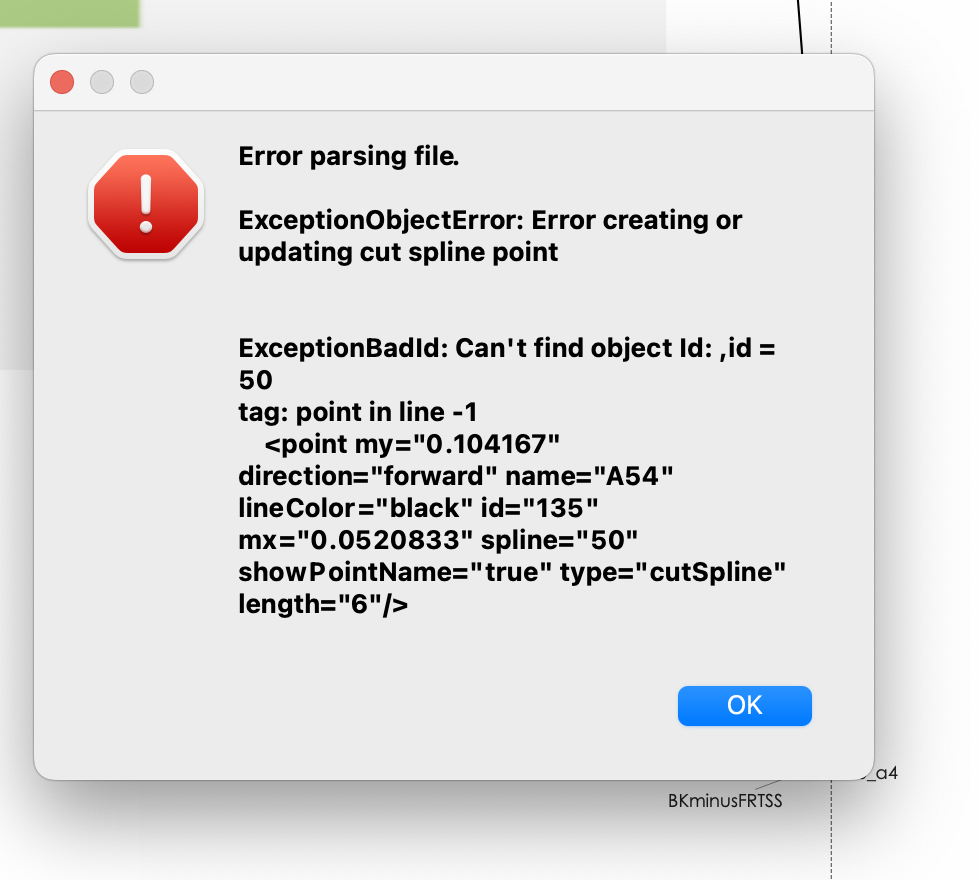

Is there a way to recover from the file crashing when I accidentally select a point that was not created in the right point in history?
crashing regularly now.

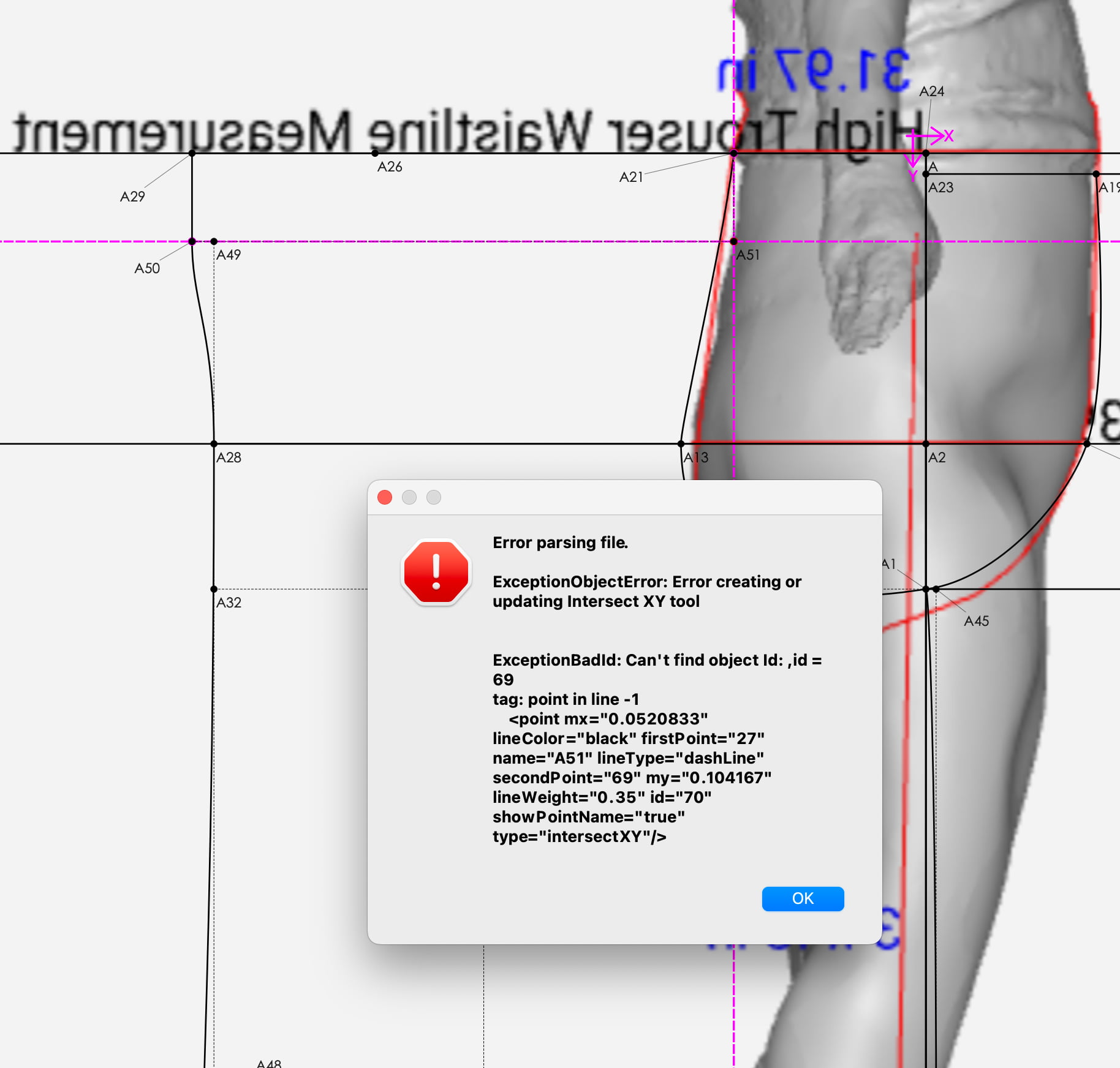

yes. and it doesn’t seem like it’s always a history problem.
for example I just picked A72 and got this error.
when it crashes and i close and reopen it allows me to pick the point.

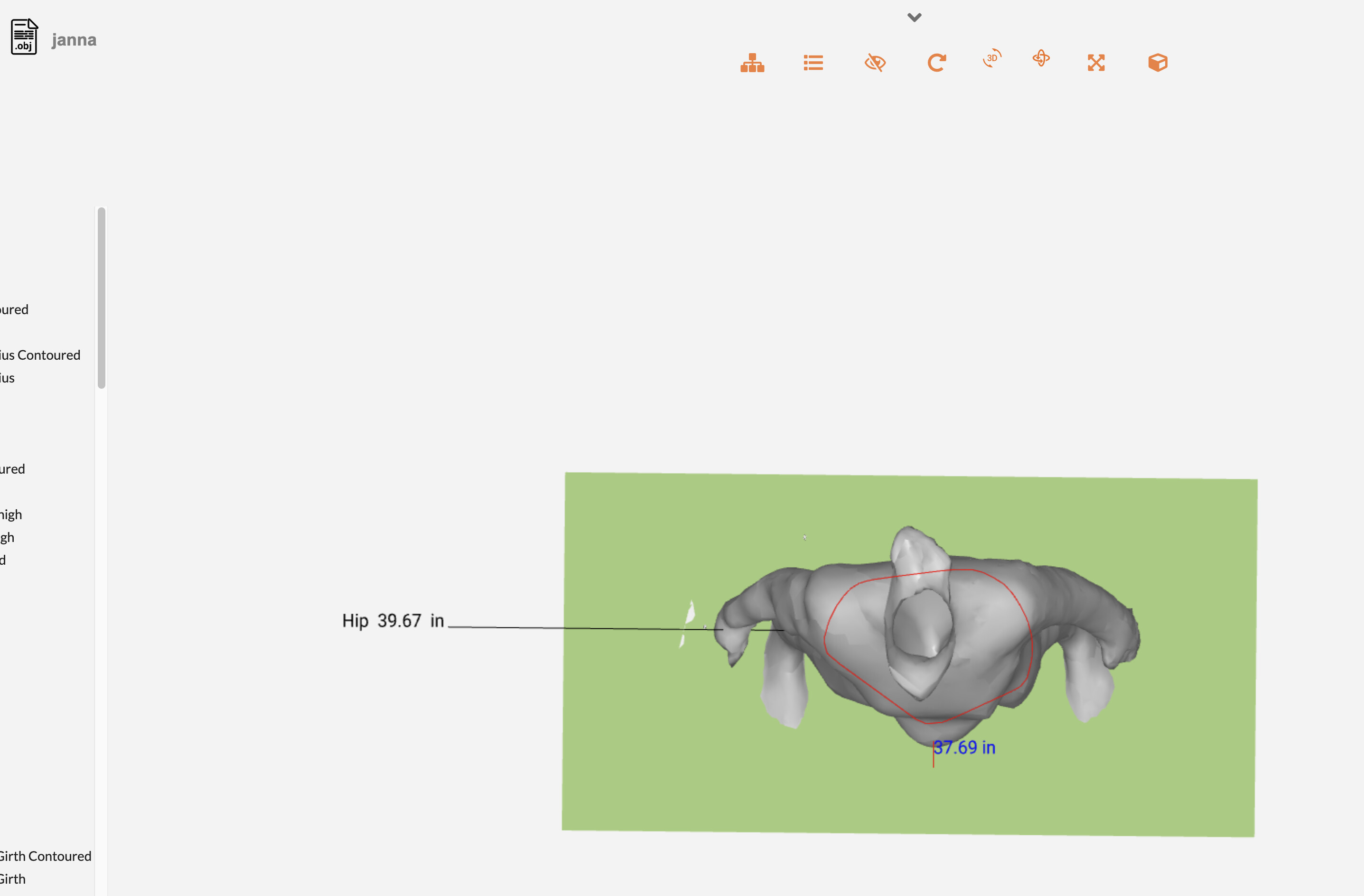

lilimade pants.sm2d (36.9 KB)
janna.smis (986 Bytes)
@emily, thanks for posting!
For some reason the 1st & last images above are not displaying, but if you click on them they open and display properly.

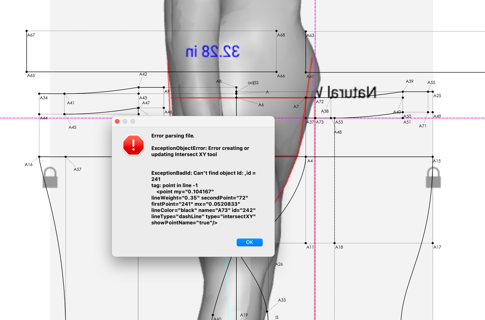

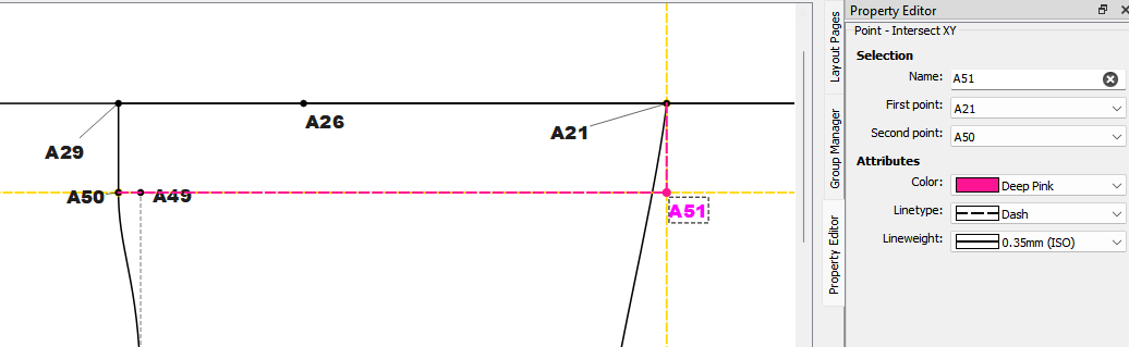

still having this problem. with a new file.
when i pick point A50.
julie.smis (985 Bytes)
julie pants.sm2d (16.7 KB)
It took me a little bit to backtrack through the pattern to realize that point A50 was inserted earlier in the history… but is what you were trying to do?
As I’m not having a problem clicking A50. ??
I should note that I discovered a bug (unrelated?) in regards to not having the image files, where I and just skipped loading them… adding any tool then crashed the app.
if i click on point a50 right after i add it earlier in history it crashes. if i save right after and close it and reopen it allows me to pick a50.
Right. You have to move the pointer back to the end of the History after you insert a tool. It’s why you have to be careful when inserting tools earlier in the History.
Yeah the History tool UX is a bit rough. There are zero instructions. Users discover how to use it properly through by trial-by-error.
