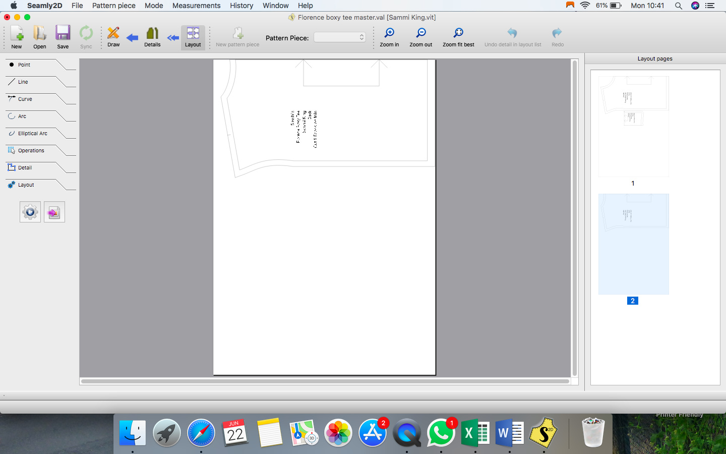

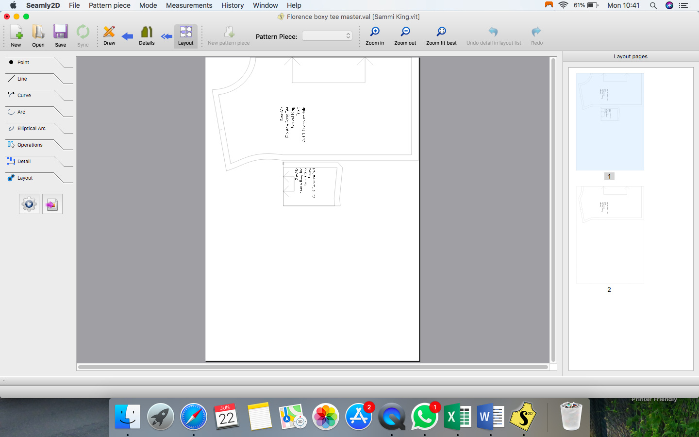

Here’s an example:
It obvious that they would fit on 1 sheet but the layout put’s it onto 2- Basically costing me and extra £3 in printing costs.
Anyone able to help?

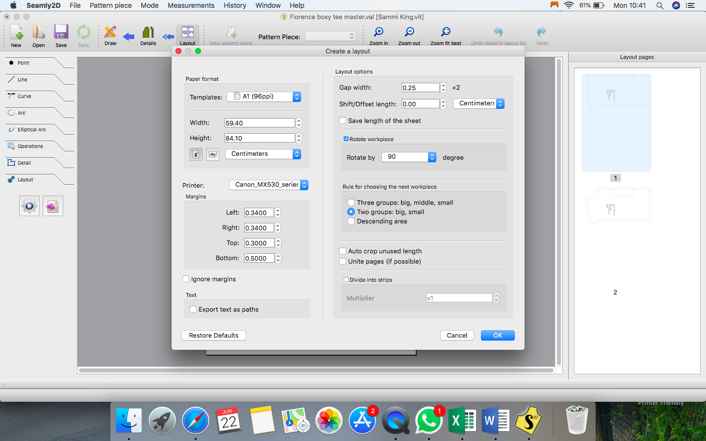

Besides using Inkscape, as @Scholli does, possibly changing (shrinking) the “Gap width” in your “Layout options.” (upper right of the “Create a layout” dialog",) would convince it to behave. Workpiece rotation, just below that, also occasionally makes a difference; sometimes leaves it unaltered.
“Gap width” is the minimum distance between the pieces on the layout. In experimenting with it, it has occasionally had a disproportionately notable effect on the layout.
But, so far, the most reliable way to fit the pieces would be to manually adjust them in Inkscape.

Hi @DonnaKing, I’d make the margins 0 and place a checkmark at the Auto Crop Unused Length. I’d also reduce the Gap Width as @Pneumarian said and remove the Rotate and cycle through the Groups rules to see which works the best.
You can also put a check-mark at Ignore Margins.
