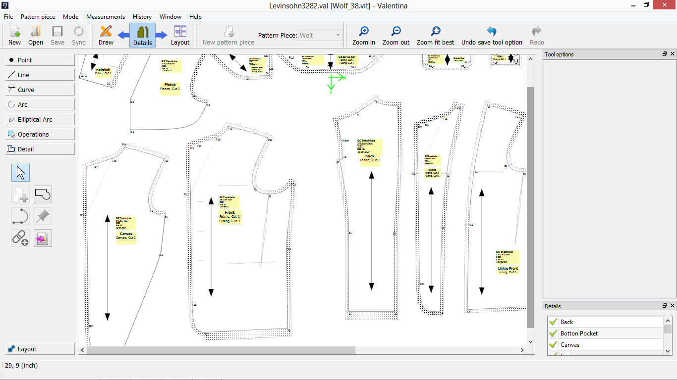

BTW… you may find this interesting, where I took an existing pattern of a mens jacket, drafted the grade points into Seamly, and then using a standard set of grade rules incorporated into the formulas, am able to apply a set of measurements to draft a made to measure pattern. The grade rules being how much a grade point moves in/out and up/dn for each increment in size. The base size was a 38R.

Thanks for the tips and files. I assume that Seamly2D/SeamlyMe can process these Valentina (.vit/.val) files. If not, I do have Valentina installed - I’m a ‘Belt & Braces Man’ :roll_eyes:
