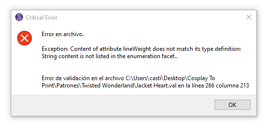

I’m here today to ask for your help, please! Cause I got a “critical Error” on a pattern I draft yesterday and wanted to open today. I searched the forum and I think I could fix it manually but to be honest, I’m not confident in that skill of mine :sweat_smile:
This is the error. I’m thinking maybe I just draft lot of lines…?? I also leave the pattern and the measurment file :slight_smile: I’m using size 34

Your version of the app is a bit old. I suggest updating. I also suggest using the new file extensions *.sm2d, *.smis, and *.smms… which the newer verrsion of the app will default to. That said here’s your pattern fixed.

Thanks a lot Douglad!! Didn’t think about updating my Seamly version but it’s done ;D Gonna make some backups with the new extensions of the files I already have~
