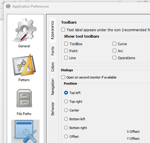

Not sure if there’s a difference on any Linux systems, but there is a Seamly2D setting for what position you want the dialogs to open at, as well as on option to open on a second screen… the default is center, no second screen.
I would think this is an issue on the Linux OS side, as there’s nothing in the Qt code that prevents (modal) dialogs in the app from moving. I would check and see if there is a system setting somewhere locking the dislogs to the parent window. I’m not a Linux user so I can’t offer much help in that regard.
Yeah, I tried the option to open in the top left, (ps: top right as well) nothing happened.
