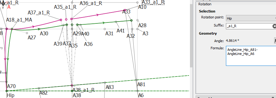

From the image of your pattern, I’m guessing that this is what you want to do.
I used the hip line as the slash point and rotated all the points from the right waist around to the left hip up to open a wedge on the crotch side.
To do this, place a node (A81) above the hip line the distance that you need to open the wedge and draw lines from the Hip node to the new notch and make sure that the line goes from the Hip node to the original node (A6).
Next, pick up the Rotate tool and select all the objects, including the dart nodes and curves but not the Hip node, and hit Enter. Now select the Hip node as your rotation point. In the angle formula, enter the AngleLine_Hip_A81-AngleLine_Hip_A6 and hit OK, and your rotation is complete:
Now you’ll need to draw in the lines using the Line Between 2 Points tool:
And you’re done!
P.S. This is called the “Slash and Spread” method when working with paper and scissors, where you cut the Hip line from the crotch side to almost at the Hip and then spread the upper part to open the back seam. It’s also used to rotate darts, etc.

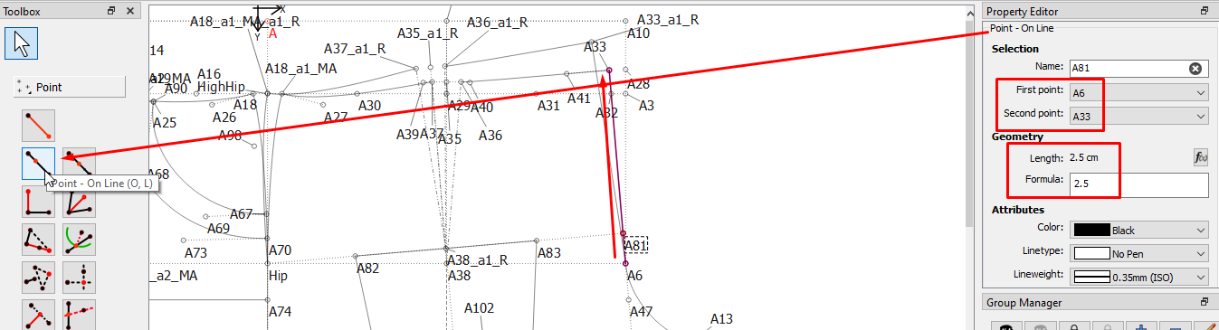

yes one more than i leave you alone, I can’t add a node, i tried to select it but it doesnt work
Sorry I’m only seeing this now…
Pick up the Point - On Line tool, select the 1st point (on Hip line) and the 2nd point (at waist side), hit Enter & then enter the length from the Hip line to where you want to place the point:
I assume that you are here:
& are trying to select the Insert Nodes tool in the Piece toolbox. As you can see from Grace’s reply, “Point” might have been a better term instead of “Node”. The Insert Nodes tool is for if you missed something / added a point/curve at the tracing stage of the pattern after tracing it off, so that you don’t have to trace off the entire path again.
