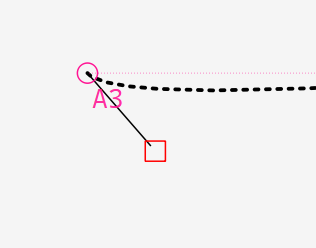

Curve handle overlaps with point name, causing accidental selection

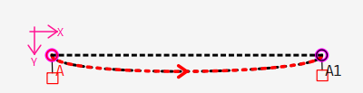

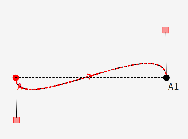

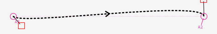

Hello, Every time I start a curve, one of the curve handles/control points always overlaps with the point name. (I usually use defalt point names.) When I try to adjust the curve, Seamly always moves the point name instead of the curve handle. This happens even on very simple shapes, not just busy drafts. It would be nice if the default curve handle were longer.

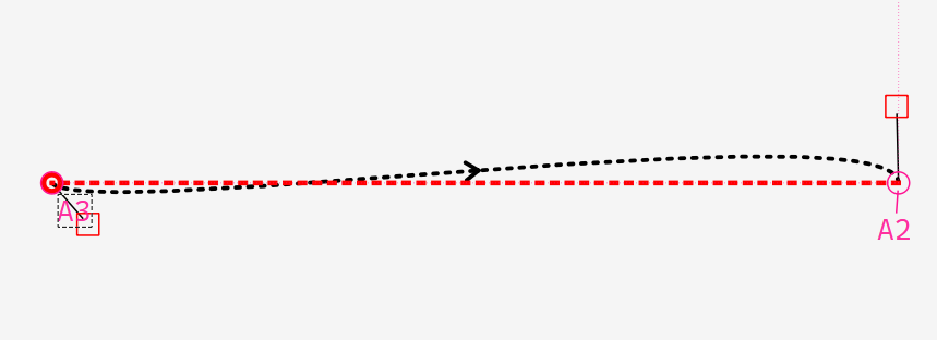

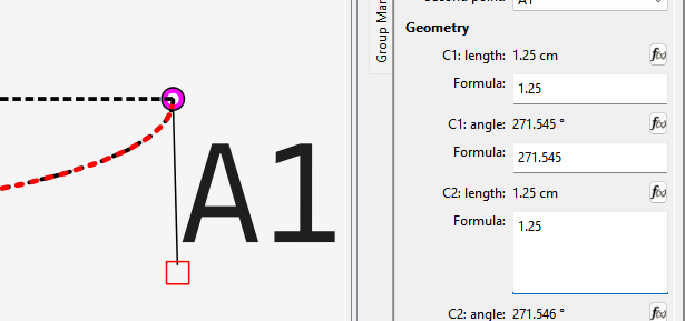

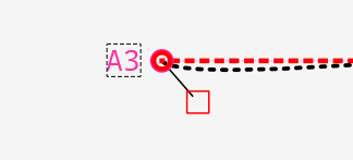

You can resize the point names in effect making the control handles larger:
You can move the point names:
When the name goes beyond a certain point a leader line is drawn:
You can also zoom in more to separate the name from the control handle:

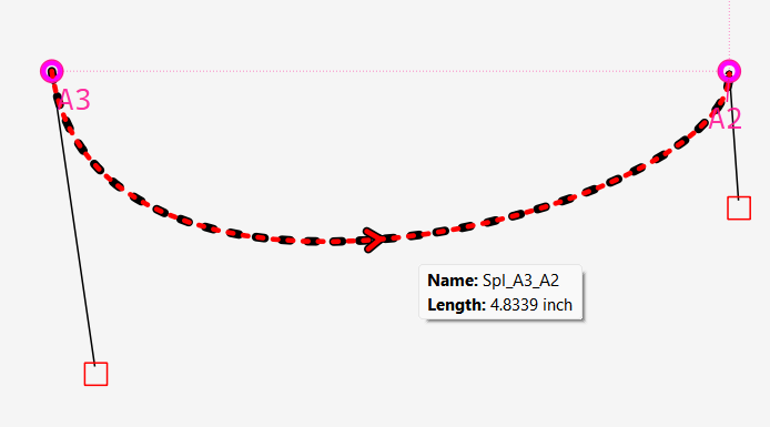

You can also grab the curve itself and drag it… the control handles will adjust:

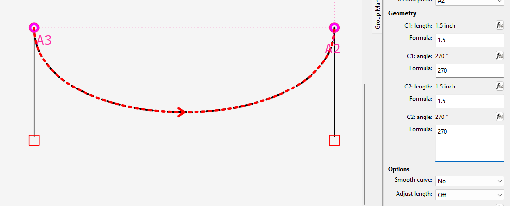

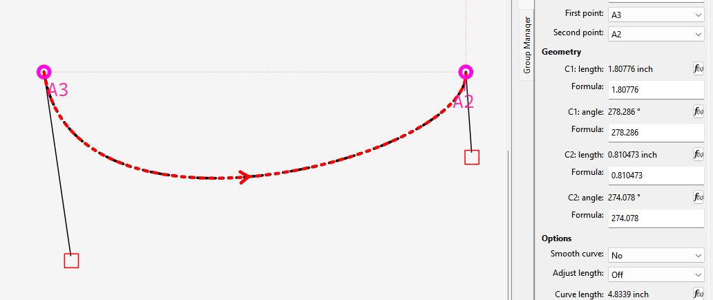

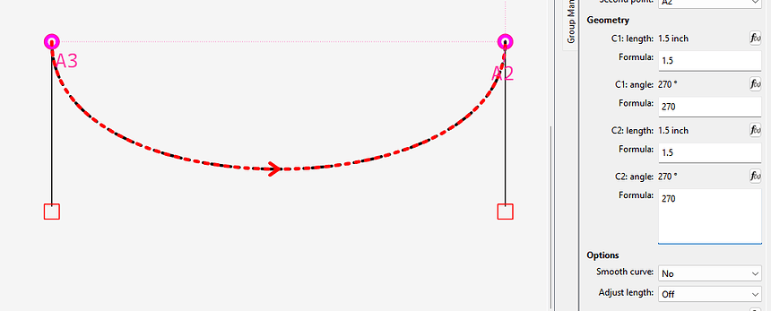

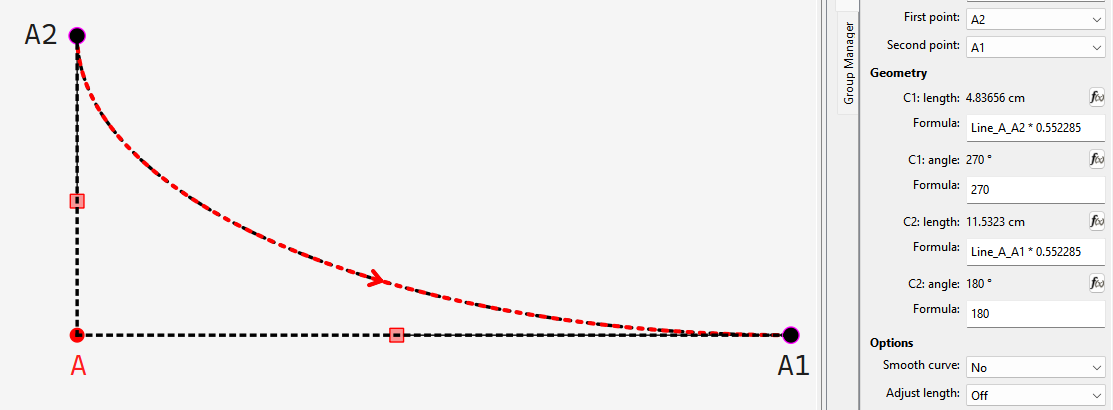

That said… you really shouuld be editing the control handle formulas anyways…
If you don’t formulize the control handles the pattern will not resize with a change in measuremets.

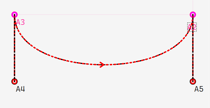

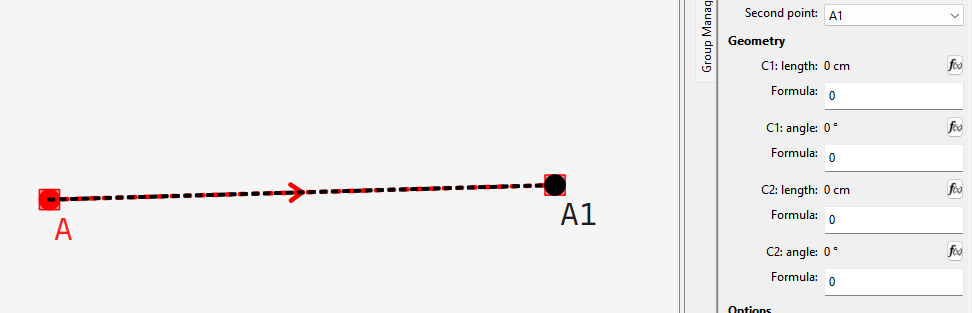

Another option is to just use the fixed curve or spline where there are no control handles:
And last… Can I assume you mean larger’? … making the control handle ‘longer’ changes the shape of the curve. The fact you can resize the point name makes making the control handles larger a moot point.
Do we really want control handles larger than a 96pt font?

I do mean longer. Since the default curve has to be adjusted anyway after selecting two points, I thought the initial curve could be curvier with longer handles, rather than the current shallow curve.
I hadn’t considered that people might be using tiny or giant fonts.
Maybe because I work with a trackpad, grabbing and dragging the curve to distort it feels a bit cumbersome. I’ve developed a habit of doing this every time I draw a new curve before adjusting the handles. But if it’s just me and no one else is bothered by it, I can live with it.

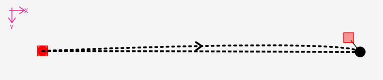

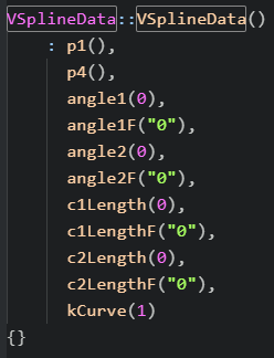

Ok. That’s possible. I wasn’t around when the code was first written so I’ll have to decipher exactly where the control handles are created and with what default length (s) and angle(s).

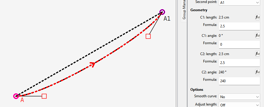

This is how this curve in my previous reply was created…and the lengths & angles do seem rather arbritary.

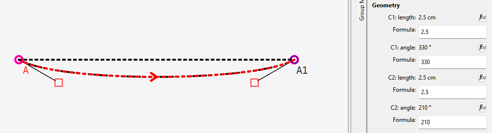

I think what would work is setting the default length to 2.5cm (or what ever that is in pixels) and each handle 30 degs off of the line between the 2 points.

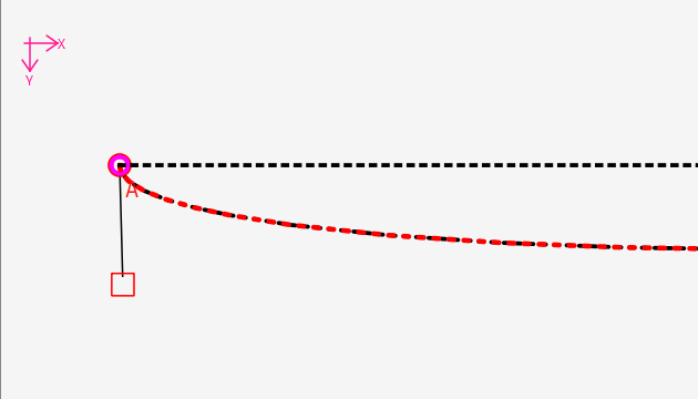

Aha… found where the default lemgth and angles are:
That will be wonderful!
